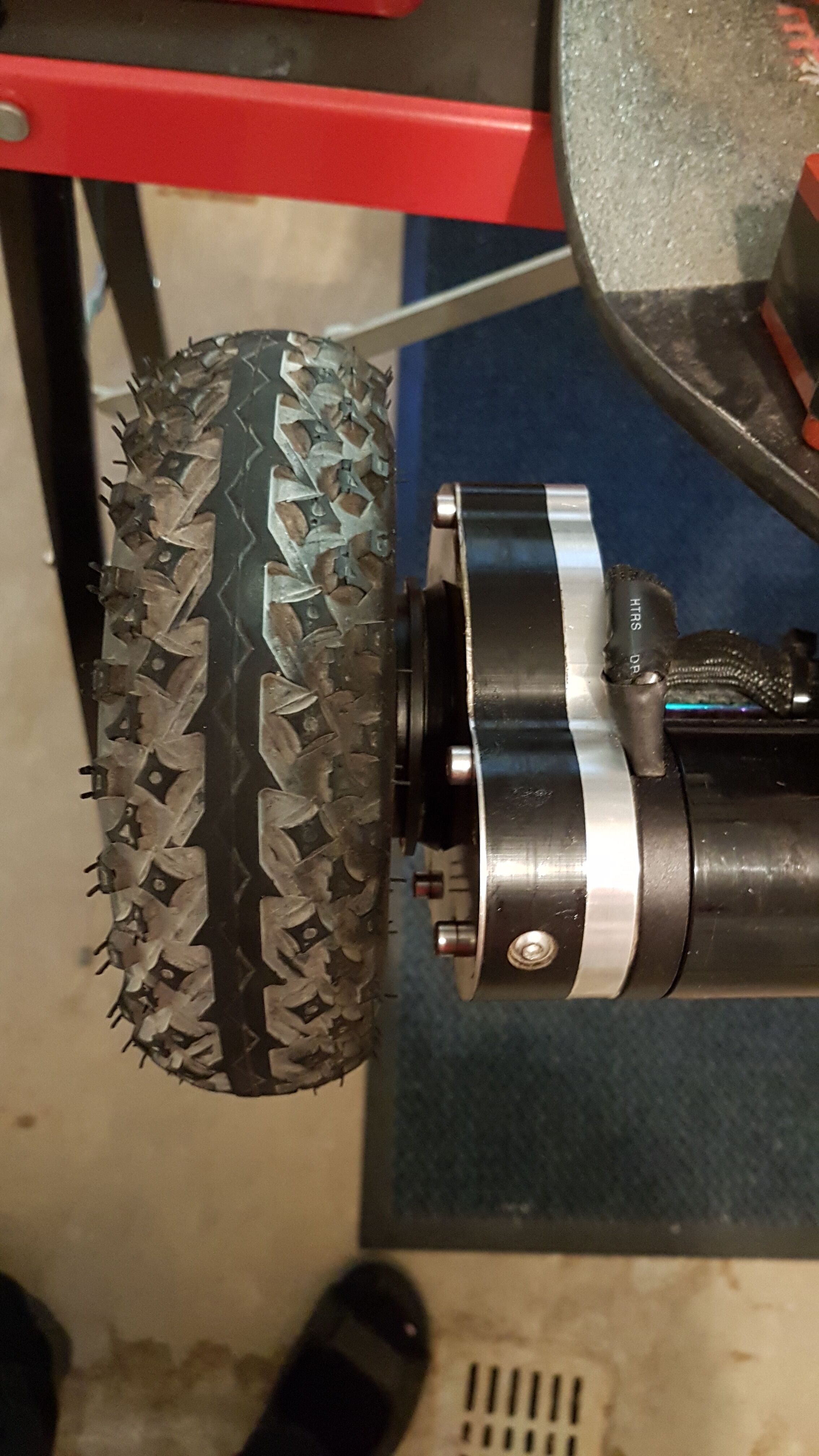

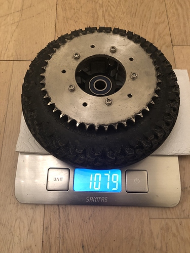

Did you drill those holes yourself? If so how did you get it centered?
The sprockets came like that. I do not have the right tools to get those holes drilled centered, but if you have a drill press it shouldn’t be too hard.

Askew axle. I hate it.
