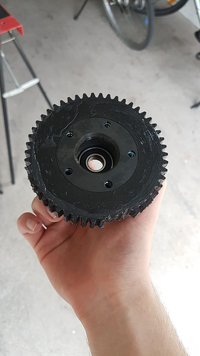

@glyphiks I joined the broken gear club. :partying_face:
This seems to be happening a lot. How did it break?
Caused by the ollie, I think. Backlash was not the cause. I accidently braked in the air and landed. :neutral_face:
That caused the broken wheel teeth.
I suspect that mine could have been similar, but I think I accelerated in the air :joy:
100 bucks down the drain :joy:
That shouldn’t cause it to break.

Up and running again. :wink:
