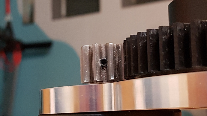

Issue found.
This little fucker of a setscrew is a tad to long as fully engaged and then there is no backlash on that point. :rofl:
Try using a grommet on the valve stem to protect against wear?
Took a key file for it. Now it runs SMOOTH. :partying_face:
