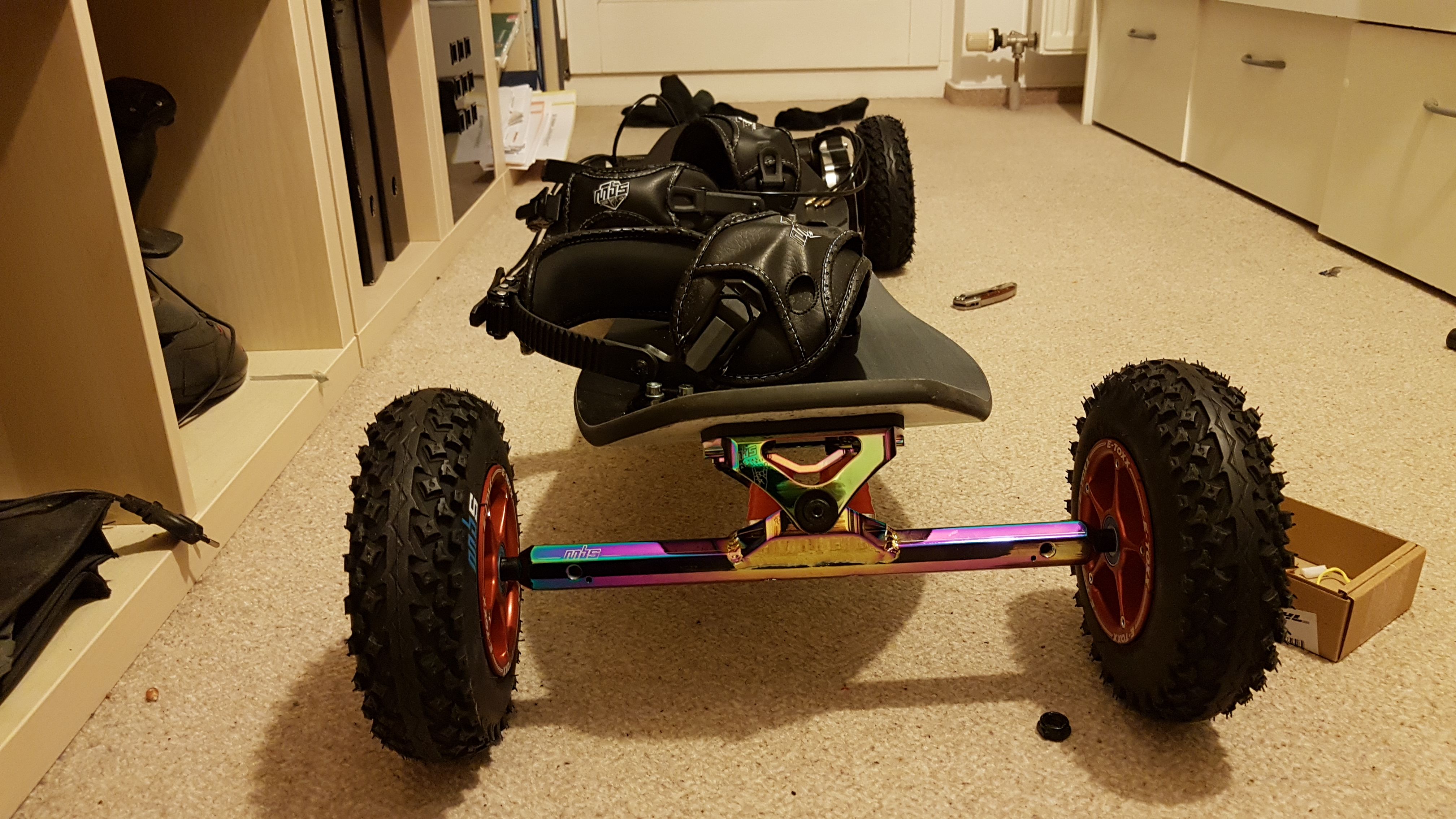

Totally new. the rubber is already crumbly at the transition.
Oh no! Did it happen after a ride or they came that way?
I am missing a vesc and battery. :joy:
I assembled my wheels and pumped it up to 1 bar and one of these fuckers went pff.
the other tubes were fine
Either old as shit, not properly stored, or poorly manufactured. Maybe all three! Where’d you get them?
From Phil at @Haeroboards. He’s a cool dude, don’t rude him for that.
We’ll chaulk it up to bad luck :wink:
Most part is done. Onewheel(:crazy_face:) is left, cuz you know the problem.
Your front tires are reversed to your rear tires. Well tire in this case.
Fixed already. :slightly_smiling_face:
