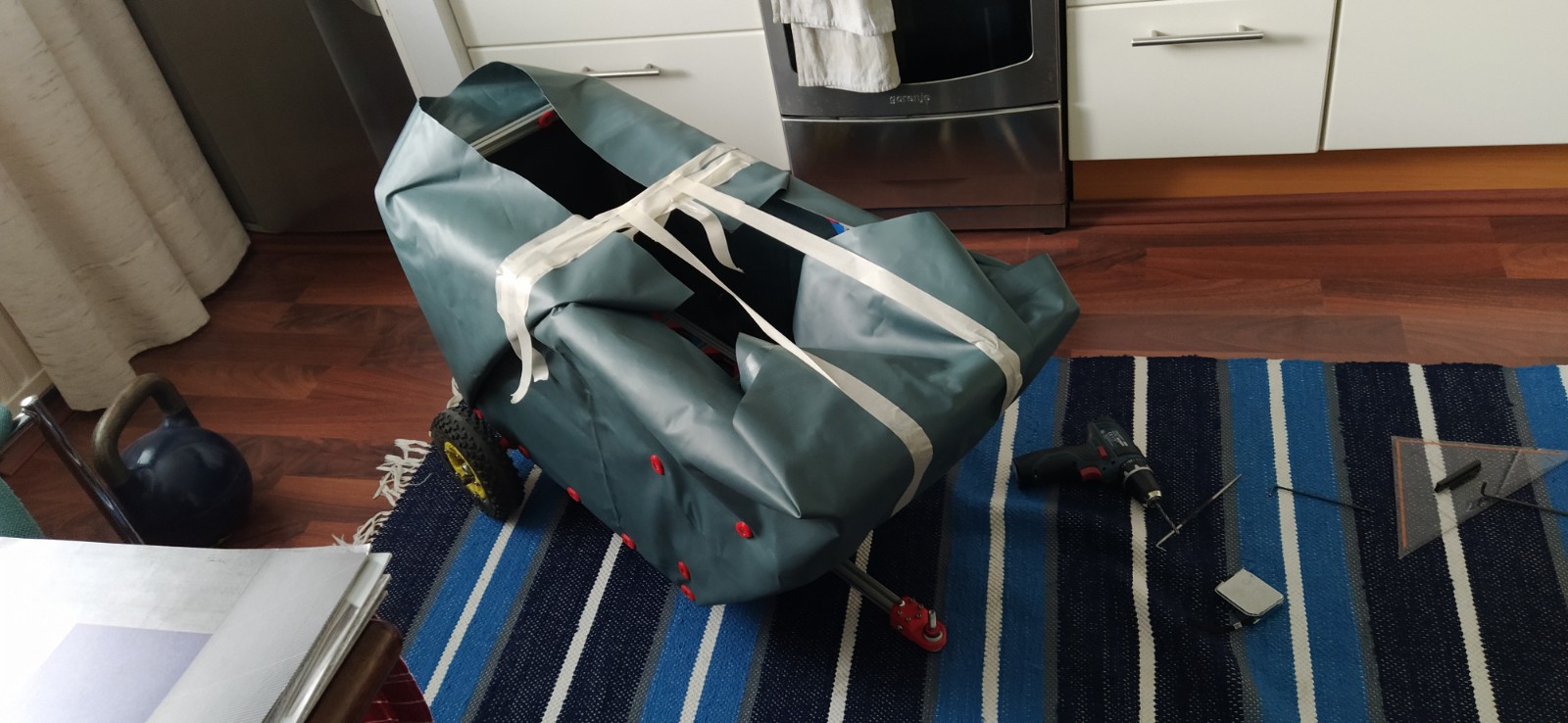

Been wrestling with the bottom tarp piece for the past couple days, but finally have it nailed down.
Beginning of the folding puzzle. The tarp will not be cut anywhere, but done in one piece and folded to sit as flush as possible against the frame.
My method for making the holes accurately through the tarp was to use a scribing tool, that you use to make lines/scratches/markings on metal surfaces, to punch the initial hole after locating the nut in the profile slot underneath it. After I had put the tool through the hole to widen it a little bit, I used a 5mm metal drill bit in reverse to widen the hole enough that the M5 bolt could make it through it with relative easy.
From there it was pretty linear, starting at the bottom and then working mine way upwards the sides toward the top.
Now to figure out how to fold all the excess flabby bits at the top and corners.
But I think it came out pretty well.

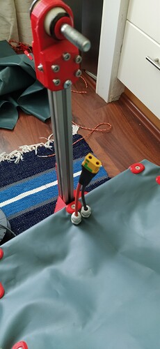

Trailer side external discharge cable. I’ll run the wires through the tarp near the front side bottom area with the shown cable glands. They have a rubber gasket, so they should provide a waterproof passthrough, as long as I don’t mess up cutting the holes for the glands into the tarp.
I can then just connect and disconnect the trailer from the esk8 electronics as I want and the anti-spark in the connector itself eliminates and in-rush current sparking.
