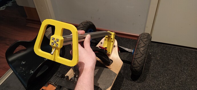

Okay, so. Sit-down test setup
Even made this little grip for the end of the front bar.
Result. Speed wobbles already at around 10km/h speed, albeit low frequency, but very pronounced in amplitude for the given speed. I think I rode about 100 meters in total and just concluded that this won’t work with this setup and will not be the solution for the ride comfort. The wobble only stopped after giving a very distinct body lean input to left or right, which then overpowers the straight line instability, but it was pretty impressive how easily it started.
I believe to “fix it”, it would be to lock the back truck in place, so it doesn’t provide any turning input and have all the steering done through the front, as couple people mentioned above. But with the Trampa trucks, locking the rear truck and having only the front one to steer with + not being able to get more weight on the front compared to standing. Would result in a very limited steering, so therefore I don’t think with the current trucks, this sitting setup is not feasible. Would have to almost be a some kind of rack and pinion setup with a steering wheel and the wheels would turn and not the whole truck itself. Essentially a car/gokart-like steering setup.

Just dewedge the rear to zero or move your seat forward. Seat so far back is your main problem. Having built street luges back in the day I know the pain of bad weight distribution.
Or dewedge and use a motorcycle steering damper, those still allow movement, but adjustable damping at max makes for a rock solid ride.
What you could do for a sit down setup is to use the extra bar to add a footstop far ahead of the board, and have the seat as close to the front truck as possible, just like a street luge. That way you remain stable due to the weight distribution on the front truck rather than the back, and turning doesn’t get impacted that much. Might need some guards so you don’t hit the wheels though.
:arrow_double_up::point_up: This
Yeah I say do this and then try and get the absolute softest bushings you can buy
The initial position with the feet so close to the wheels would have been sketchy. Move a foot 5cm on a bump and you’re toast. Seat in the middle of the board, where a battery box would be, and have a footstop protruding 30-40cm at the front would be better. Your knees would be then pretty much over the front axle. Also makes it easier to switch from seated to standing position. Not sure if this helps enough to reduce wobbles though.
