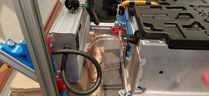

Well the module seems to stick pretty well now.
There’s a couple sheets of cardboard between the bottom of the battery module and the frame to provide some cushion/damping against vibration.
Stays on, or doesn’t fall off at least.
I’ll add a one or two more cross bars for extra support when I got more AL.profile
There’s a little bit of extra/unused space between charger and battery module, but I’m not planning on stuffing anything there. I think I’ll just leave a little bit of breathing room there, as the charger does heat up quite an amount when going full blast for hours, so I don’t want it to touch the pack.

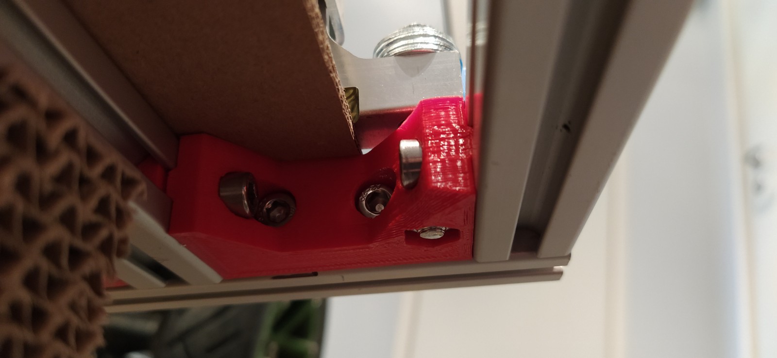

are those 3D printed brackets going to hold the entire weight of the battery bouncing on crappy pothole filled pavement and/or off road?
I would do a test with sandbags as weights and see what happens. Doesnt have suspension to soften the blows either
That’s why I added some cardboard between the trailer frame and the battery frame to act as a shock absorber. Also it’s gonna be on pneumatic tires and they do act as a light suspension with the air inside them.
I’m gonna add a couple more cross braces under the battery, so it’s weight is better distributed over multiple brackets, but these brackets can be surprisingly sturdy, especially as they are bolted to the AL.profile and they are not long, so there isn’t any long moment arms really anywhere, which would break the printed brackets.

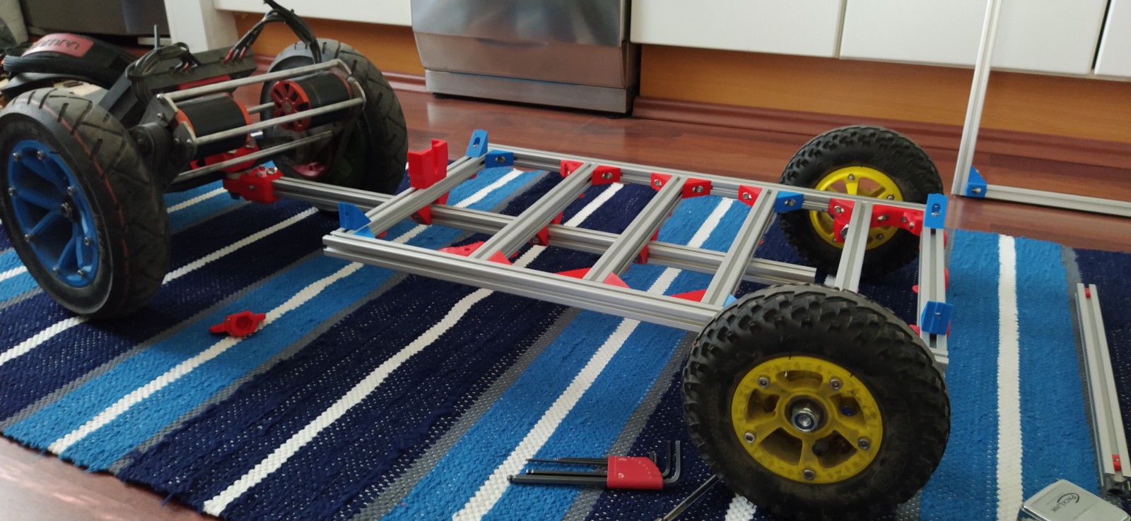

Rebuilding the frame and slotting all the needed nuts into the AL.profile. Printer is gonna be running continuously for a while. The length of the tow bar is gonna be adjustable, but I think ideally it should be as short as possible, while still not letting anything rub between the trailer and the esk8.
The added downwards pulling weight at the tow hitch is pretty reasonable even with the battery pack and charger attached. I’d say it’s around ~10kg of added weight.
I’ll try switching the rims on the trailer wheels back to Trampa Superstars, as the current ones have the added -15mm offset and I don’t think I’ll be needing quite that much offset to clear the tarp on the trailer. The trailer is about 53cm wide at the wheels and the esk8 is 44cm atm, so I wouldn’t mind if the trailer was a bit narrower.

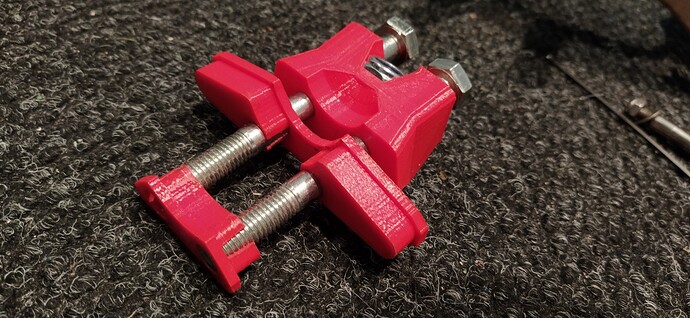

Here a couple more close-ups of the trailer hitch itself and how it’s put together.
Here’s the part that bolts onto the hanger of the truck.

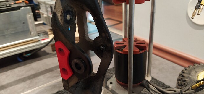

It turns out that there are slight differences between old and new trampa trucks, specifically in the hanger itself. Brown is the old version, red is the new version with the end of the hangers being machined square on the new version.
The newer hanger has a slightly different hole size and shape. It took a couple hours to slightly tweak the hole-adapter design.
