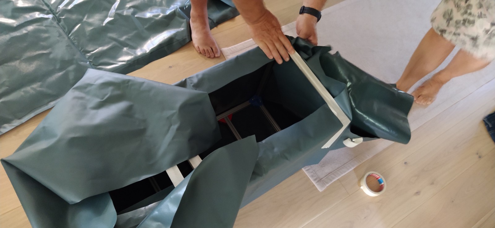

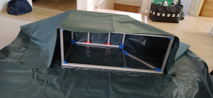

After thinking of how to make the outer paneling/covering and out of what material, I’ll be making the covers for it out of thick, rubbery tarp.

Close up of the tarp.
Figuring out how to exactly make all the bends. The tarp will be done in 2 parts. One for the bottom and a removable part for the top, so you can open up the top to access the inside space. The top half will be attached with easy release latches, so it can easily be closed and opened.
The bottom part will be attached to the frame with these simple “squeeze” blocks that are easy to use as aluminium profile provides a convenient place to have a nut & bolt attachment

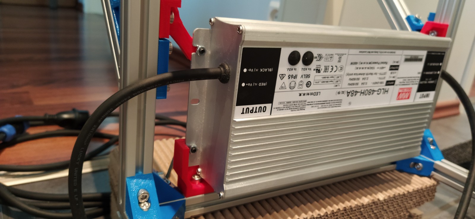

I’ll also bolt the charger to the frame in front of the battery and just providing a simple 3-pin connector to the outside of the trailer, that I’ll have a mains cable for, so I can just plug it into a wall socket, or into a J1772 adapter on an EV station.

Charger mounted up to the frame and a close-up of the charging cable solution. The connector is a SP21-serie from WEIPU. There is a waterproof cap available for the connectors, which I am planning to buy for the trailer side end, so it doesn’t get filled with water and dust when not plugged in, but unfortunately the protective caps were out-of-stock.
Note that the wiring on the charger side isn’t finished yet.
