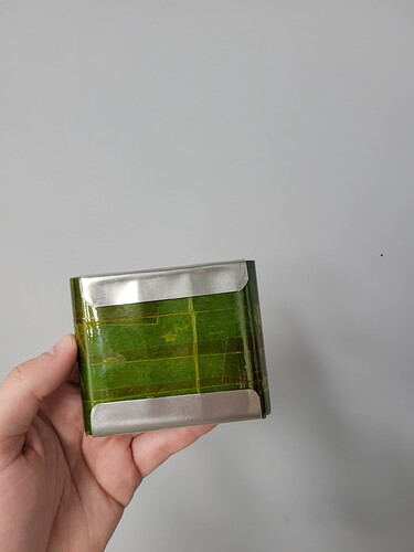

what do you think?
I know they are not the cleanest, but they were pretty clean in the begging before I went overly cautious and added like 1000 more welds
The welds, both in their numbers, and inconsistency of temperature, are a bit concerning.
Also their spread. Looks like they’ve hit cell shoulders, the centers, and in some cases are either cold or nearly blowing through.

Yeah don’t do that. AVOID THE CENTER OF THE NEGATIVE TERMINAL. There’s an internal cell connection that can break.
You only need 3 sets of welds (6 dots) as each dot conducts ~5 amps cont.

try to avoid the dead center (3mm diameter circle) on the negative side of the cells when welding
also you dont need that many welds. I do about 4 per cell. You rather have a smaller number of strong welds than a really large number of weak ones.

I put a lot because I thought would be better, but now I know less can be more. The reason the welds are inconsistent is because I raised the power level for the last few weld to make them stronger, or so I think.
Is this cell groups still safe to use or should redo it (I really hope I don’t have to redo it)
you dont need to redo it,
just try to follow our advice for the next p groups
