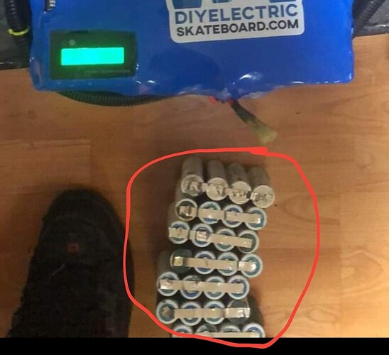

Finally Made my first battery pack with NESE. I only have to set up my main battery leads :ok_hand:
Congrats on finishing. I would very highly suggest adding the NESE rubber screw caps or kapton tape over every screw head on your pack. Every one of them is live, and if you drop a screwdriver wrong it’s easy to short two.
Thanks! I want to buy some heatshrink, but for now you’re right! I will put on some kapton tape

Nice job separating and not crossing balance wires :+1:

Good work, may I suggest that you do something about the series connection between groups 5 and 6 sitting on top of the balance wires though?
Over time and many vibrations, especially if the pack is in a tight enclosure, there is a possibility you could damage those 2 balance wires

run the pack through a few cycles and see if it normalizes. Usually it does. If the delta gets bigger check the p-group for dead cells. Also you can set the BMS to always balancing, that will quicken the process.
Yea, I haven’t discharged it yet but static balancing nearly 2 days
Were the groups balanced when you built the pack?
Yessir
That’s really odd. I would do what @Linesflag has suggested and cycle the pack a few times, OR charge that group individually
Also double-tripe-check your balance connections. It’s possible one is a bit loose or something, and it can confuse the BMS. Maybe unplug and re-plug the BMS connector.
You’re right about the serie lead crossing over my balance wires…
So maybe you are still right about fixing that?
Yeah i’m still right about that, but i said something else that was stupid :sweat_smile: so i edited it out
