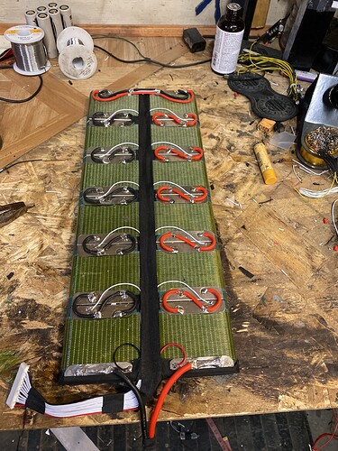

This was kind of an experiment… turned out to be a pain in the ass but at the same time it was challenging and fun. Definitely not the prettiest soldering I have done, but it was really hard to get those conductors right. I get bored easily so sometimes you just have to freeball. I still wasn’t happy with it but sometimes you just have to walk away. :joy::joy:
This looks fuckin great
If you weren’t already using them, the tiny 2” red spring clamps could assist in holding the wires in place while soldering that pattern. Thin enough to slip under the nickel & not damage the wire insulation

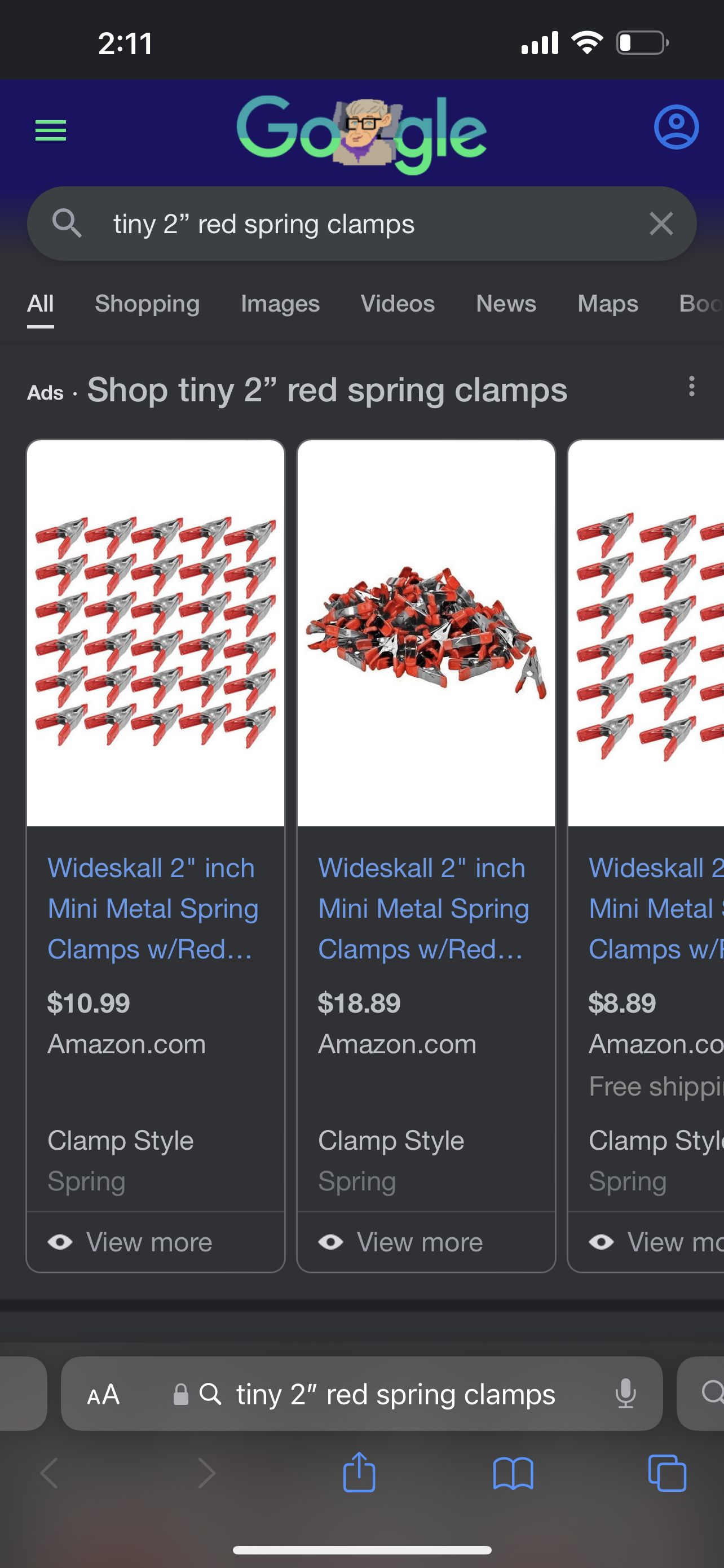

Got a link by chance?
Whenever I post unsolicited advice I try to make it as accessible as possible :wink:
I think I was able to find an Amazon bundle that was $3.5-$4 shipped for ~8 a year or so ago which was all I really needed so I took it, but those types of offers go up and down pretty quickly per seller so the link is dead. More is usually better, especially if you’re building batteries on the reg… but fuck I didn’t want 30 clips fuckin around my tiny space haha

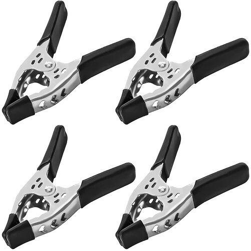

I also like to have these Black 6” spring clamps around for esk8…
4 of them is a good amount IMO, there’s 2 for $6ish if you search term black 6 inch spring clamp on Amazon. They also come with red rubber, or also fully black metal… and the 2” spring clamps also come with black rubber if you like to indulge in color coordination… :stuck_out_tongue:
Can you solder next to them? I use forceps that don’t take on any solder. But they are a pain some times.
Pretty much. For your S wires, they definitely don’t need to be touching bare wire at all. Keep them on the silicone insulation & it’s more than enough force to keep everything jigged to solder, especially if things are properly tinned. Can even jig with the clamps on the insulation & then forcep the actual joint if you’re a megaderp
Maybe l am a megaderp, but those s bends were tricky as hell to solder. They never quite laid like you wanted them to.
Yuh, I’m saying lay the bends in their entirety with the spring clamps. Then go joint to joint with the forceps.
Sorry if unclear, I’m bad at explaining soldering to people anymore.
I really like the aesthetic of the S bends.
@Battery_Mooch are they actually beneficial in any meaningful way for esk8 power consumption tho?
No …if I understand your question
In theory, the S-bends add resistance (where the two longer leads are used) and having only two connections per tab concentrates the current more than having three connections spaced across the tab. That increases the resistance and heating of the connections. Only by a tiny bit, but not zero.
I don’t think there is any practical difference to worry about as long as the two connections (per tab) are done well. Makes for a great looking pack too. :slightly_smiling_face:
