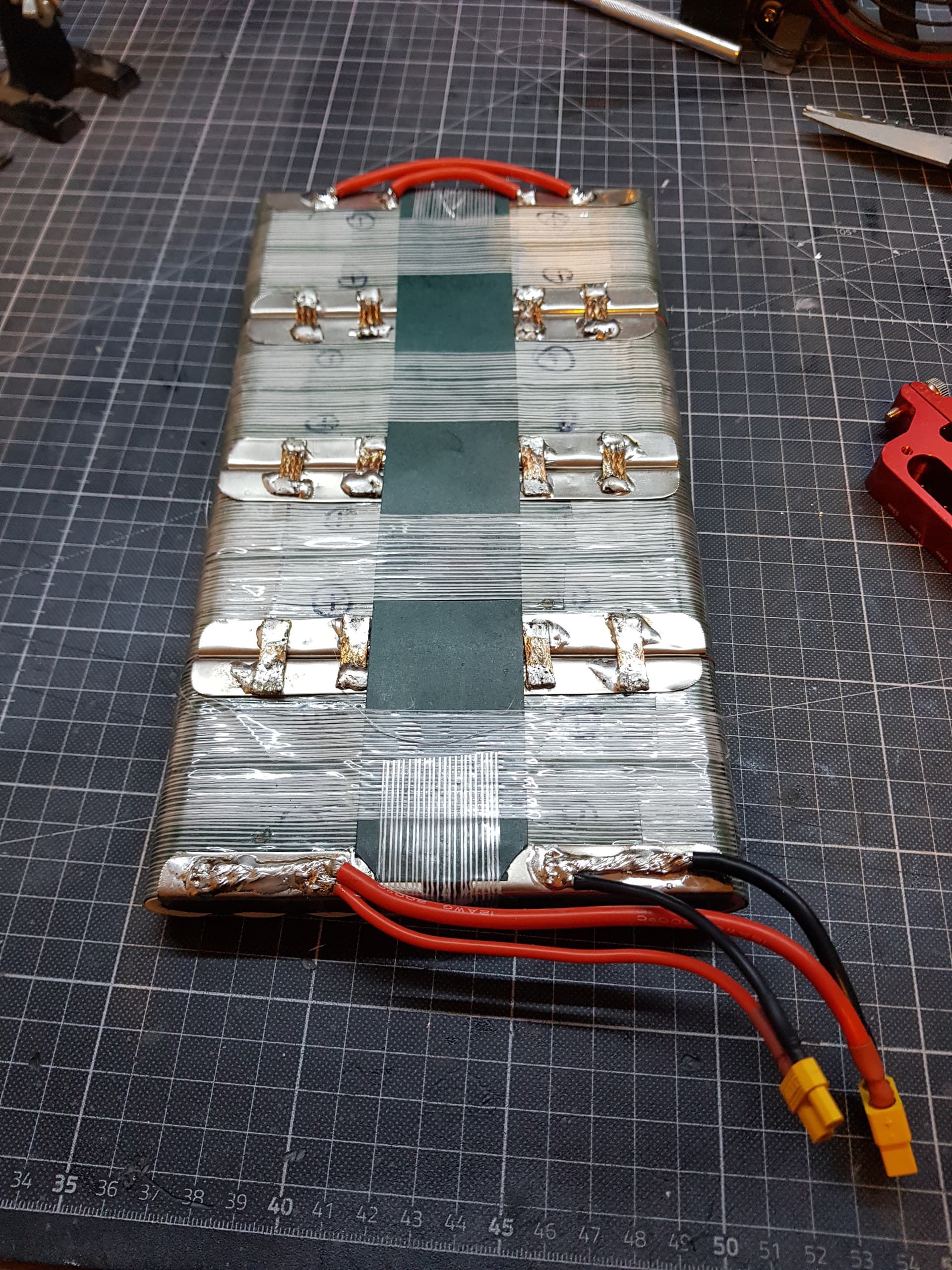

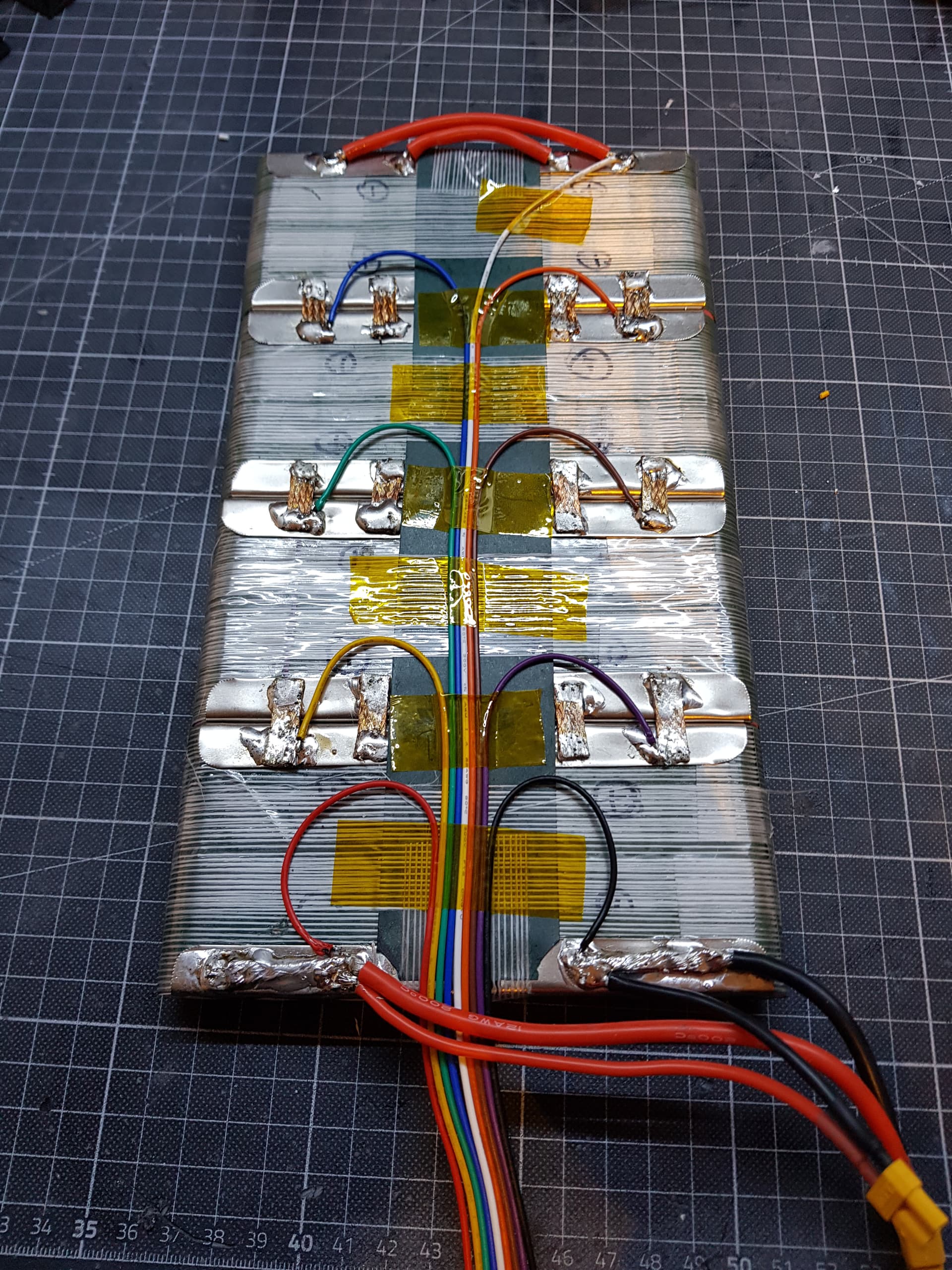

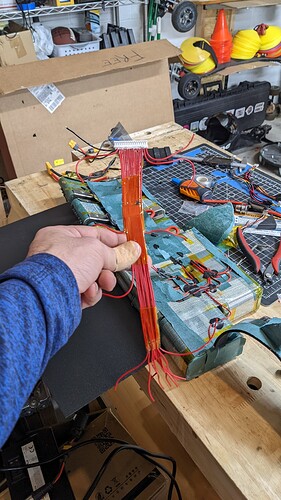

What I have found to be a bit easier to do in these areas is to have two solder points, connected with a small piece of braid as a bus, then the end of the lead on one of the solder points. It functions the same, and eliminates having to deal with many strands or multiple insulation gaps in the wire.
And since you’re using braid already it’d just be an extra couple pieces.
Food for thought, at any rate.
When I’ve done these I used one 10awg pre twisted and tinned, the soldered it onto the nickel, also pretinned, before welding it to the pack
Seems to work out alright. The charge wire I attached somewhere else on the strip - this strip could have been a bit longer it seems - still perfectly functional though
