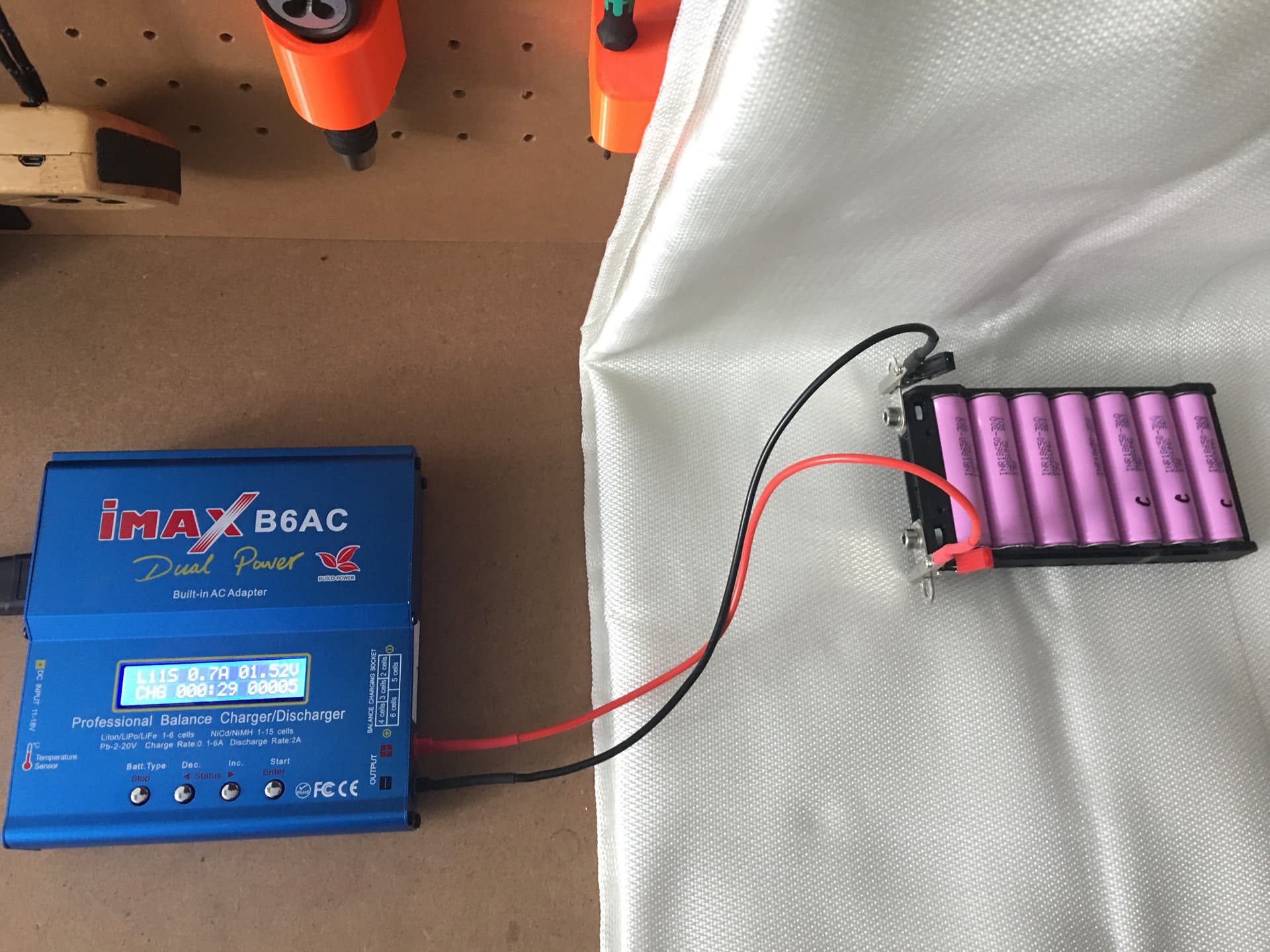

Perhaps, no way to say if there is actually any real difference between them once you are that low. It could be a little better to just stay with the higher voltage cells, I don’t know.
There is verrrry little data on this kind of thing in the industry and academic papers I’ve read. Everyone just says to never use cells that have dropped below 2.5V or so. An extreme view, certainly, but understandable as no one can know what the condition of any over-discharged cells actually is and liability is always on the minds of the manufacturers.
One big issue is that the longer the cells sit at below about 2.0V the greater the chance of the damage becoming a big issue. You might want to get as many cells as possible up over 2.5V to stop any more damage from occurring before trying to charge them fully. This would involve charging the entire pack or at least the p-groups instead of the individual cells (to save time).
Then pull all the cells out, let them sit for a day, and then sort them before charging them fully.

What charging current would you recommend for bringing them back?

Slower is better but takes longer to get your cells back up over 2.5V. Definitely not over 0.5A/cell IMO. If charging the entire pack then perhaps try 0.1A/cell. The low charge rate will take a while to get them over 2.5V but it’s safer and you’ll be charging all the cells at once (saving time).
Check cell voltages and temps often…very often.

I’ll take the battery pack apart but will keep the P-groups assembled and then try charging maybe at 1A (these are 7P groups). Will do one of the better groups first and see how it goes. I’ll keep you posted. Thanks for the help and encouragement. You guys are great.

Charging. Fire blanket in the ready. :slight_smile:
hissssssss

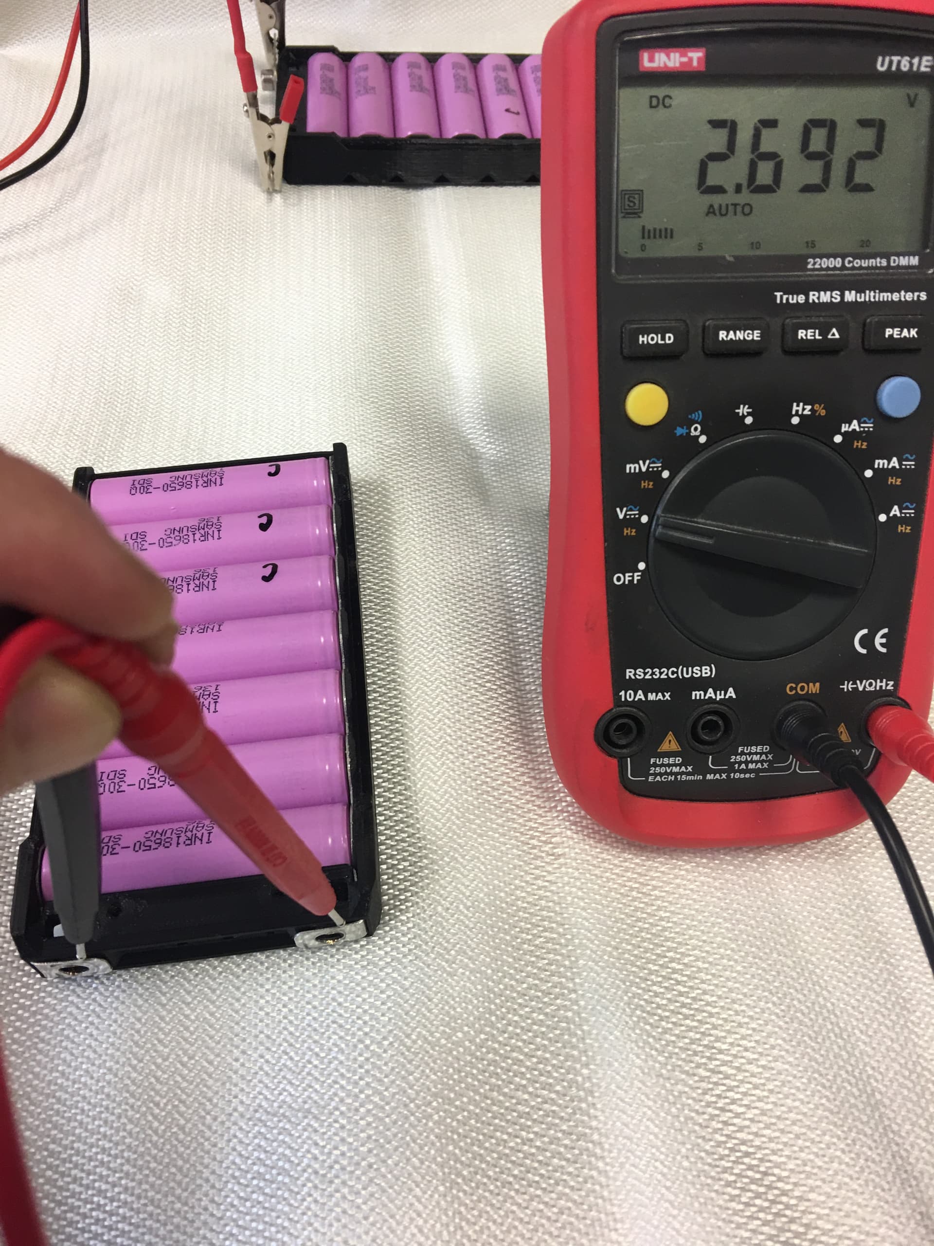

First P-group looking much happier now. Charging second.
I would at least bring it up to nominal voltage, not just 3v
The risk is 1 cell taking more current than the other charging in parallel and testing in parallel can give you false confidence. Your testing a average you need to know if one is not charging been disguised by the others. Heat is going to be your biggest clue charging like that. Keep touching them if the temp comes up un evenly stop same with keep the temps way down

I’m well aware. I may take the P-groups apart later and do more testing. From what understand, it’s important to bring the cells back to the safe voltage quickly and if I do it one by one it will take me a week.
I just know Li-Ion cells like to be at their nominal voltage, any less risks damage and anything more risks explosive decompression (fireworks)
additionally, you want to make sure your cells will recharge to at least their nominal voltage.
