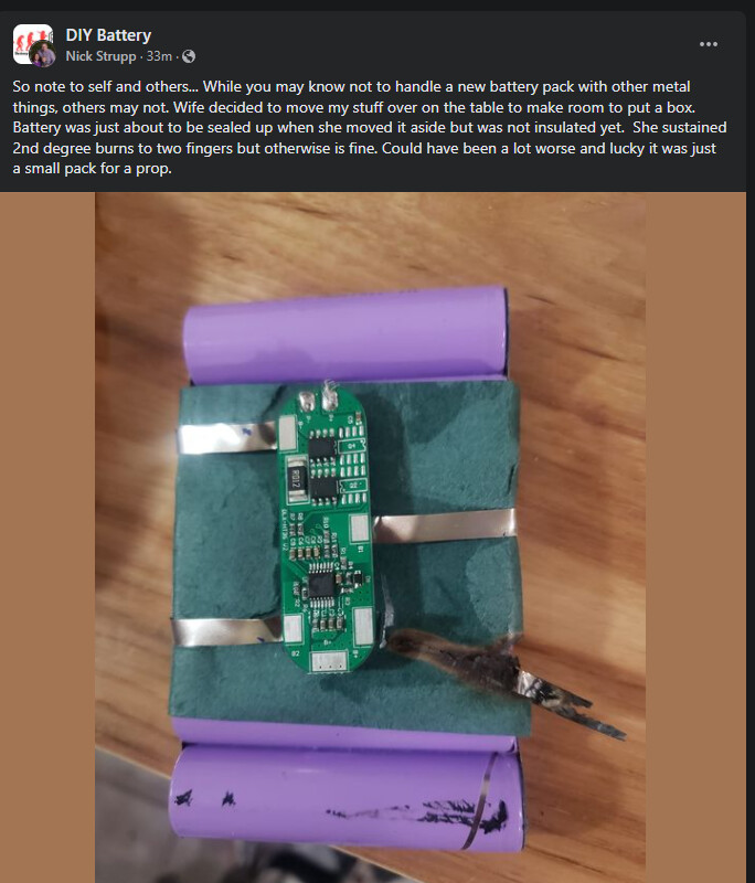

other people in a space with batteries in progress
