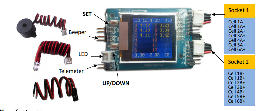

Uuhh why are there 2 leads to the same V potential connected? Talking about the far end of your pack.
Maybe he has it wired as two 6s packs for charging, for some reason
Thats makes sense. Maybe he had to 6S laying around?
I plan to use a Chargery BS12 rather than a BMS
Cell 6A+ and 1B- are the same.
Any reason why you would want this over a smart BMS?

So if we don’t use the BMS to protect the battery during a low voltage p group situation and we may not need balancing, then why do we have one? To protect against an overcharged p group? To view individual cell voltages on our smartphone to see if something needs to be done? The $25 chargery will do that, with an added benefit of audible alarms if a p group drops under a set voltage. The voltages could be verified with a multimeter and manually balanced as needed.
The only drawback I can think of, is that I need to be within earshot of the board while it’s charging, or at the very least check that the cell voltages are balanced at the start of the charge by looking at the screen before walking away from it.
However, these chargery units are not well tested on the forum. While it sounds good in theory, time will tell.

Does it sound an audible alarm for cell under-voltage as well? i.e. is there a chance that if a group is out of balance during discharge, I could hear the unit making noise and know to stop riding?

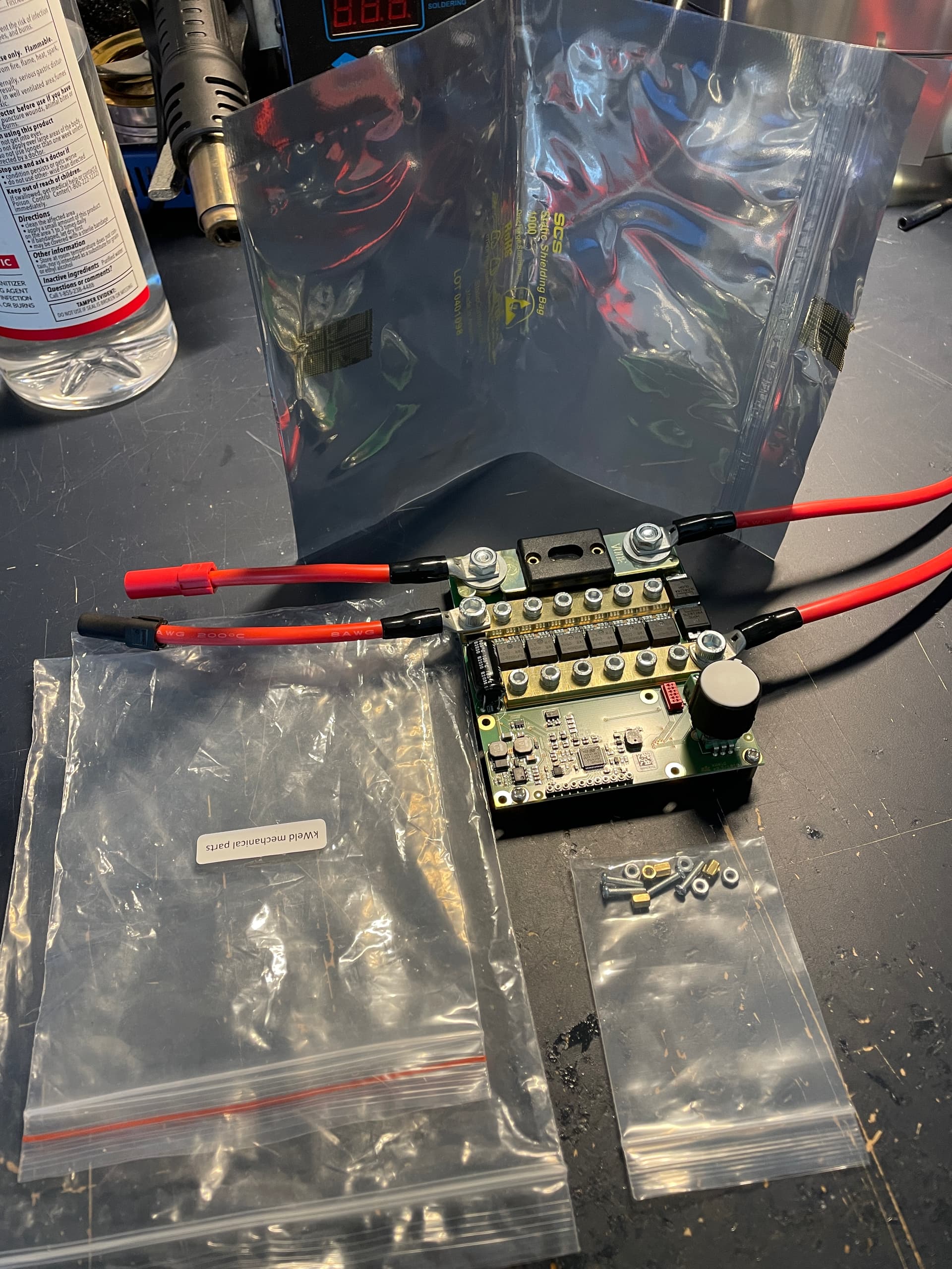

eBay will have some protections. But I ordered a Kweld and it showed up incomplete after I had to wait for his restock to ship them out, even tho when I placed my order he said he had them in stock. Now, he’s been ignoring me about the missing parts now for over a month. So I have a useless second welder… wouldn’t recommend.
:grimacing: :upside_down_face:
I ordered from him pre-covid, hard to speak for it now, probably should have mentioned that lol
On second thought, who in the world would ever order a kweld and not need the screen module, stupid that it even left the warehouse like that
My first order precovid wasn’t bad… this one tho. Fuck.

Yes, I think this is one of the big benefits. A 100db alarm will sound if any p group drops below whatever you set it to. You can also set a timer, to say that the voltage has to remain below that set point for X seconds before sounding the alarm. You can also rig it to turn on alert lights or other stuff too, but I’d probably just use the alarm.
