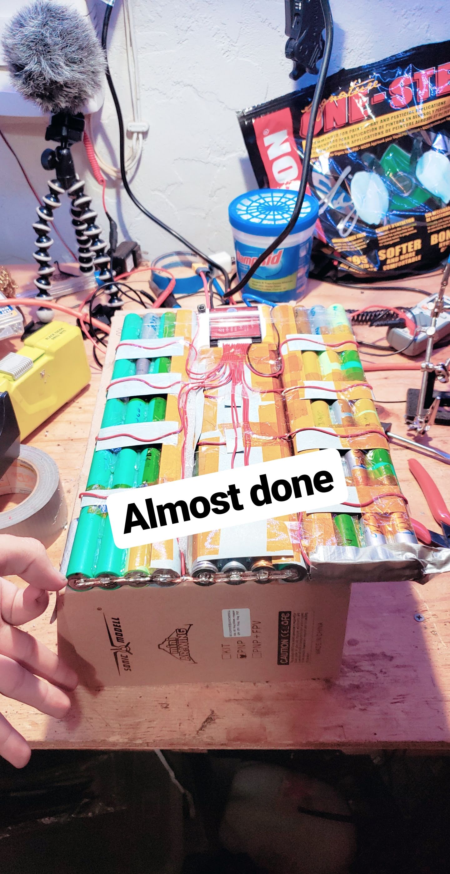

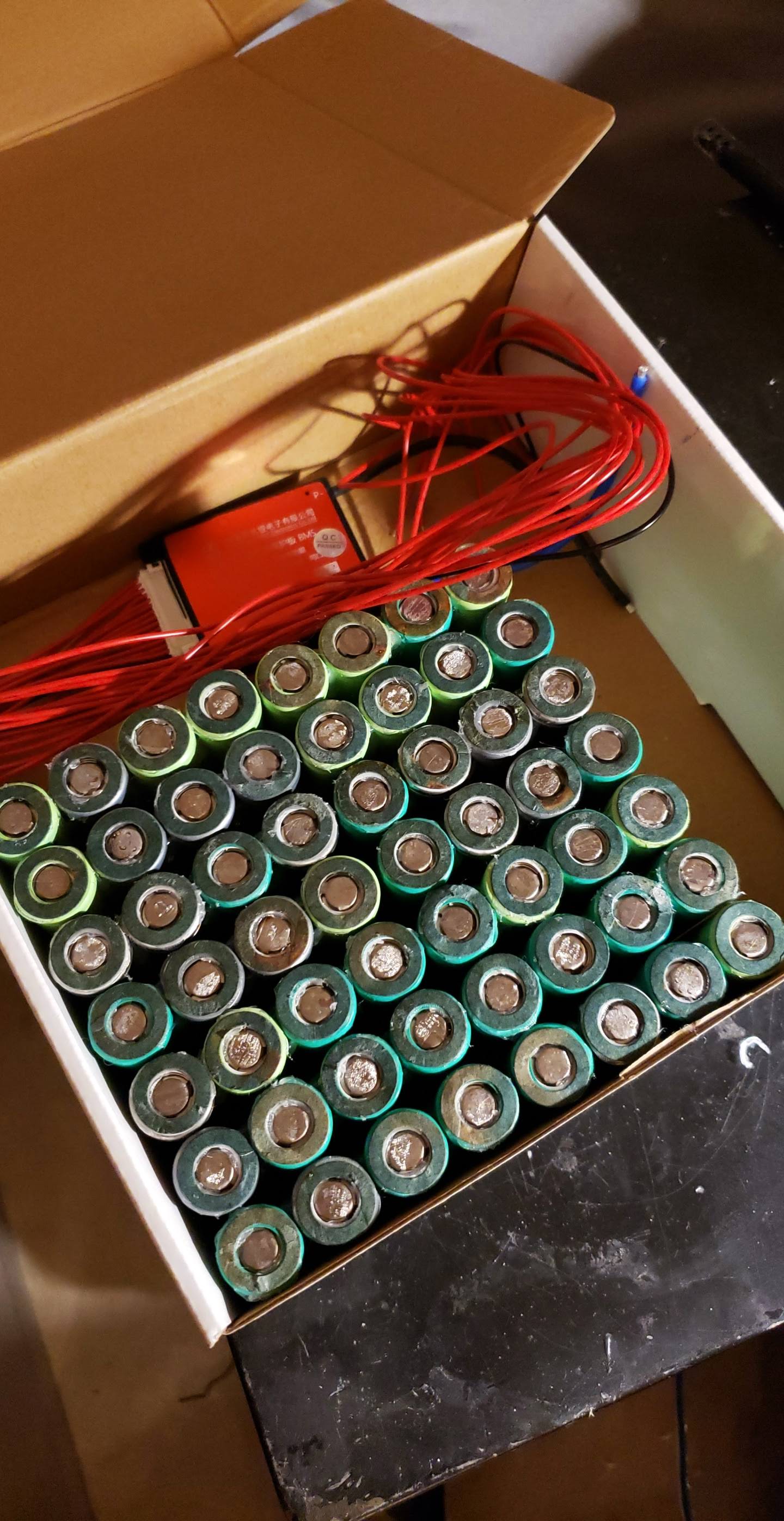

Just wrapped up this beast a few minutes ago. 14s4p for my onewheel+. Fits in the laptop pouch of most backpacks. Made from recycled 30q’s from a pack that got some water damage. Stripped all the cells to bare, cleaned, individually capacity tested, re-wrapped, and put into this insanity battery.
Aiming for 50mi unloaded, 40mi loaded with all my camping gear… You see where this is going.
Awesome! The $400 153 mile onewheel just passed 600 miles! I wonder when I will see range decrease, maybe after a year of riding or two. Averaging 12 miles every day (450mi/38day).
Can’t wait to see your range numbers!
Is this a charge and ride pack?
Yes, through a vamp style connection since the charge port won’t let you charge once the external battery gets down to 80%.
