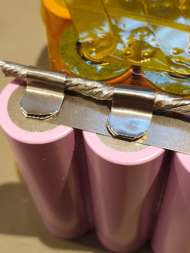

like this ?
I haven’t soldered it yet though
I’ve been thinking something like this. Solder first then weld
Actually you could weld the clips and solder the wire away from the batteries. Move the clips so they land in between cells so you can solder/weld them then have plenty of clearance to weld the base strip to cells

Looks neat bro, although i do it like this and then fold it over, or solder on top of the nickel and then fold it down the side

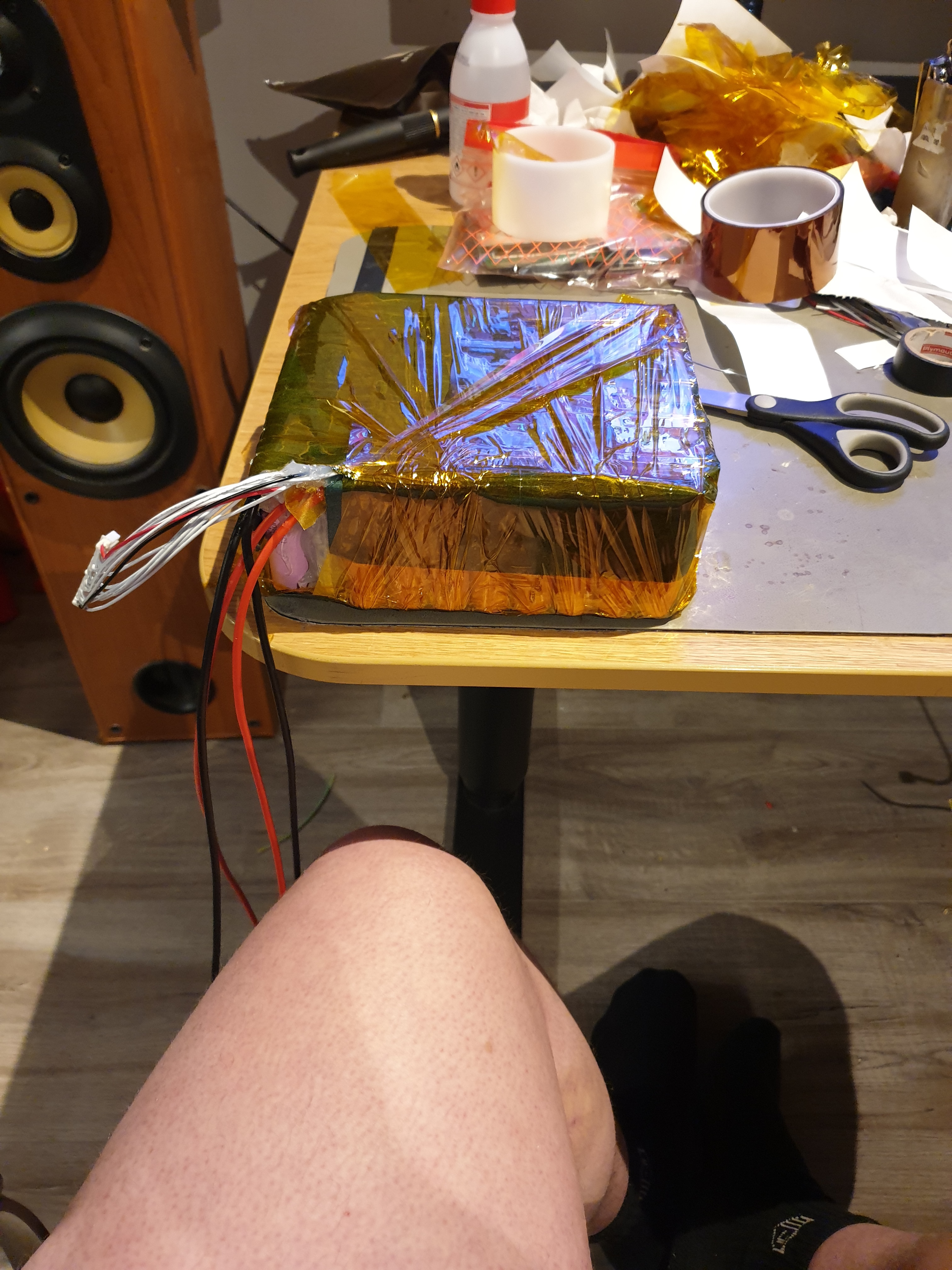

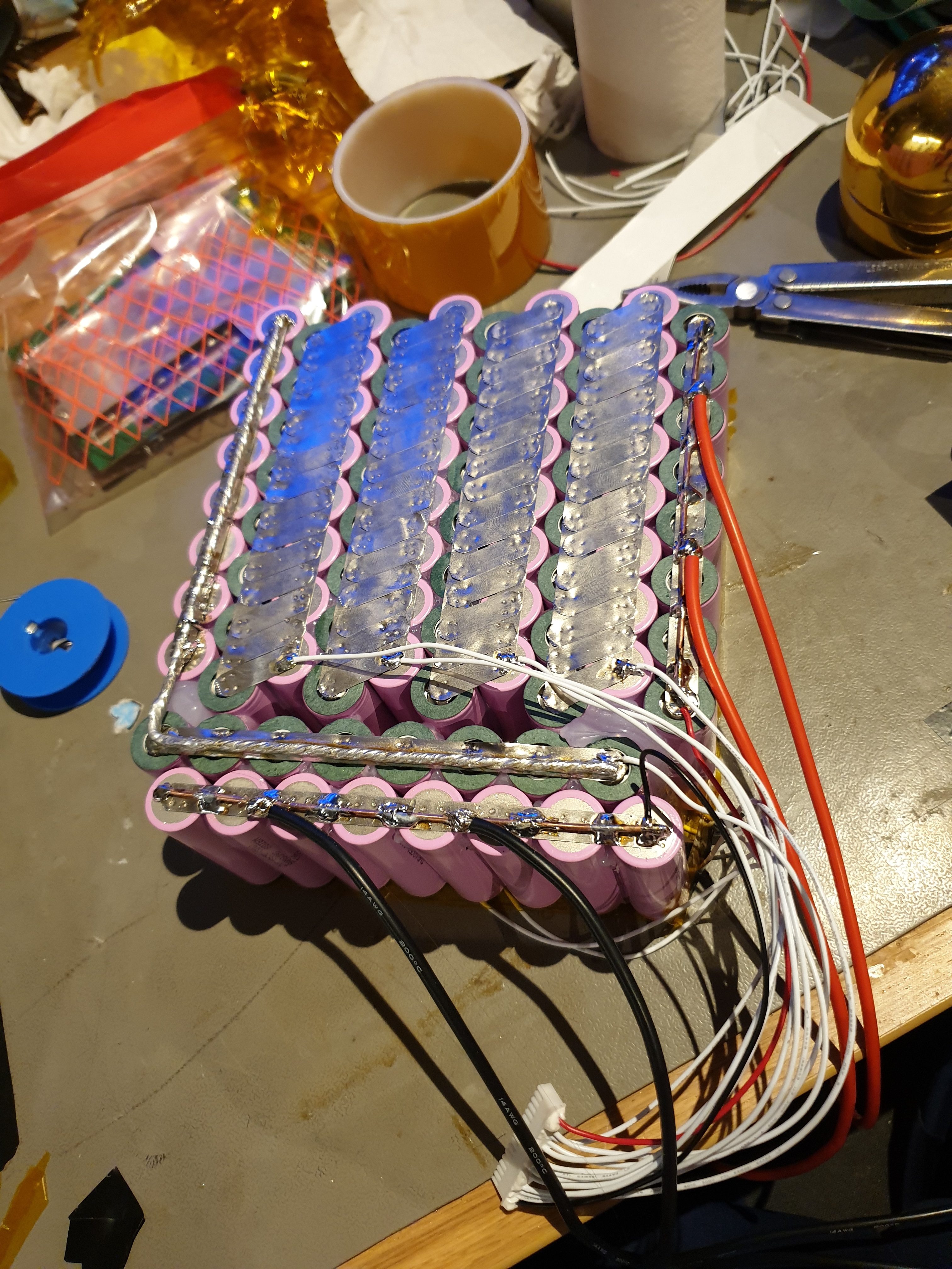

Bah, so much work, tracing the balance leads between layers of fish paper was hell and filling all gaps with silicone was the slowest progress, measured it out and everything is correctly wired, only had 14awg for the battery leads so that’s the reason I have two from each pole, but I think it should work and it may even be better, it was certainly easier to solder
Now I just have to wrap the pack and get something to put the bms in and drill the holes and all that
This pack has been 40 hours+ in the making, it’s good to see it coming to an end

Excellent! Soldering of that wire on the strip looks good.
