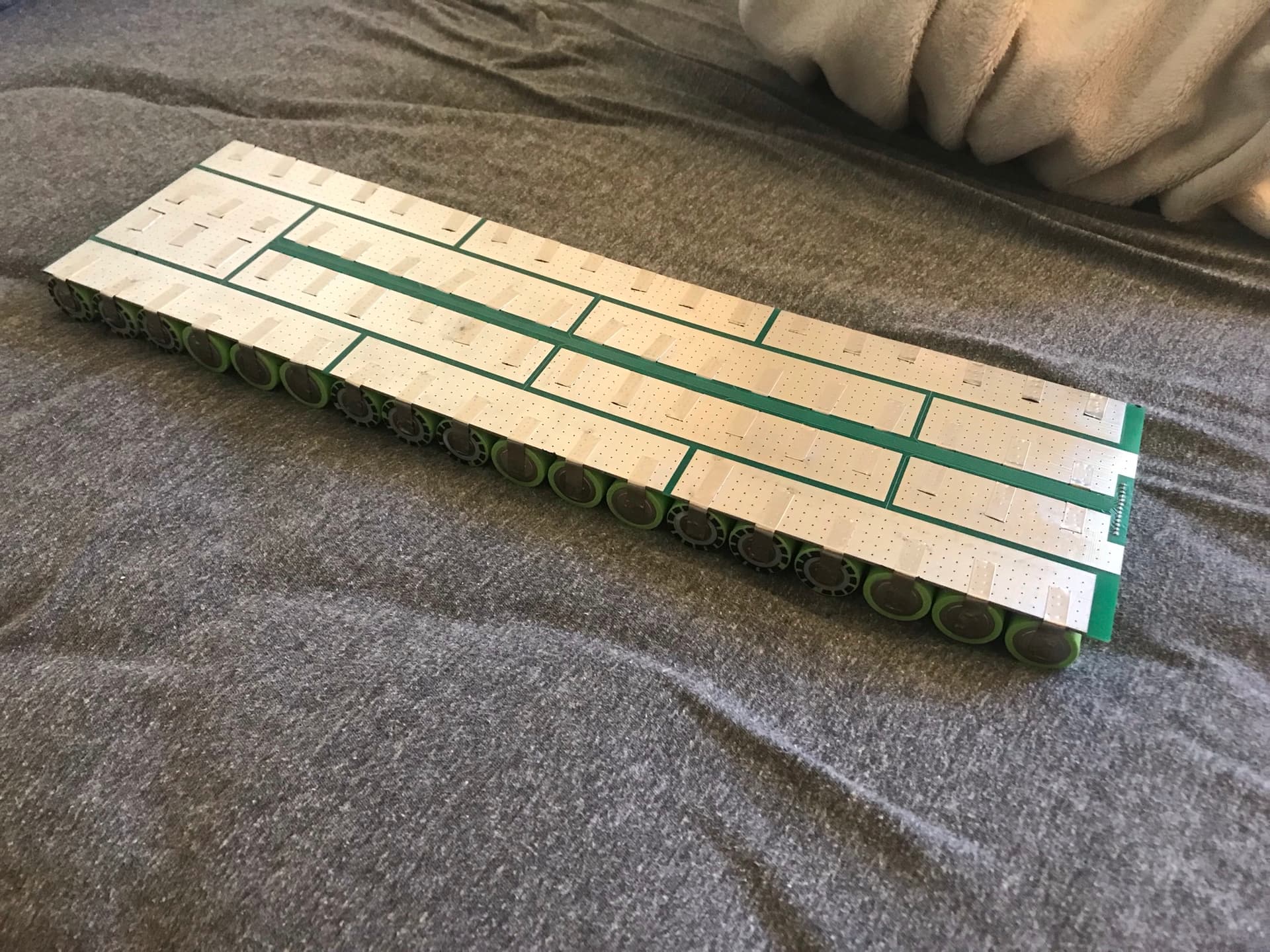

Hey guys, just lookin for some advice. So I have this 12s3p 26650 a123 partially assembled battery pack on a flex pcb and I was just wondering what else I need to do before I stick it in my board. I’ve got a LLT bms on the way already and I’ll solder the connectors soon, but what else do I need? Do I need a giant thing of heatshrink for it?
pics below:

It would be smart to put fishpaper between the end cells on each P group. Would also recommend a piece of fiber tape around each group of three

Is there a consensus on what to do when shrink-wrapping flexi packs? They kinda aren’t flexible at all anymore after they’re wrapped, and although they can flex a tiny bit i cant help but worry the shrink wrap will apply weird stresses to the pack as it bends, and on some setups where its especially flexy it might cause pretty adverse effects. I’ve cut shrink wrap to introduce some flex back before, but it kinda then starts to make it ineffective.
Anyone got a method for this?
Definitely cannot flex my 10s4p build that I had for a client after wrapping.
Only way around this is to do split wraps, or shrink it, then make incisions.
safety, safety, and safety. Spend a small segment to talk about all of the safety features we implement and why they’re important. Electrician packs on esk8 are scary!
It depends on whether I am making a truly flexible pack, or just a “flex tolerant” pack. If it’s truly flexible, then it’s probably going inside a segmented enclosure and the series connections will be a few cm long to bridge the enclosure segments. For those packs, I shrink wrap each segment separately.
If a pack is built all in one continuous segment, then I would never recommend them as “flexible”, instead I would call them “flex tolerant” meaning they won’t break because of the micro-flexing that all skate decks have, but they are not meant to flex fully. Those get one continuous piece of shrink wrap, which yes, makes them pretty stiff.

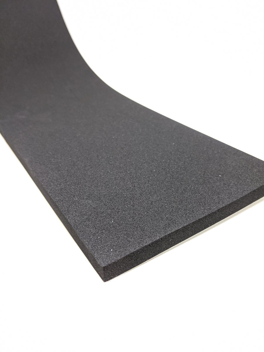

I’ve seen a few references to foam but can’t find any specifics on what to get or where to get it. I have a sheet of this stuff, but I’d prefer to keep it for the underside of the deck because I don’t really want to put in another order just for that and wait for shipping
Are there any keywords that’d make it easier to find locally?
What I’ve been using in the past are a few of these, they seem to have held up well
https://www.zeuspackaging.com/ie/cleaning-supplies/wiping-cleaning/SPONGE-CLOTHS-ASSORTED-COLOURS-20G/?gclid=CjwKCAjwk6-LBhBZEiwAOUUDp2nKiNEcqzOSQID-ENYCbX85McPNRD_XlCDKeMkMin8seqCXvFxvDBoCiCUQAvD_BwE
All the foam I’ve used has been from Amazon. Neoprene foam sheet, available in a variety of widths and thicknesses (sheets and strips), either adhesive backed or not.

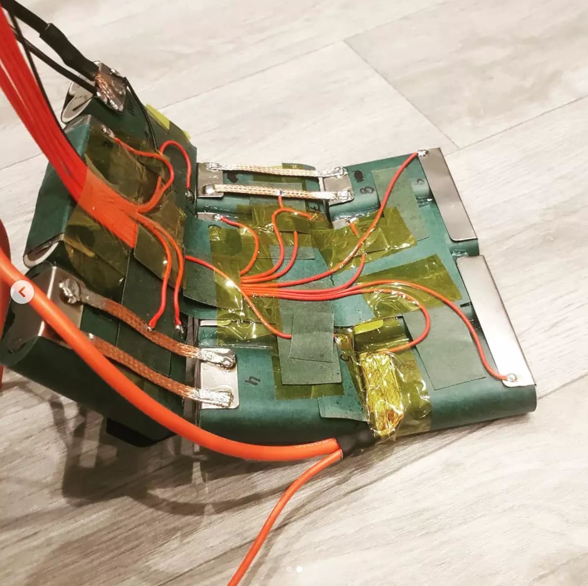

This for example was basically a solid brick after wrapping, its for a pretty stiff deck so in this case i doubt it’d be an issue but a more recent pack for an evolve was a lot longer, would potentially need more flex
Your braid is saturated with solder at the point your bending it meaning that over time small flexing could still cause fatigue and failure.
Yea I know what you mean, I think some strands are tinned but the braid is still fully flexible. The far side is kinda being reflective in that picture but its even less tinned than the close side in person
If you want the solder to wick less then using a more powerful iron or bigger tip will keep the heat more localised and reduce wicking.
Also, if your not already then pre-tinning the braid will make connections quicker.
