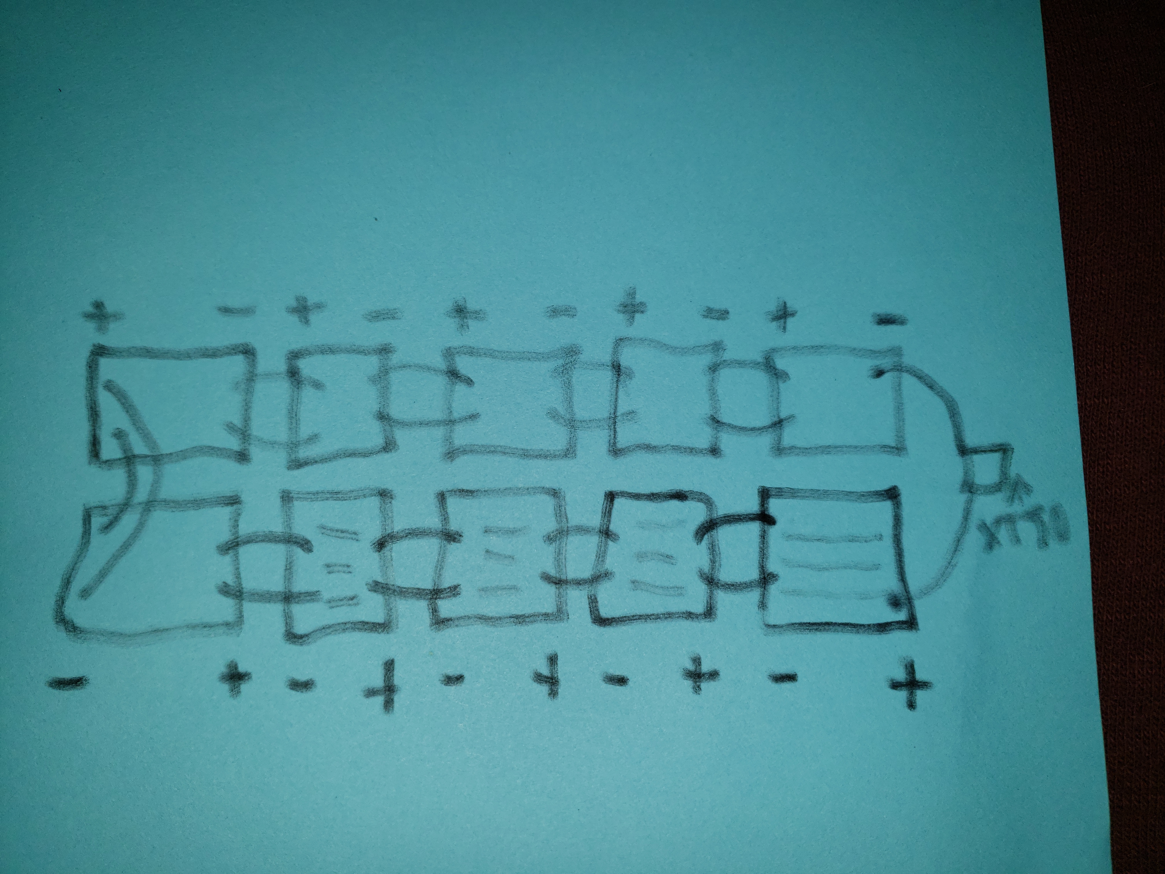

So I finished my 12s4p pack and plugged it into the board. Loop key was not in yet. All the cell level fuses blew on the first pack, and the 7th pack(the start pack to the 2nd column). Everything looks wired correctly and before plugging in registered the correct charge from the xt 90. I took it apart and all cells still measure the same? Any guesses as to what could have happened?

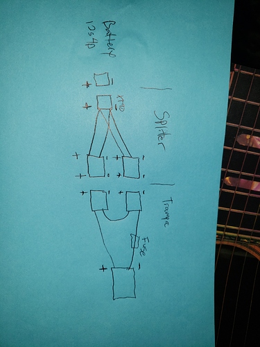

I will draw up the diagram later for sure. This was what I plugged into which went to the 2 inputs on the stock trampa setup which uses 2 loops which then go to the loop key. The lipos and board tested fine after this happened.
So you come from a 12s2p lipo if I understood right? So you used only one of the xt90 plugs to your battery pack on this parallel split cable?

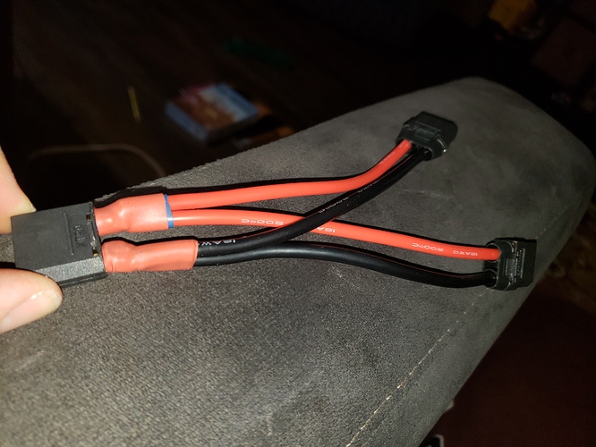

Usually the board uses 2 6s lipos, I made this splitter so the 12s4p battery could plug into the 2 plug ins. Here is a terrible drawing of the diagram
A normal loop key just disconnect one line, usually the positive wire. The trampa system disconnect the plus and minus one each „loopkey“ which is not really a loop it’s just a xt90s disconnect.
Did you think about this when you wired everything up?
Edit: you used a trampa top mount box before, just to get it right? Because that’s what I assumed. Really not so easy without pictures :sweat_smile:
I think using that splitter and going into trampas series connector was my mistake. 99%sure
So this looks to be it? Stupid mistake.
Yup looks like a short occurred if this diagram is accurate. Going from parallel to a series dongle created a short in the circled area. Dodged a bullet
using the cell level fusing in this case.
Like @KfromtheBay said, you did a direct short in the place he marked. Good that you had your cells level fused.
