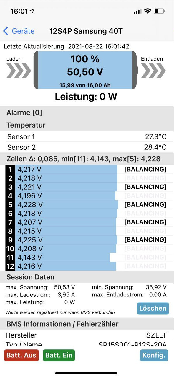

I got a LLT bms that won’t balance the 11th group, no clue why or what could cause this.
Has this happened to anyone else? Do I just have to replace it? :frowning:
BMSs balance high to low, they bleed high voltage cells as heat, if you have 1 low group the 11 normal groups will drain to match

This is expected behavior. The balancing method these BMSs use knocks down the high cells until all the cells are matched. Since cell 11 is the lowest of all, it will be the last to balance. In fact, it will never actually balance cell 11, because once cell 11 is high enough to balance, all the cells in the pack will be at that same voltage, and the balancing will be done.

Huh, but after an hour of the bms “balancing” nothing changed… mhm :confused:
