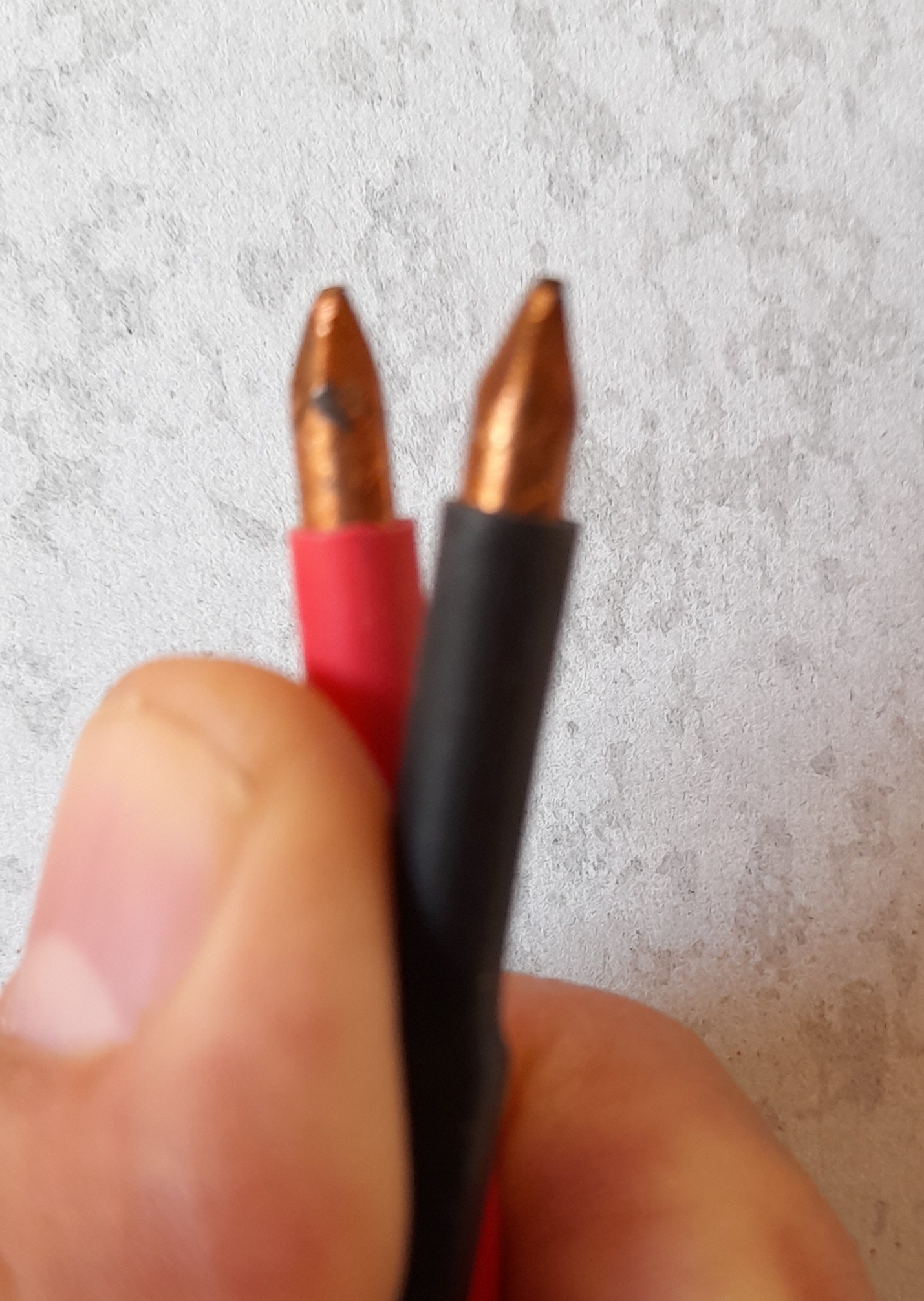

If you have the foot pedal, press it down and hold it after a weld. You should get some weld information (voltage drop, current, weld #). If its sub 650A, you’re probably looking at a new battery otherwise it could be a wire length or welding pen issue.

It says 1200 something amps, the cables are the ones provided in the kit.
The strips don’t stick together as 20ms although it burns the mdf underneath, not that I think it is an indication of anything tho
Can we see the tips of your welding pens? Sometimes oxidation buildup on the surface of the pens or its become too dull of a point. That current seems perfectly acceptable (maybe even a little bit high). If its not the tips either, I would try a full disassembly, clean all of the contacts points and re-assemble, that generally fixes general weirdness I experience with my Malectrics.
I will try to clean up the contact points
I hope the pics are not too blurry

Those look alright to me, if the cleaning doesn’t help I would contact the vendor, they’re really good for troubleshooting and repairs.
Yeah man I will contact them, seems like we have been over everything. Thanks a lot
