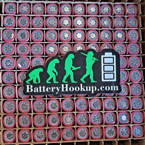

These look interesting I wonder if there is a way to vet that 17amp rating… I would guess it’s probably under 10amps continues
Hmm seems hard to go wrong snagging up 96 for possible 12S8P action.
Yeah 80amp battery with a 10 second supposed 130ish amps… sounds about perfect for esk8
hey it’s mooch. EVERYONE RUN!
These cannot be rated over 8A-10A and could be rated under 5A. There are no 18650’s with a capacity over 3000mAh that can have a true rating over 10A.
Any cell can be pulsed at far, far higher than its true continuous rating. But that increases risks, accelerates aging of the cell, and results in truly crappy performance that is often much worse than using a much lower capacity cell (with a higher current rating, i.e., less internal resistance and voltage sag).
You could rate the J2 cell at anywhere from 0.5A to 50A depending on the cycle life, performance, and degree of safety you want. This is why the datasheet continuous rating is critical, along with testing, as “pulse” and “max” ratings are useless. All they tell you is that the cell didn’t explode at that moment. It says nothing about performance, cycle life, or future safety.
Looks like we have our answer fellas! Thank you John!

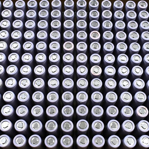

If anyone is willing to send me a pair (four is better) I will put in the testing time to estimate their rating and compare them to other cells.

I’ll order a 12 pack for my low wattage vaping this weekend, will send you 4.
Awesome! PM me for the address when they arrive.

I could have picked these 3C but cleaning up nickel would be a pain. Might try em tho idk.
These look dope for dynavaps and small flashlights yeah!

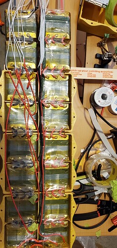

How are my balance wires on the right side? Going to hot glue them in place
Pretty thhhhhhhhicc
There are some close calls to series connections, those I would avoid. I’d either put fish paper in between, or move them.
Make sure your solder joints don’t compress agains other wires. Having them all in the same place makes it bulky there and more chalanging. I like to change them out to longer silicon ones so I don’t need to splice them.
Going to be challenging to protect that pack agains the elements between the o groups if the yello is the case
