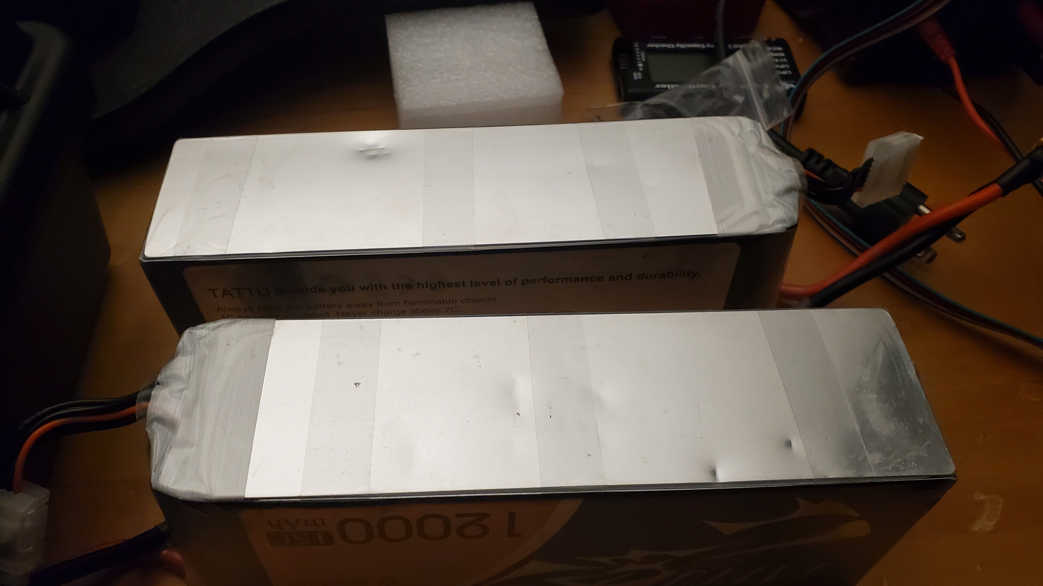

Hey guys I’ve got a couple dings in my lipo, the batteries work flawless and I’m not too worried about it, but I was curious if you guys had any thoughts? You can barely feel them when you run your finger over them.
They’re tattu 12ah 6s 15c lipos
look for voltage dropping. as long as it holds… I wish my printer worked good I would make cases.
