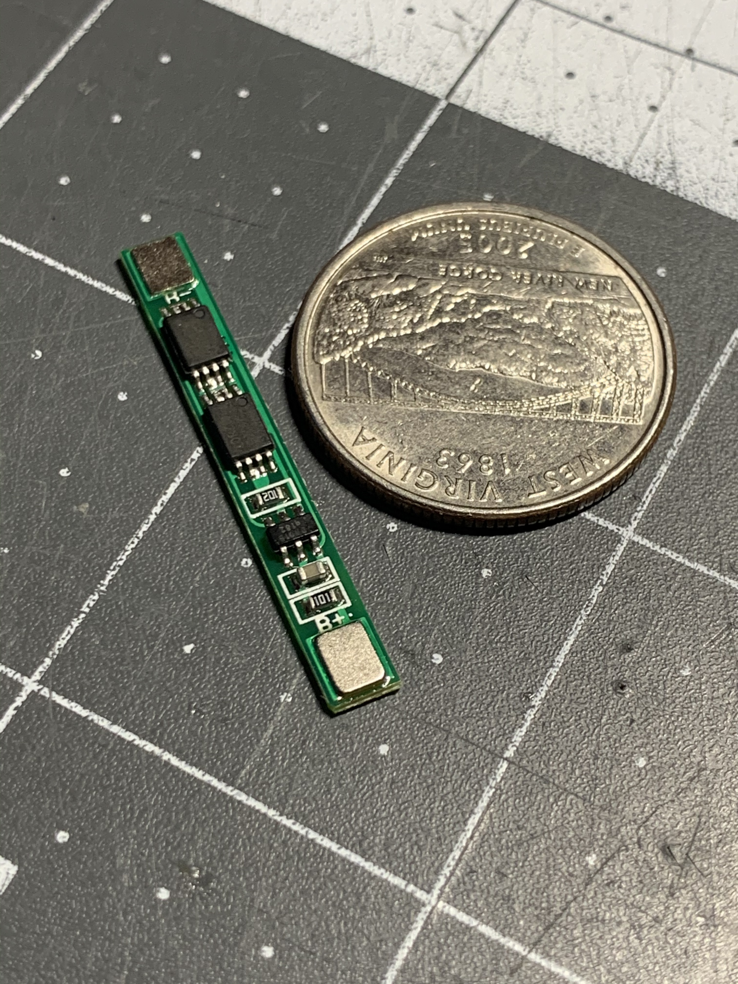

looking good?
the single nickle connection wasnt great as i had to use 2 pieces (no 15mm nickle)
welds are all very strong (rip nickle around them)
Yes I am trimming it like that :+1:
thought on series connection? (4x 16awg silicone wire should be able to carry 35amps a piece)
Is there any reason why you’re soldering so close to the edge of the nickel? You could reasonably solder the same connections in the middle of the nickel as below and would significantly reduce your risk, which imo is high soldering that close to the shoulder of the pos terminals. One stray ball of solder and you have a dead short.
This 1s BMS is so tiny :pleading_face:
Where buy? :eyes:

Oohh…they have the soldered on pads for spot-welding to. I need to find those pads somewhere, would like to buy a bunch.
Hmm…but on the opposite side of where the diagram shows the connections should be made? :thinking:
That’s what I was thinking. Can I cover them in shrinkwrap or tape? Maybe I can 3d print a cover that I can hot glue? I don’t want them to go to waste and I have a lot of them and want my accessories disconnectable.
