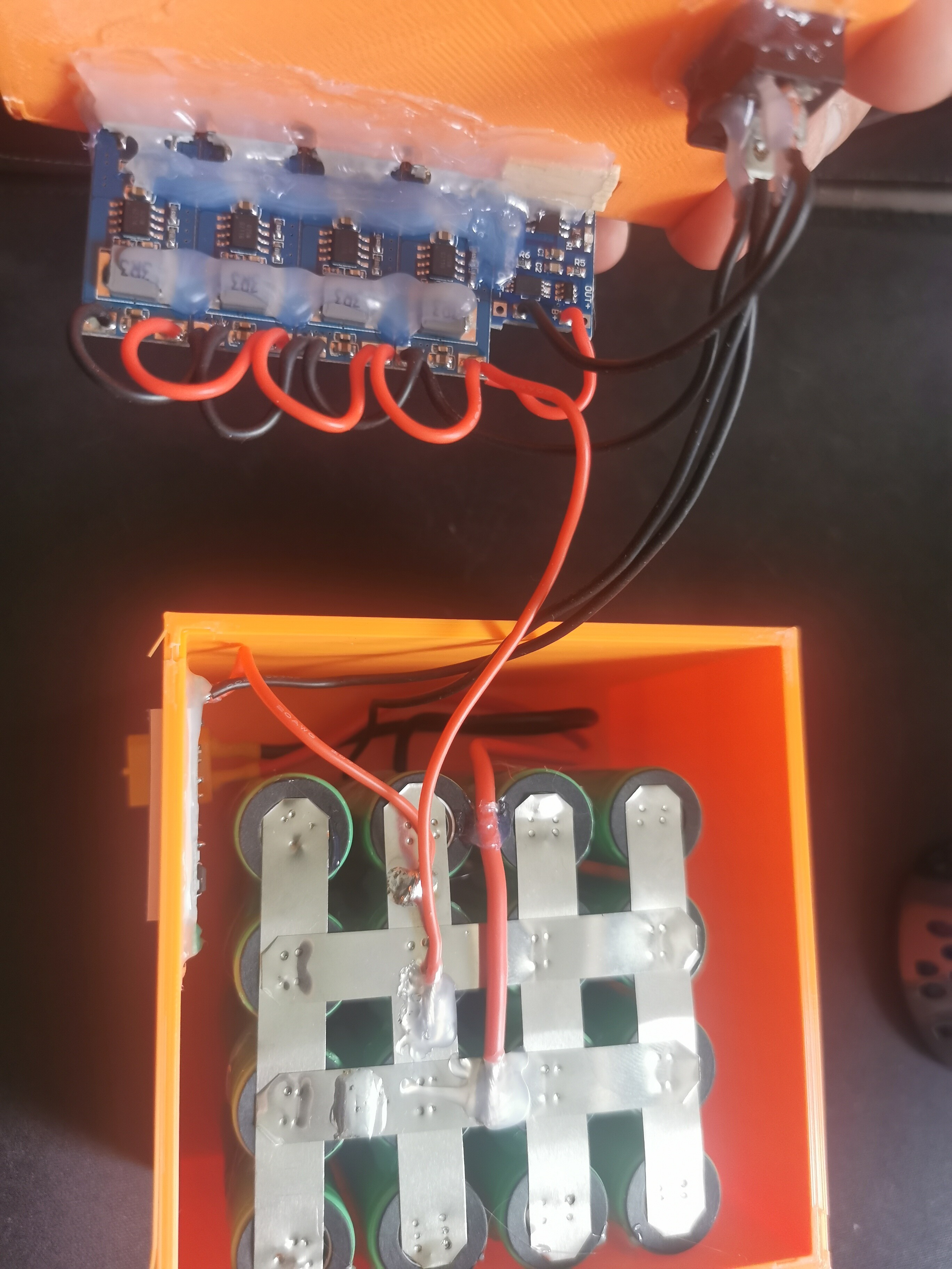

This is how i did mine :stuck_out_tongue:
