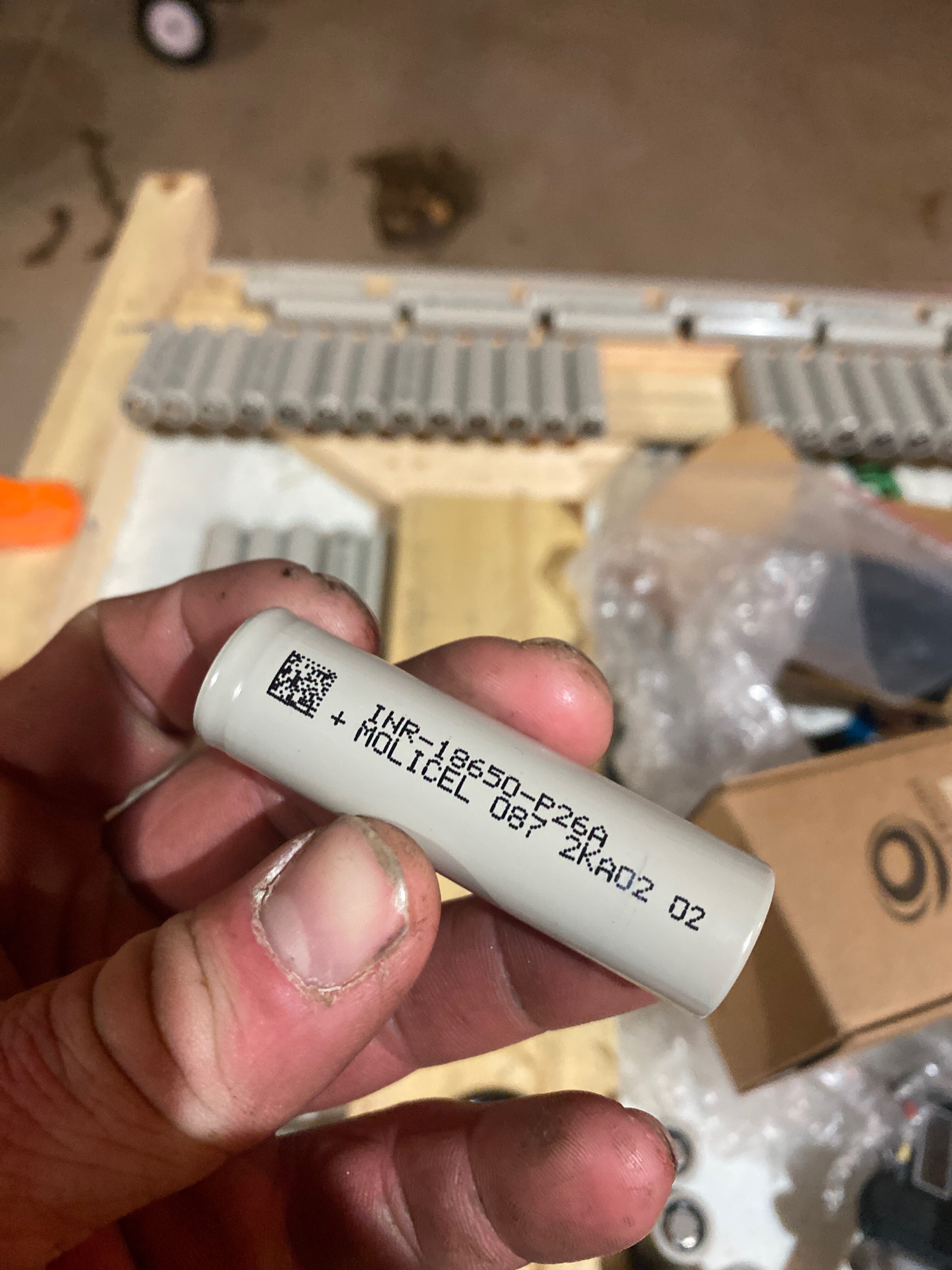

My roommate sent our batteries to the wrong address (his parents house). His dad sent them here (Georgia to San Fran) and this is how I got them. According to the note in the package this happened 5 days ago. I’m assuming the box broke and they spilled out somehow. Do you guys think they’re fine?
see if you got any voltage dippers and physical damage then send it yolo

Have insurance? If so, cash out.
No but only a few seem to be noticeably damaged. I’ll check voltages before I use them but it looks like I’ll be taking my chances with the ones that look fine.

I’m sure I’ll find a use for them . Flashlights or something for the real bad ones and the rest on my friend who sent them to the wrong address’ pack LOL.
