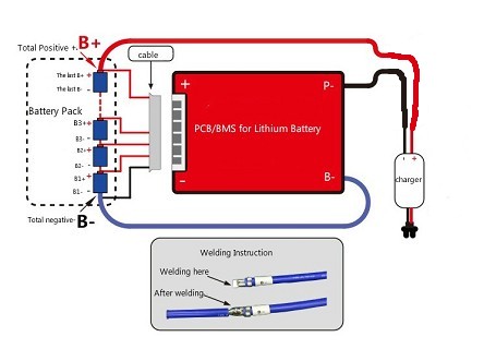

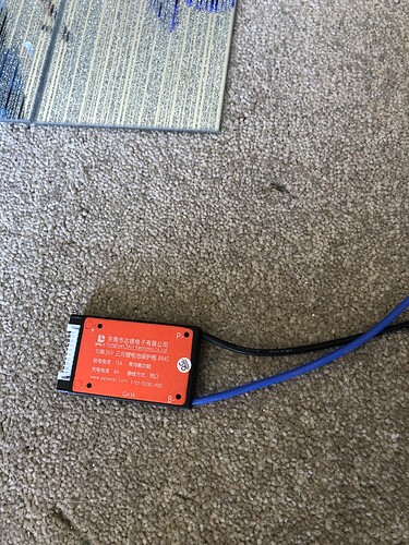

Hi Guys gunna be soldering my daly BmS in a bit just wanted to check there’s no C- so the only connections I need to do from the BMS are the balence cables and the B- for bypass ?
No, do all the connections that are in the diagram, but for the load, you need an additional B- coming from the battery
@ShutterShock Will that still bypass discharge as I thought that’s what p- was for?
Load should be connected only to B+ and B-
Charge port goes into P-
Too add on to what Ryan said, your ESC’s should never be connected to your BMS. BMS’s (for our application) should be charge-only, meaning they are only connected to the charging circuit, not the discharging circuit.
For this BMS you will follow that diagram exactly as it is written, but only connect the “charger” circuit.
Yeah unless you’re running a high discharge one like 100a and have your vescs limited
But you can run into issues with braking in that scenario because the BMS can cut power due to cells getting slightly overcharged

Thanks @ShutterShock sorry getting a bit confused on the charger circuit and load circuit what terminal does the P- link to on the charge port?
It’s in your diagram, just match positive on the charger to B+ and negative to P-
Thanks a lot, appreciate it Ryan @ShutterShock
No problem bro

Charge only Daly BMS “bypass” wiring diagram
