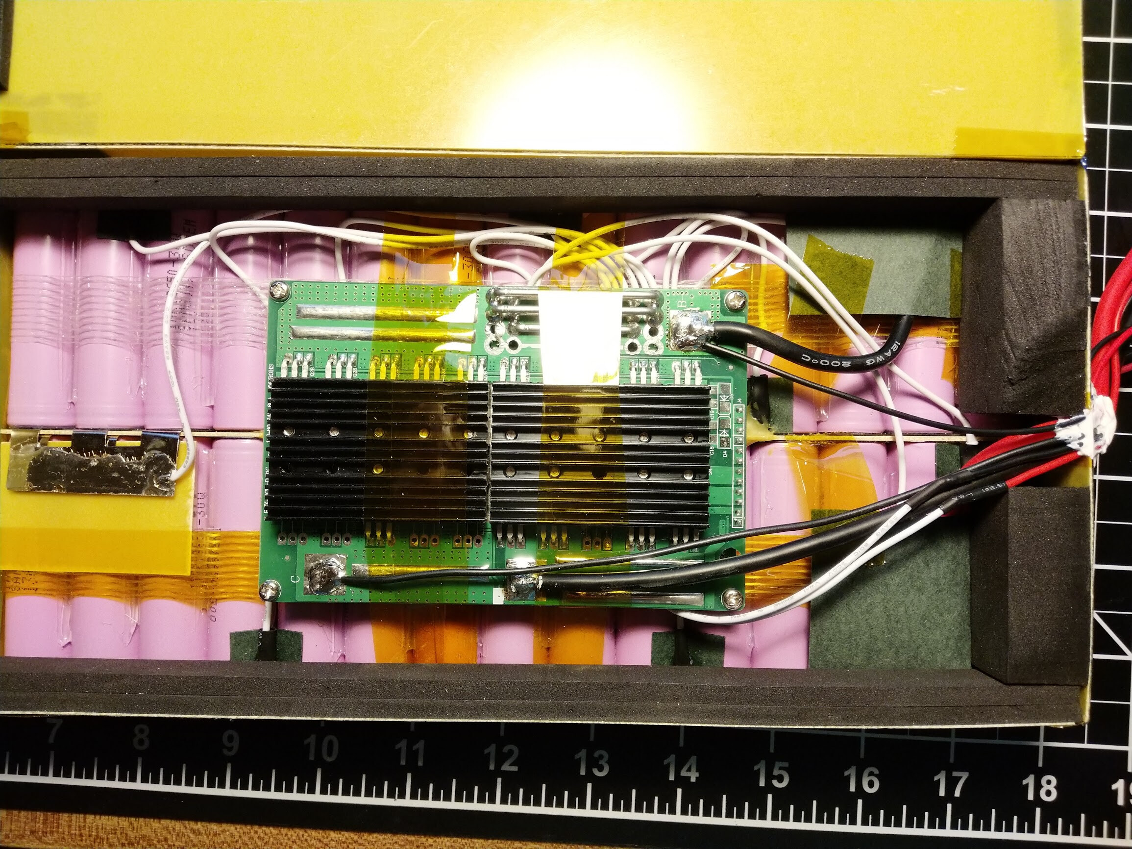

Had to dig a bit for this one. First China battery I bought a few years a ago for comparison:
Honestly that battery actually looks okay. They even have fishpaper under the balance leads
The fiberboard in the middle is a great insulator too
Before I get flamed, it’s not to our standards obviously, especially with the nest of balance wires, but it doesn’t look like it would actually have any problems for a good while.
Exactly my point :+1:t4: I think it has better construction. I have two of those 10s3p batteries. One is in my shortboard and I use it as is. Not too bad especially for the price at the time:
I agree. Makes a big difference when working on packs.

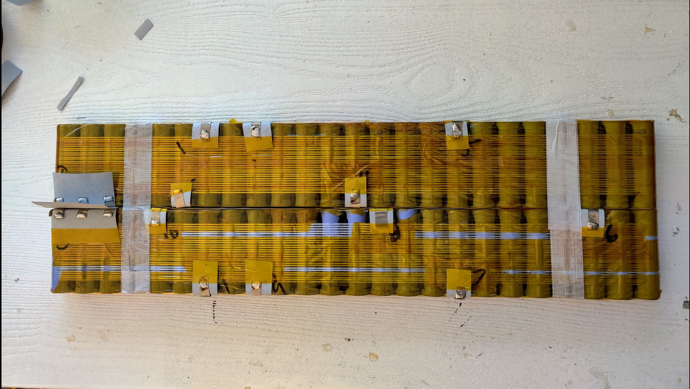

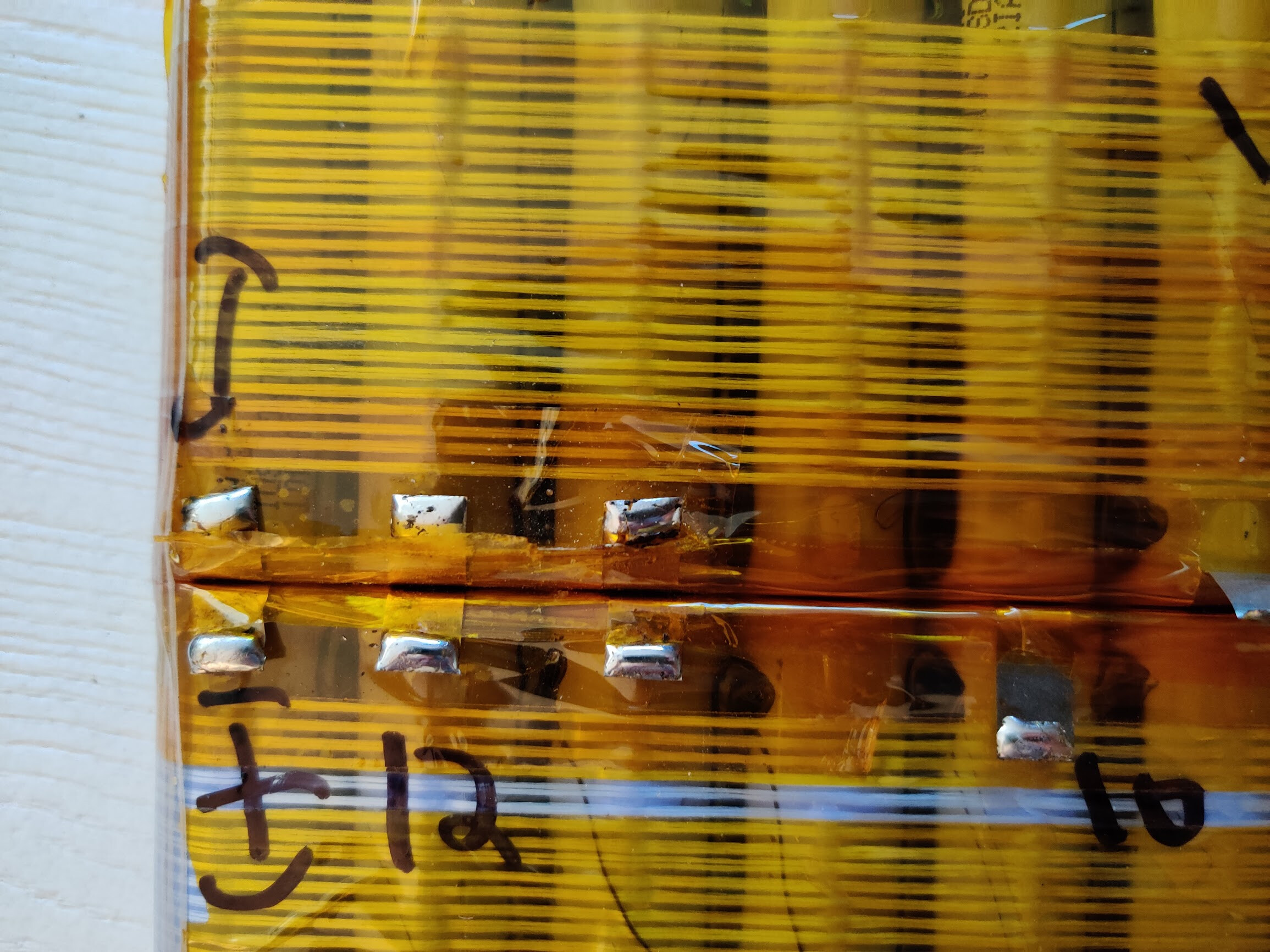

This feels sketchy:

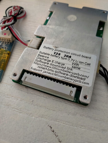

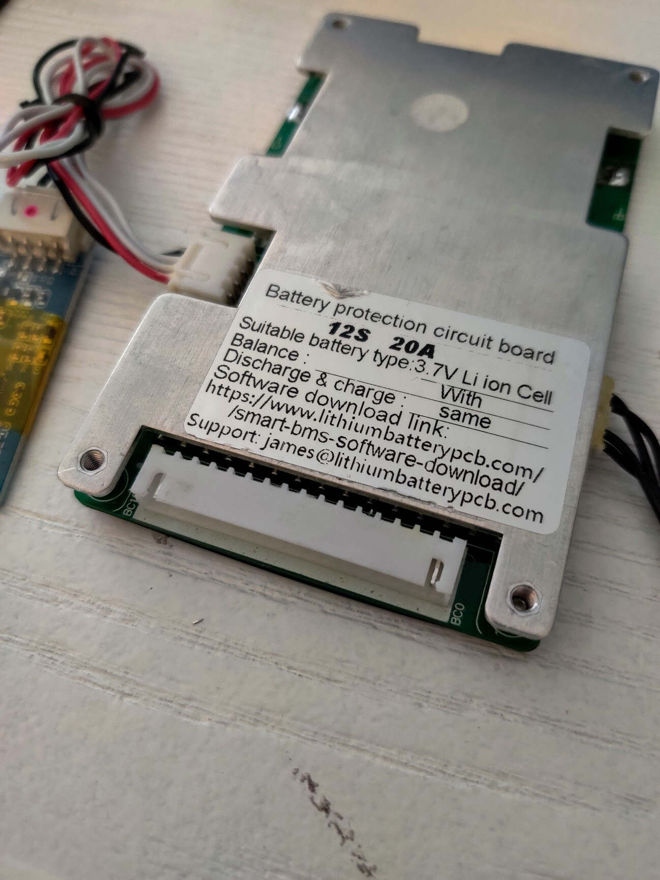

Some progress, anyone know where I can get a replacement BMS connector for an LLT BMS?
was looking for it a bit ago but couldnt find anywhere
maybe just measure between the pins and find out what connector type it is
15 pin 2.5mm JST I believe
Yep, it’s 2.5mm thanks
The issue is the esk8 standards on battery building has evolved as we see and talk about any issue or near miss. This has lead to one of the higest standards Iv seen including the large scale manufactured packs.
This makes it a uphill battle for any one making custom packs to sell to agree to maintain the standards with all the extra time it takes when other industry’s don’t. I know @BenjaminF you do but not every builder agrees
If a big esk8 brand tried to build packs good enough to be praised in this thread, they’d be out of business lol. We build our packs like we’re paranoid freaks that think the battery is going to be dropped down a flight of stairs or loaded onto a Falcon9 rocket lol
