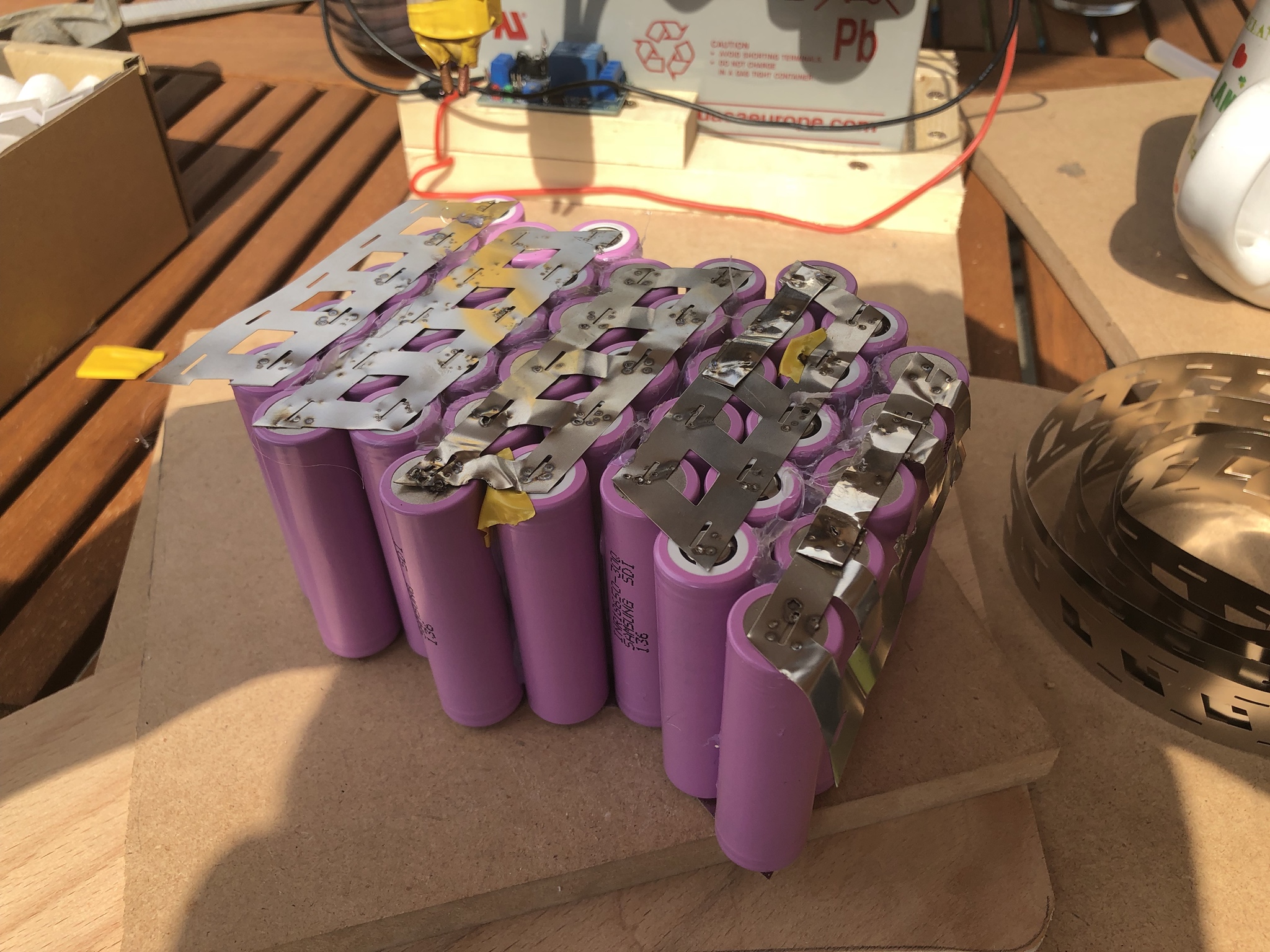

Making progress:
Still looking good? I used the Sunkko 737g, could only do 2p/70% without blowing the fuse. The test with a cutter blade and nickel looked good with these settings, small welding points but no burn marks on top and a visible ring on the underside of the blade. Could not tear it apart either without ripping the nickel. I compensated the size of the welds with quantity (obviously :D)
What’s going on with the pvc wrap around those cells? You may want better insulation between p-groups
Oh, thats Kapton. The battery will be a flat pack, P-groups will only have contact on the sides with the fishpaper and addictionally divided by a TPU printed spacer. After I soldered the serial connection I’ll also shrinkwrap each group, should be sufficient isolation from each other :slight_smile:
I’m familiar with kapton. My comment was more in regards to the shrink wrap not completely covering cell. But it’s good that you plan to use fish paper. I hadn’t noticed it in the pic. My bad!
Its a bit unusual, I know :smiley: I’m reusing cells from two NESE compression pack batteries and for those I had cut the shrink at the negative side to prevent cutting pieces of it when pushing them in :slight_smile:

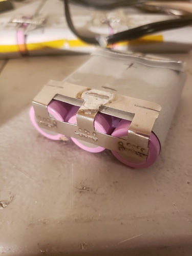

How does this connection look
And is this connection enough for a 12s3p?
I would be worried about series current running through these spots
Edit: if the tabs from your cells ran all the way to the other side of your busbar strip it would be a lot better
I didnt think it would matter much because off this
I could do something like this
For piece of mind i think that is the safest bet :+1:
