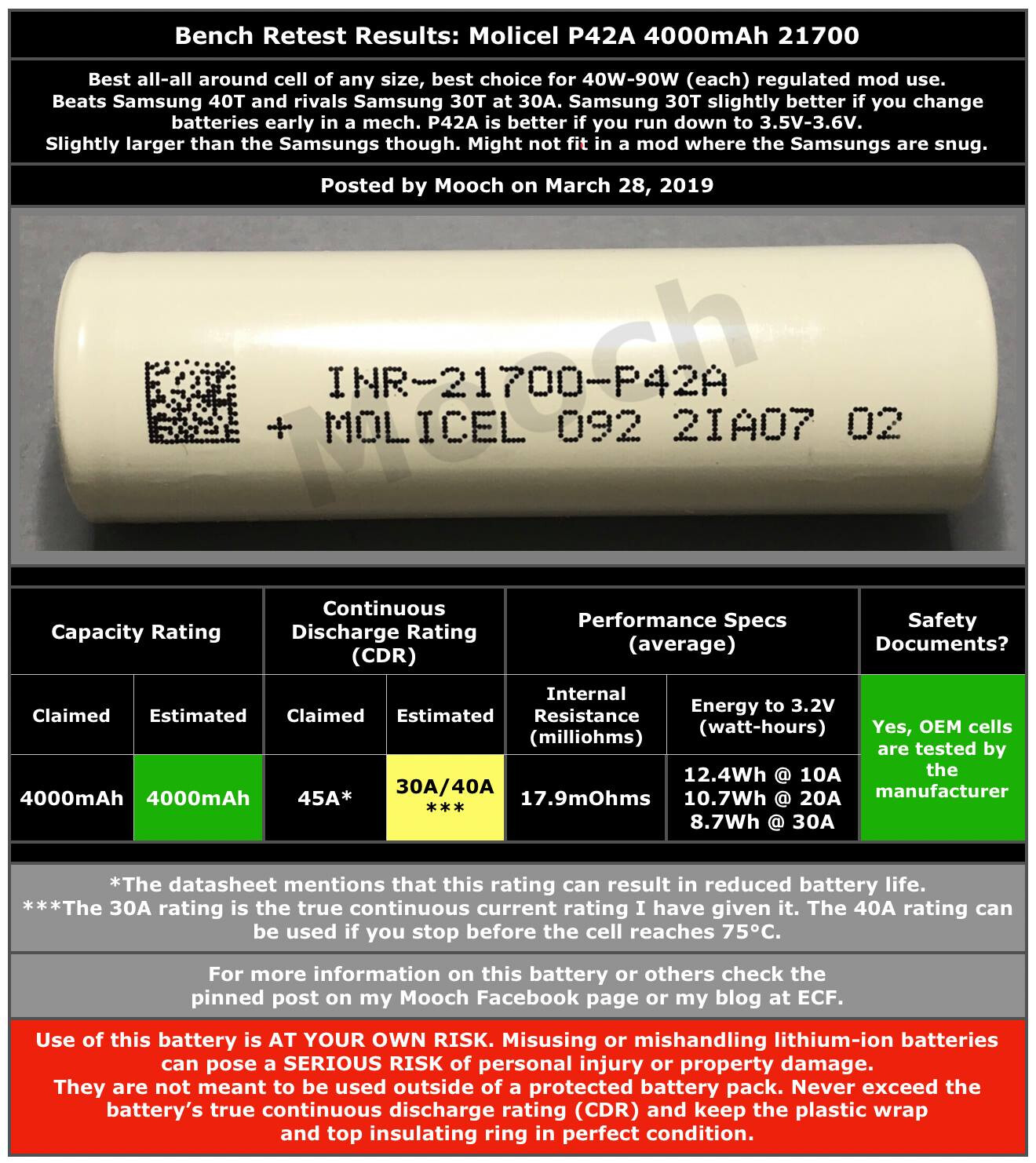

It’s most likely the P42A in every way. More current, capacity, and best price because you need less P42A to match the 30Q. Even smaller total size, and the bigger cells are easier to build with.
I thought max continuous A for the P42As was 30A cts?
Was there a change to the battery since this test was done?
so there it says it 40A can be used when the battery cell doesnt is under 75 degree
i dont think my battery ever got above 60 degree
I never have problems with my batteries heating up. They only get slightly above ambient… maybe I’m not pushing them hard enough lol.

think the 30T is the way for me it costs 3,5€ and the pa42 6,5€

Just a few side notes…
  • Molicel rates their cells for non-continuous use, how their large commercial customers use them (power tools, vacuum cleaners, etc.). The P42A’s rating of 45A (by Molicel) can give you the stated cycle life if you stay under 75°C. That is the internal cell temperature. The cell could feel just warm from the outside of a pack and be pretty toasty internally.
  • I rate Molicels lower because those are my estimates for the cell’s true continuous current rating for decent cycle life. That allows for direct comparison of the Molicel to other cells. My rating isn’t the ā€œcorrectā€ one. It’s the one I use to allow for these comparisons.
  • There’s no one ā€œcorrectā€ rating. It all depends how the cells are being used and what your priorities are. If very long cycle life is mandatory then the P42A might be given a 20A rating with a 60°C max temp. If cycle life is secondary and pure power is needed then they could be given a 50A rating. They will not last long though at that level and your risks go up.
  • How hard you use a cell is up to you. Any of them can be run at a level far above its continuous current rating. But the performance will be crap, the cell’s overall life shortened, and the risk of problems eventually popping up increases. Some people care about these things but others only care that they have a certain amount of space for their pack and are going to use that pack hard.
  • I’ll always recommend staying at or below a cell’s continuous current rating even if you’re only pulsing the cell, especially with ultra-high capacity cells with lots of internal resistance (which causes voltage sag). Staying below the rating helps the cell run more efficiently (less voltage sag), increases the overall life of the cell, and reduces risks. It’s your call though. Use them the way you want to. I just ask that we first take the time to make an educated decision, understanding the tradeoffs and risks.
Don’t threaten me with a good time…
Thx for the detailled testing ive read through it and now its clearer why the pa42s dont really provide 42a for the eskate purpose (in case you want them to last for a while)
I think ill do a samsung 30t pack now with16s5p as the cells are cheaper and the amp rating is also good
