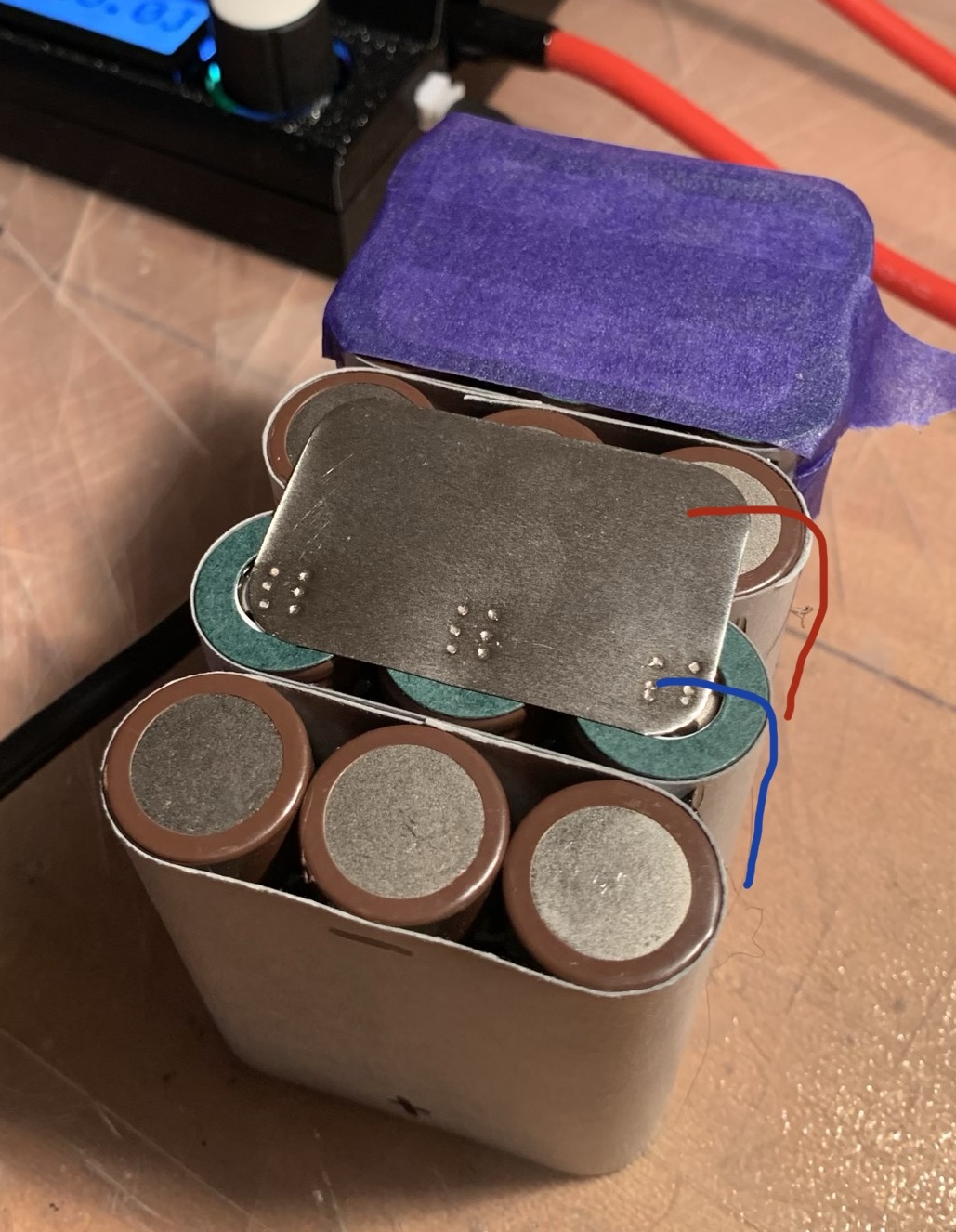

just finished welding and done most soldering
before i cover the open areas i need to attach balance leads and just confirming i havent done anything stupid and that the balance leads should be attached to the positive
People normally connect to -ve because the can is -ve and it reduces chance of shorts near the connection
so on each p group i connect to the negative of the group?
thanks just dumbing it out for me

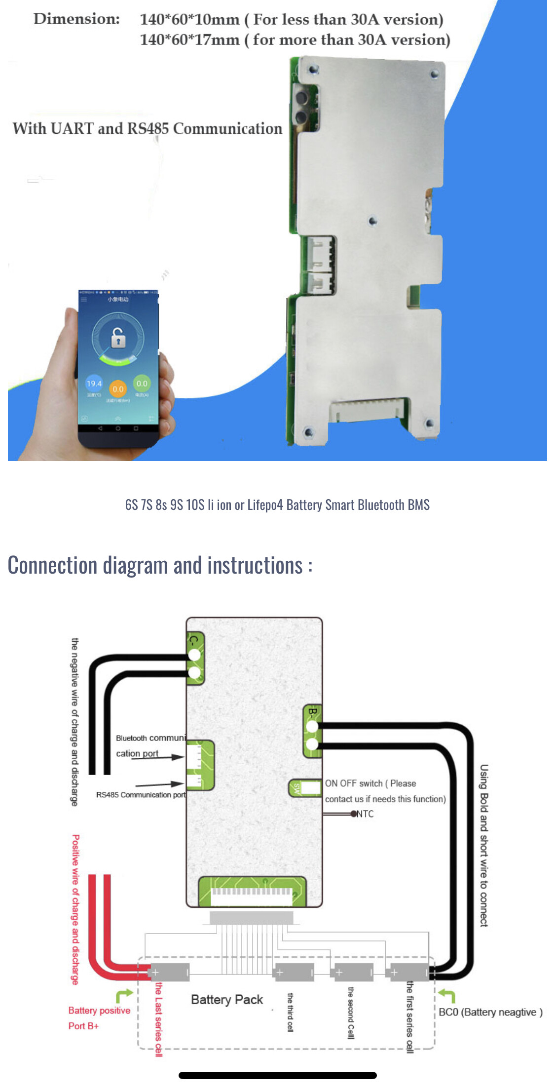

Look at info on your bms / instructions.
Basically it needs to be able to read voltages across each p group.
I don’t have BmS in my board and connections can be different for some models…?
ah okay
my bms i dont think actually came with instructions will find them online
Still not really sure but if the wire is running along the cell, I would run it up the negative side so that even if it shorts against the can it’s at the same voltage.
For example I would recommend the red line here instead of the blue because the blue could short against the corner or the can of the cell and short out because they are different voltages.
ah okay so if i doesnt matter i will do negative
thanks
But make sure they’re all on the negative except the last red wire
Here is the instructions for the smart BMS type we got mate
yep so finsihed all soldering except bms and measuring 42.7v
seems all good gonna wire balance cable tomorrow
they clame to put the balance leads on the positive
does that mean i should put the last 2 leads both on the last negative?
thanks

soldered connection between packs and finish line is looking closer
just bms and main leads to go
I would recomend you separate those 2 long packs with something more then just fishpaper, because your main passive and negative will be so close to each other
What Skyart said, either use a lot of fish paper (maybe 3 layers if you have the good stuff) or a layer of fiberglass sheet panel
You can also use some hard plastic from a binder for example
ah ok was just gonna use like 6 layers of fishpaper (3 on each side)
is that ok?
