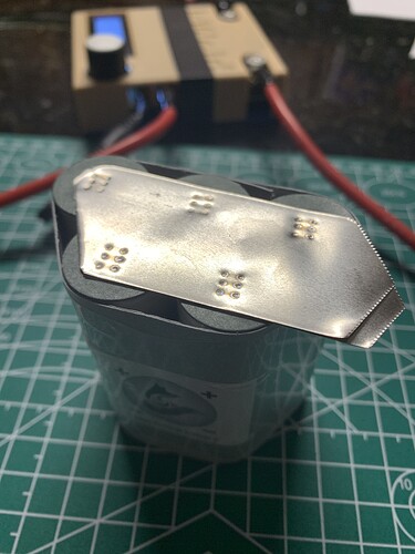

Yep did that all that and came out real nice
What is the best way to test them?
I pulled hard and they didnā€™t come off so I assume they are ok?

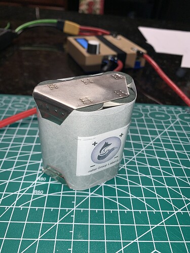

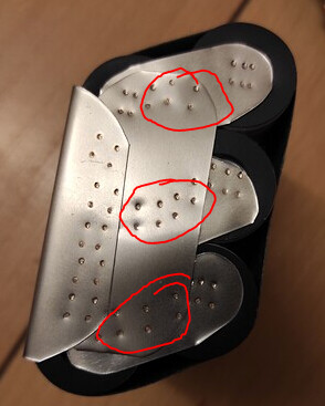

Also if anyone can confirm these all look good
On some test cells the welds did come off with a lot of force but left bits of nickel behind
Yeah, thatā€™s the best nondestructive (or selectively destructive? only destroys the bad ones) test.
Yep perfect
Looks like everything is good then

Welds without the cell below them, like this, is something I would never do. Especially on the positive side.
Yeah thinking about it blowing through sounds like a bad time
