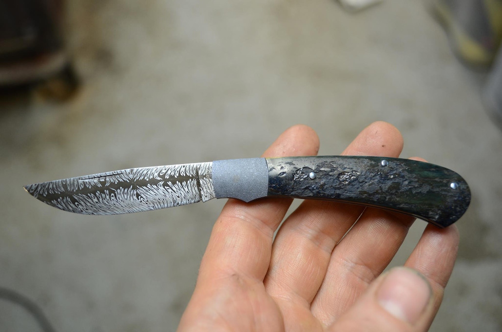

Since this is already majorly OT, here’s a photo of some of my knife work, in case anyone is curious.
This one is from 5 or 6 years ago, but one of my favorites. It’s 1095/15n20 carbon damascus in a pattern I created called “Warbonnet”, it’s a slipjoint folding knife, with titanium anodized fittings, domed pins, etc, and fossil woolly mammoth tusk for the covers (handle). 100% hand made, by me, even down to creating the little pin (rivet) heads with a tiny ball peen hammer from rod. Obviously I didn’t harvest the tusk from the mammoth directly, since they’ve been extinct for over 10,000 years, and I didn’t dig the iron ore, and smelt it (though I have), but you get the picture I think. :laughing:
Gorgeous.
Absolutely incredible work…beautiful.
Thanks for indulging me guys, much appreciated.
Damn. Was not expecting that. I think its on topic enough :rofl:
Incredible work bro, kudos.
