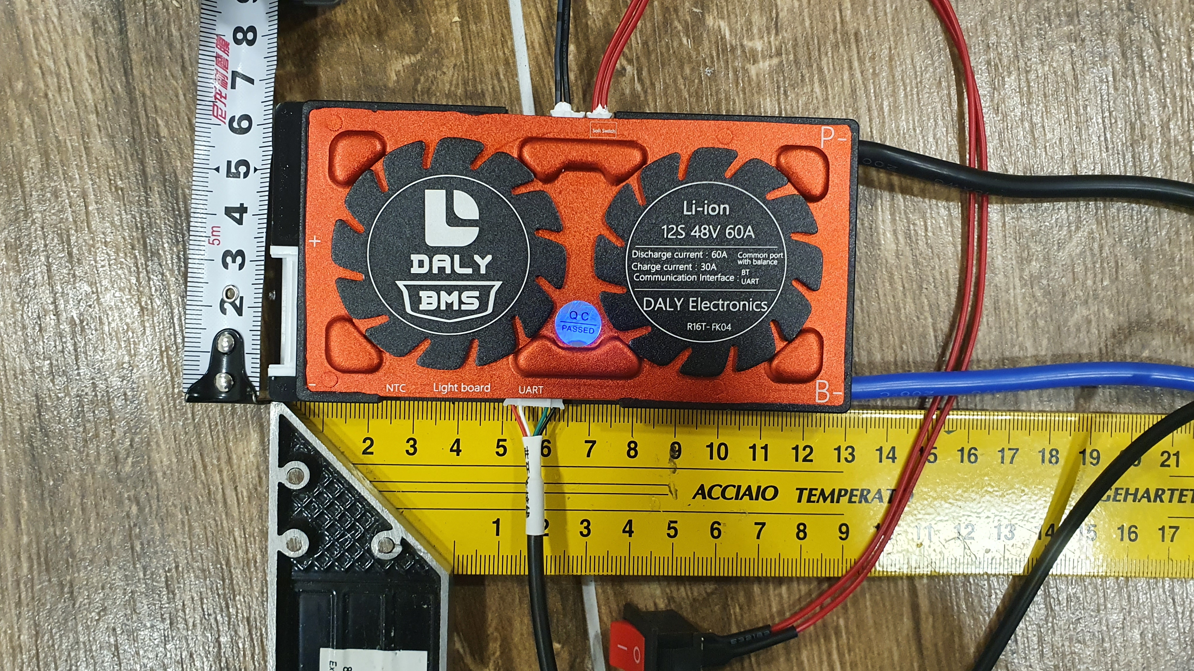

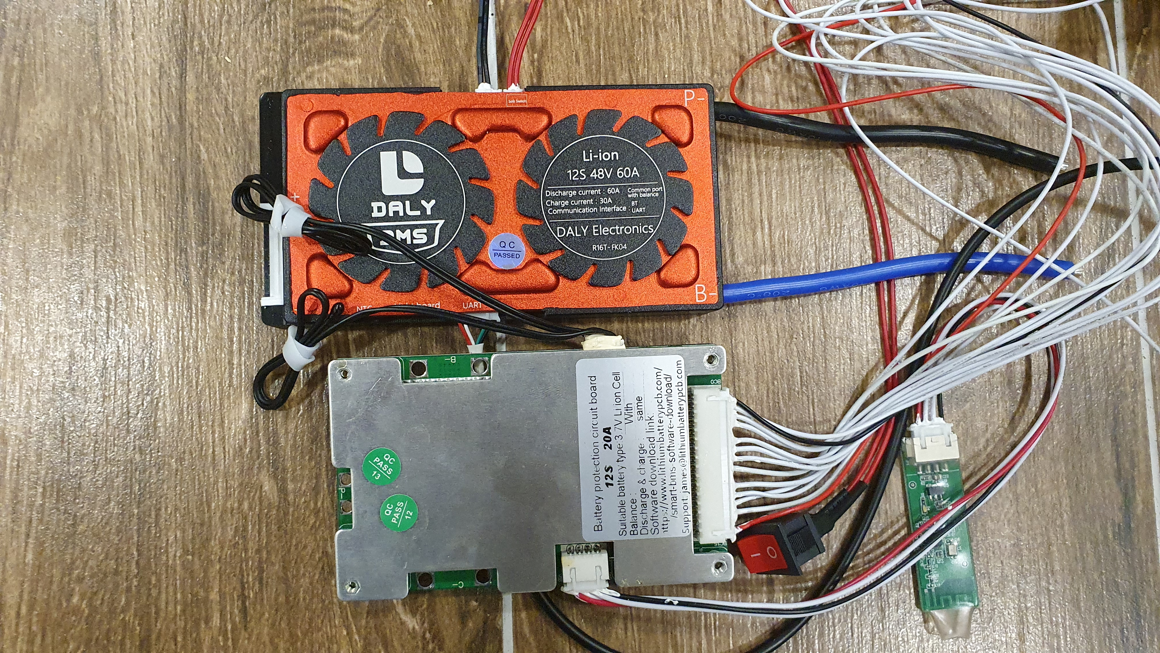

where can I find the APK of this app ?
I don’t have this on my LLT BMS.
You can find it here.
I downloaded the file on the last link called: “APP 3.1” which seems to be the latest version. They ask for a password around when you launch the app, and you can provide your own (though not sure why it’s needed since they don’t even make you put it in when you re-open the app)
I think it’s in the option, probs if someone try to connect to the battery/ change the parameter idk, i’m not sure
Aaanndd…where can I find one? :grimacing:

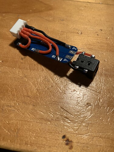

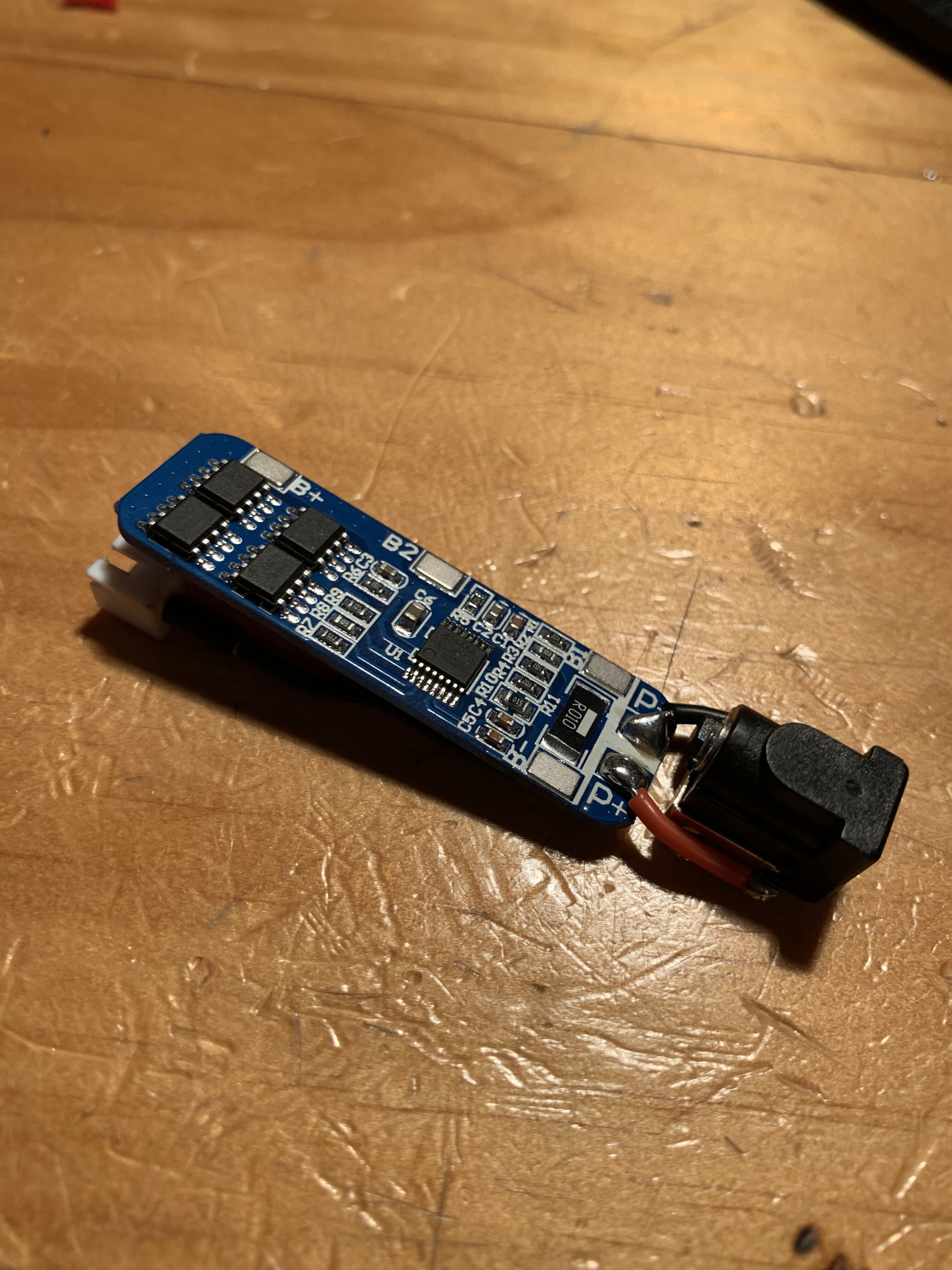

I made a cute 3s charger for my kweld battery, and also added one to the lipo in my airsoft gun for easy charging while at the field… planning on making a low discharge portable 12.6v charger once I get my nickel.

daly on alibaba:

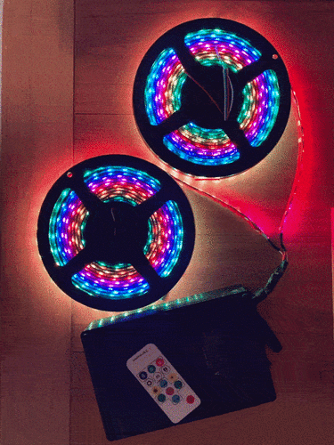

Also I made a 3s4p LED strip battery out of ring doorbell batteries. It cost $0.75 a cell and they are LG D2 which I believe is a 5A 3000mah cell. Perfect application for them. I isolated the P groups then I cut the nickel leaving about 2cm hanging off and soldered to that. Then folded it up, added a tiny BMS and it works. Its going to go on my snowboard so I printed a case with a window for the voltage indicator. Hopefully these strips will last, they are IP65 and have VHB on the back. Last year I did this exact setup but only half of the cells and strips.
(image from last year)
Looking sweet dude, dont forget to post pics of it completed! :grin:

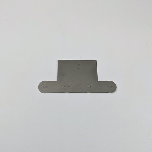

Prepping to build a 12s4p molicel p24a pack, and am wondering what size nickel to use.
I’m also wondering what the good sources of nickel are - are there any go to vendors for the stuff?
What’s the pack configuration?
you want this
12s4p molicel p24a or possibly 12s3p
Either way you want that. if 3p…just cut off extra nickel
thats exactly what i was looking for thanks!
