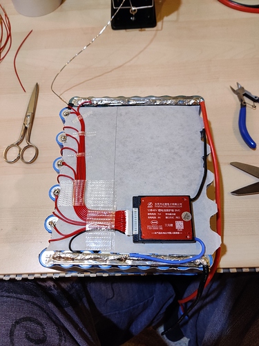

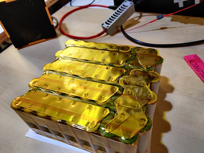

Could one of you be as kind as pointing me to a build or write up that has an exemplary brick style pack.
I’m embarking on my first one.
12s7p p42
Ltt smart BMS.
0.2mm x 30 nickel.
That is as far as I have gotten.

Now this layout makes life very easy, since the p-groups are straight lines. Get some wide nickel (30mm) and you are golden.
Things get a little harder when you have funky shapes of p-groups, such as this:
The way I cheat to make life easier is to still glue together straight lines of cells, even if im glueing together cells of different p-groups. (Notice in the picture below how some cells are the opposite direction from the ones they are glued to).
Then when I glue it all together, im still just pressing together flat rows, rather than trying to stick weird shapes onto the brick.
Let me know if you have any questions! :smiley:
I would like to highlight this step. It’s a bit of a pain, I use the handle of a small screwdriver to mold the fish paper into the valley. I you don’t form fit it the pack will bulge.
I like to use noneadhesive fishpaper for this part
It’s a bit tricky. Because you have to cut it to the right length, then compress the whole pack and tape it so it keeps its shape…but as they say “we haaaave the technology!”
Or use plastic instead of paper
