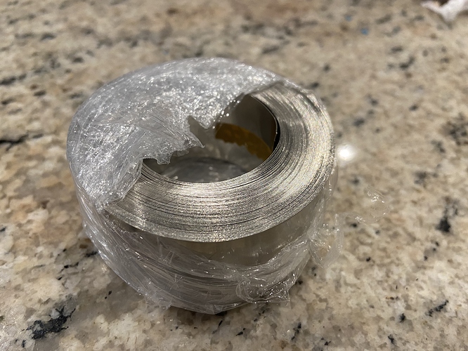

AliExpress gods saw fit to deliver me some 0.2x30mm today.
Huzzah.
