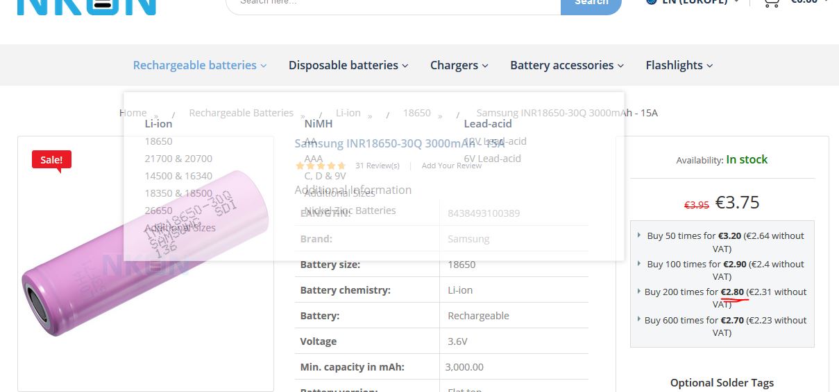

I am confused here…
how do you get such a good prices? 3,90€ for p42a? 2,60€ for 30Q?
They’ll do a custom invoice per email with a bit better prices if u ask nicely ^^
(and pay per bank transfer)
wow, amazing! thanks for sharing your secrets! :grin:
Buy 50 times for 3.93€ without VAT
And this hardly depends on your country I think:
https://ru.nkon.nl/molicel-21700a-4200mah-30a.html
