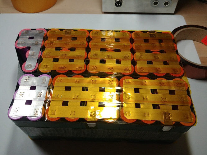

I was just curious how the packs looked under the heatshrink, and more importantly if it would be a pain to swap out the bms. The 10s8p should be capable of 80a continuous, perfect for a 60a build for roommates first board.
Cheapest is not a metric I would use to select a BMS. The job of the BMS is fire prevention.
Bestech BMSs from LiTech are good.
Looks like it’s missing a fuse LoL
Soldering looks great though

It takes time for research and practice. It’s well worth putting pictures up here as you go and people will hopefully steer you in the right direction if there is anything suspect in your process!
Im planning a 12S8P 25R battery, discharge bypassed for the full 160A.
Each cell has individual .15mm u-tabs
8 AWG silicone wire good for parallel and series connections?
should I solder anything to the tabs/ends of the cells to help with high loads? .15mm alone is not good for 20A i’m fairly sure.
How much safer is soldering on top of the nickel strip?
Any tips how I can insulate the top and bottom the best?
I’m putting wide fishpaper over the kapton and then on top the bms
A couple layers of fishpaper then foam between the battery and enclosure
fishpaper for vibration/abrasion
polimide for heat
foam for impact
I did the same. You can use some heat shrink around the balance tabs after you’ve soldered.
Make sure you also cover up the two remaining sides once you’ve soldered your wires on.
While you’re soldering, make sure to cover the site you’re not working on with some kapton or painters tape!
And then also like @b264 said, foam. Pretty sure it’s recommended to use neoprene foam, but I just used some hobby foam. Don’t know how good it is though, but haven’t had problems yet…

Next step for my big boy is to weld balance tabs and power tabs, and fish paper
