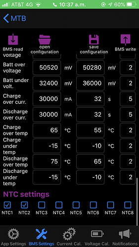

I only have this
Looks good so far. Turn on “balancer enabled” and if you want it to only balance while its on the charger, turn on “bal. only when charging.” Otherwise it will constantly balance your cells, which could eventually drain your pack down to your cut-off voltage (over the course of weeks or months without charging, such as when you are storing your board.)
Also, set “Delta to balance” to 5mV or something like that.
Do I leave the other values ​​blank?
Anything that you set a “Trigger value” for, you have to also set a “release value”
I dot understand
See where it says “Trigger value”? Right next to that it says “Release value.” The trigger value is what causes the action to happen. The release value is what turns off that action.
For example, if one of your cells gets to 4.21v (4210mV, your “Trigger value” for “Cell over voltage”) then the BMS will stop the charging. It will stay stopped until that cell drops below the “Release value.”
Notice in my settings where it says “Overvoltage” and “Overvoltage release”?
in this part ?
No, enter the release value in the column labeled “Release value.” Leave the “Delay” column blank.
Ok so
It’s ok?
Ignore these
Set “Delta to balance” to 5mV or something like that.
The rest looks good.
Thanks brother
Sure thing! It should charge now, and you should be able to see it balancing (if your cells need to be balanced). If it doesn’t charge for some reason, let me know!

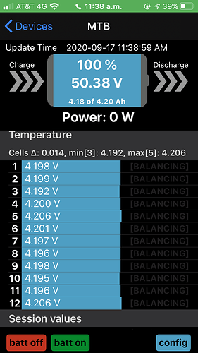

Look

Can I disconnect the charger?
