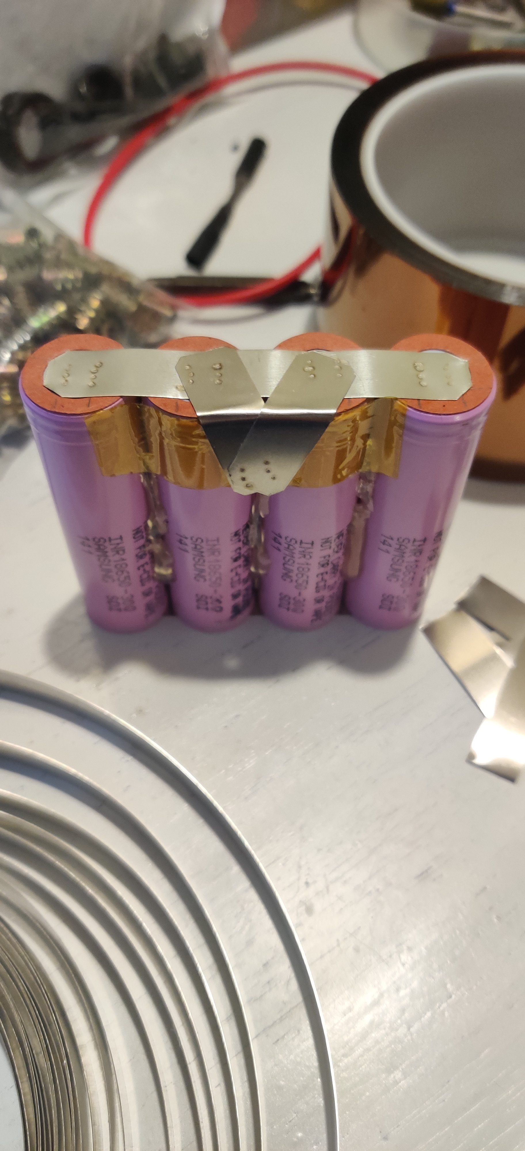

are my tabs looking alright?
Tabs are looking great. But holy hell Batman you need some fishpaper underneath those tabs. Kapton is decent insulation and adhesive for highertemps but not very abrasion resistant. It just takes one tiny scratch and that positive terminal will short with the body of the cell which is entirely negative and sparky sparky boom man
Also, what are you using to glue the cells together? Seems a little yellow
@YeetMeat
I was hoping I could get away with just kapton tape :cry:. Ig I’ll buy some now lmao.
I’m using hot glue, though it’s kinda old an cheap but it seems to do the job fine for now.
I don’t want to sound like I’m hating on you man because I’m not, but please consider this more than just a recommendation because I value your health and safety. Yes, technically it’s not required. Technically, fishpaper on the positive terminals aren’t required. And technically, you can get away just soldering wires on the positive terminals. But we dont these things and actually follow safety precautions and use proper materials to minimize death. Sorry if I seem a little triggered. I just received warning of evacuation due to the fires so I’m stressed lol.
Yeah I gotcha, I definitely don’t wanna start fires or anything. I just ordered some but it comes on Monday :cry:
Once I get the fishpaper on the packs and kapton tape it, shrink wrap is redundant right?
The shrinkwrap is there for extra ingress protection (keeps the big stuff out) and also stiffens up the whole thing to keep bits from shifting around.
It’s not required, but highly recommended.
Don’t cheap out on your battery supplies. Not just cells, the whole enchilada.
You do know to use fishpaper to isolate your P-groups from each other, right? That’s a big one.
Not necessary unless you don’t properly secure your battery pack in your enclosure and things start partying around like Florida at the start of covid. Things will get nasty similarly
But highly recommended
Alrighty, I think I’ll get some shrink wrap and foam too. Thanks for the help guys :slightly_smiling_face:

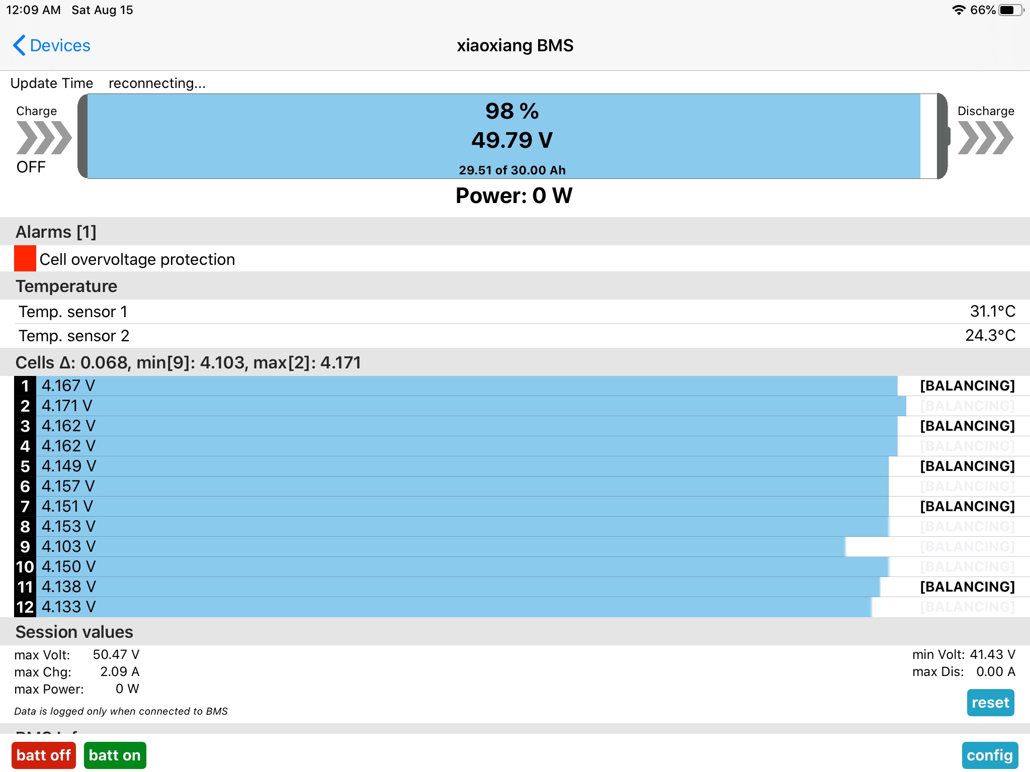

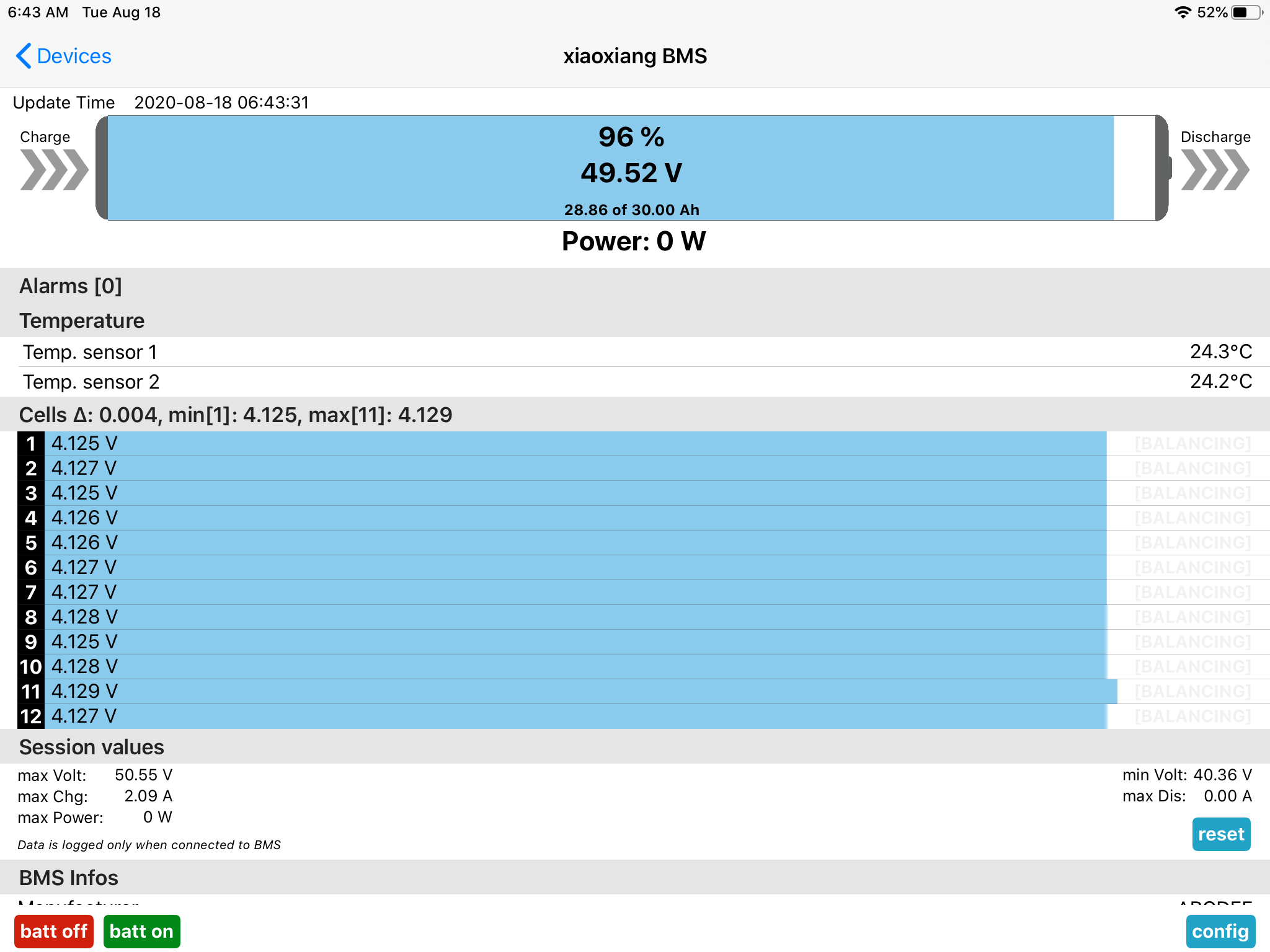

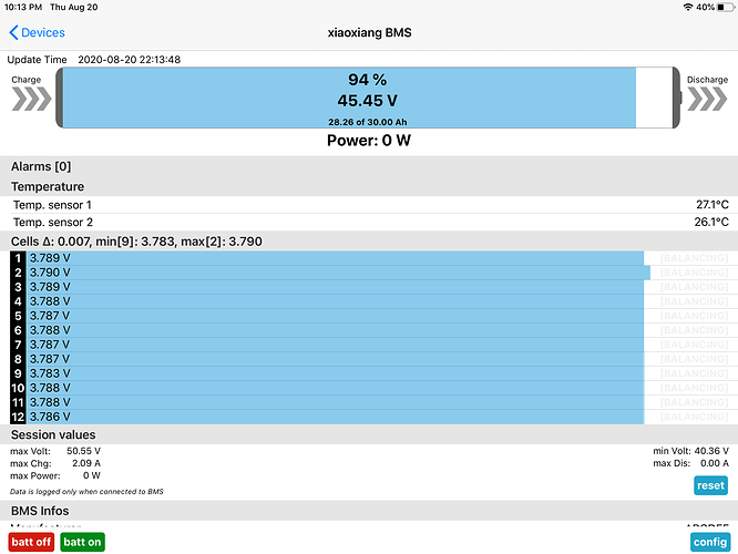

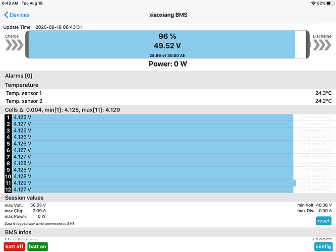

So hey quick update. Setting the bms to balance when not charging worked. Took a few days and a couple charge cycles.
Below are shots of when it was off. And now today before and after a ride.
Awesome, glad that worked out for you and it stayed mostly uniform to what it was before you started riding.
Gotta love the static balance. Best reason to go with a smart bms aside from just the cool app.
