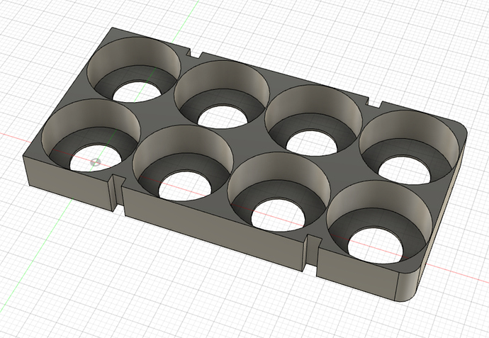

Here’s a little something I would like to use for parallel groups with cell level fusing. The goal is to easily put double stack groups together and have a channel in the middle for either a copper braid wire or a thick nickel strip. Then put a fuse wire between the wire/strip and each cell. Only recently I learned that it’s possible to spot weld fuse wires to cells. Just soldering should also be OK here though.
At the same time I want to keep it as compact as possible, ideally no bigger if I just glued the cells together.
I have made this model some time back when learning the Fusion 360:
I printed it today with my new Prusa mk3s printer. This is actually my first successful 3D print. :slight_smile: I just exported an STL file from Fusion, loaded it to the Prusa slicer and left everything at defaults. :sweat_smile: It came out pretty well.
The nickel strip is obviously just a mock up. This one is way too thin.
The zip tie heads stick out…
… but it’s actually not a problem since there’s enough space between the cells to push them in:
So the top and bottom faces can still be flush with whatever surface they are attached to:
Dimensions:
What do you guys think?
I’m not too keen on putting my life in the hands of a couple zip ties, but aside from that I’m impressed with design and I really want to see where this goes
You could always secure it with tape ex-post. The main value of the zip ties is that they hold everything together for doing the welds.

These look dope IMO. I’m super uninformed and have been curious about cell level fusing–whats the difference here in how the terminals are connected? Each battery is individually fused or what? Advantages/disadvantages?
That looks pretty cool, but if that was mine I would rather do some M3 studding to hold everything together, zipties will fracture under fatigue
Alternatively put a massive radius on the zipties and have the blocks on the corner so the plastic doesn’t bend (take advantage the connection is already 90 degrees)
Nice, these look good to me!

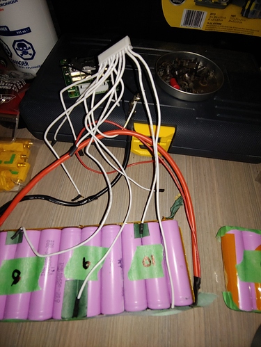

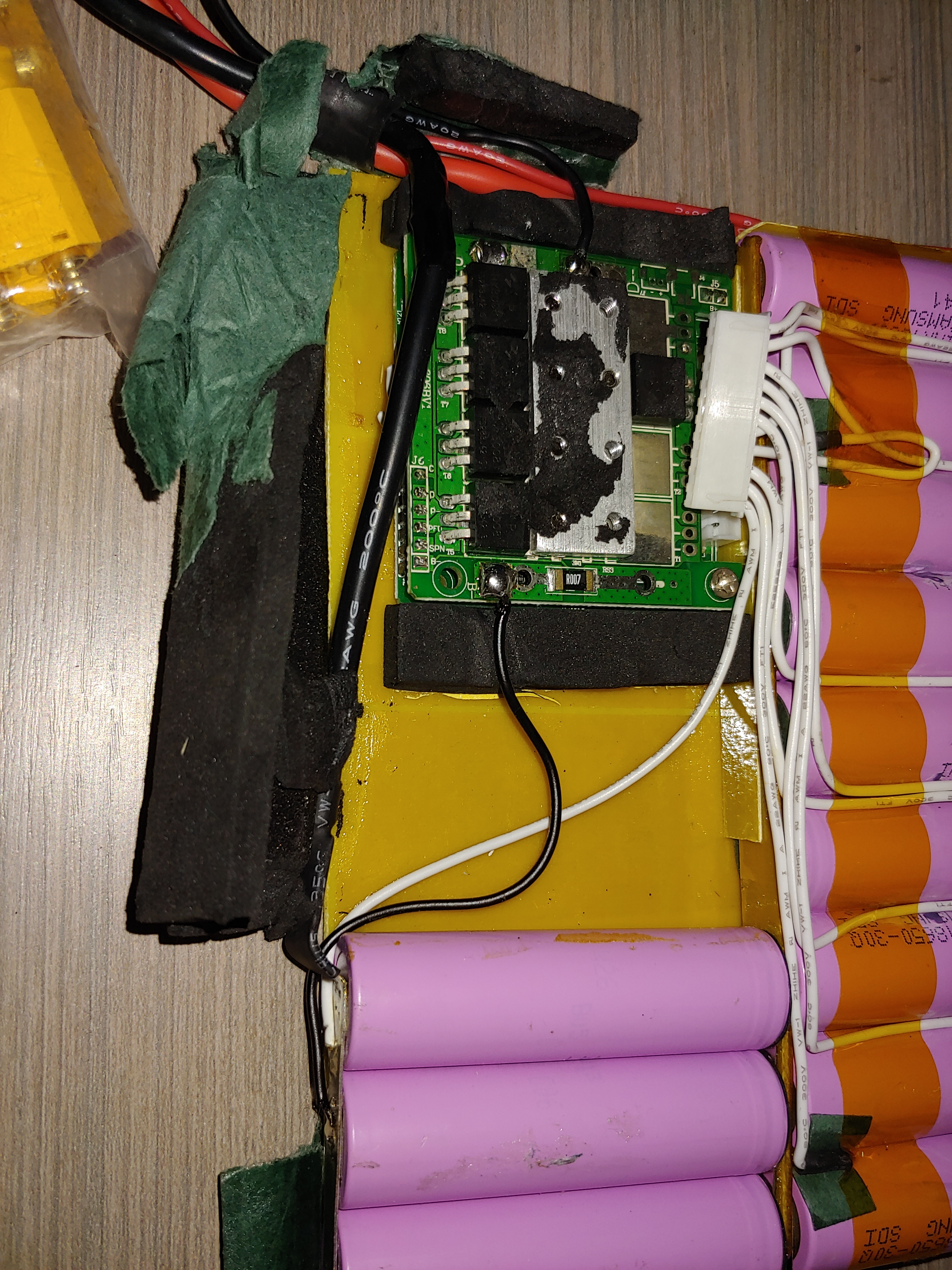

Not sure I follow. Do you mean the wiring itself is incorrect or my labelling of said wiring? This diagram is a reproduction of how the original pack was wired. I took detailed pics of all the balance leads when I disassembled the pack. There are 11 wires going into the bms via the jst connector. Balance 1 (labelled B1) was connected to the main neg terminal. Balance 10 was connected to the neg terminal of cell 10 (B10) and the 11th wire (B+) was connected to the main pos terminal.
Heres a couple of pics of cell 1 and cell 10 respectively:
I can’t see what’s going on here, but it might just be your drawing. if the voltages are correct at the connector, you’re good :+1:
