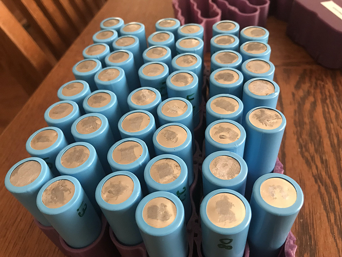

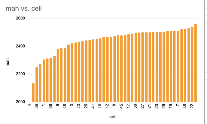

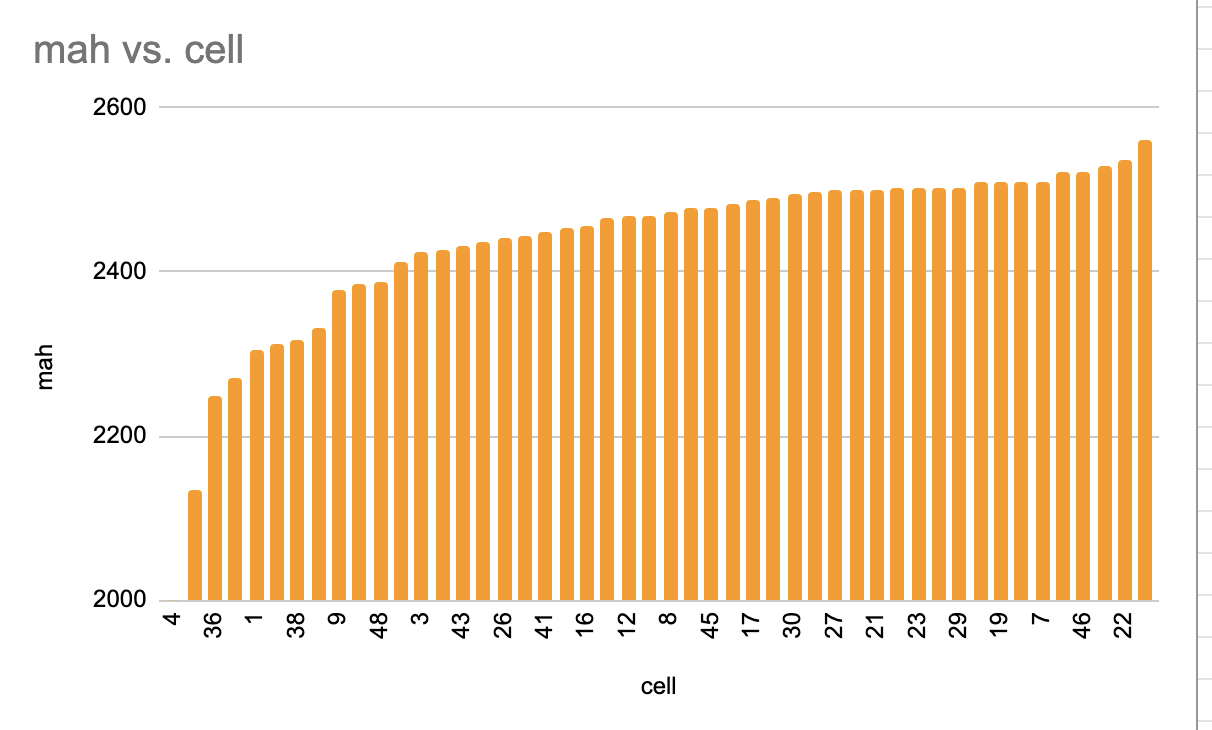

update on set mangled set of 30q.
Mostly for my own going through the motions learnings
I cleaned em up with a dremel.
I rewrapped them.
I did 1 amp charge/discharge tests [ in a “lipo safe” bag away from stuff. ]
both on a tenergy TB6B 1 cell at a time (
) and then on a opus BT-C3100 4 cells at a time.
BT-C3100 ( stops at 2.8/cell in discharge test. seeems low )
TB6B. ( stops at 3.0v/cell )
but combined the two testers didn’t end up sorting the set the same. multiple runs might be required to figure out which if either was inconsistent methodology.
Still not sure how “safe” they are having mangled their neg ends.
but I think they’re still good for practice spot welding. I may try to make them into p-groups. as though I were going to use them in a pack.

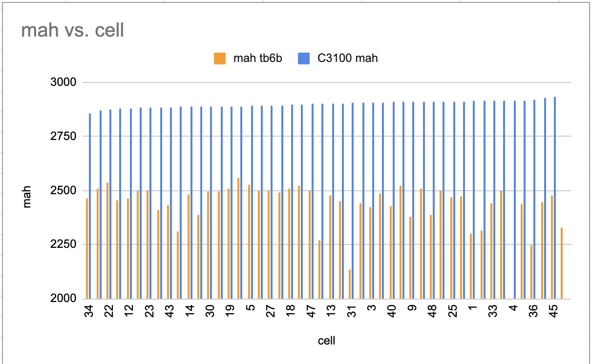

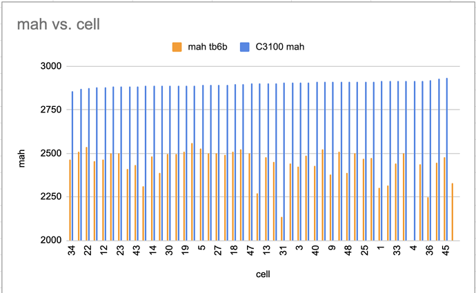

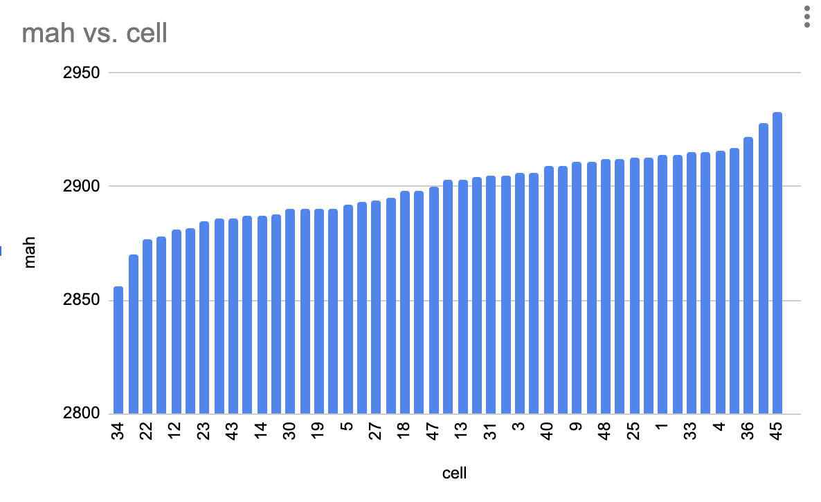

weird, the capacity’s so consistently different among the batches tested between the two I’d imagine one of them is messed up. You should do a capacity test with the same cell on both chargers to see if you get the same value. FOR SCIENCE
those tests are with all 48 cells once each on each charger.
the TB6B discharge test is down to 3.0v while the BT-3100’s goes down to 2.8v so they return different numbers in general. so that’s why i tried to see if they sorted the set the same. and they did not.
oh I seeeee, huh…well I guess the discrepancy makes sense if you account the .2V difference maybe

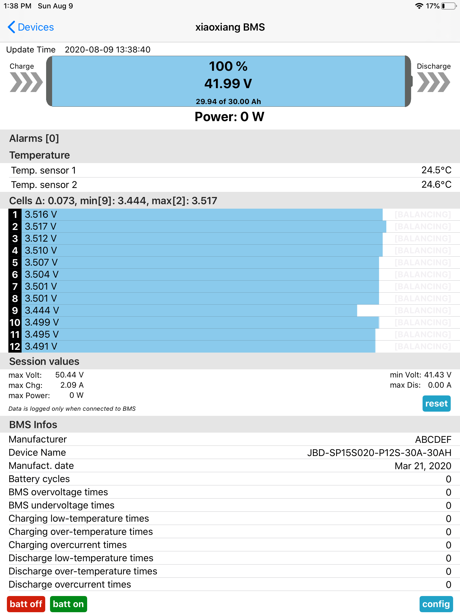

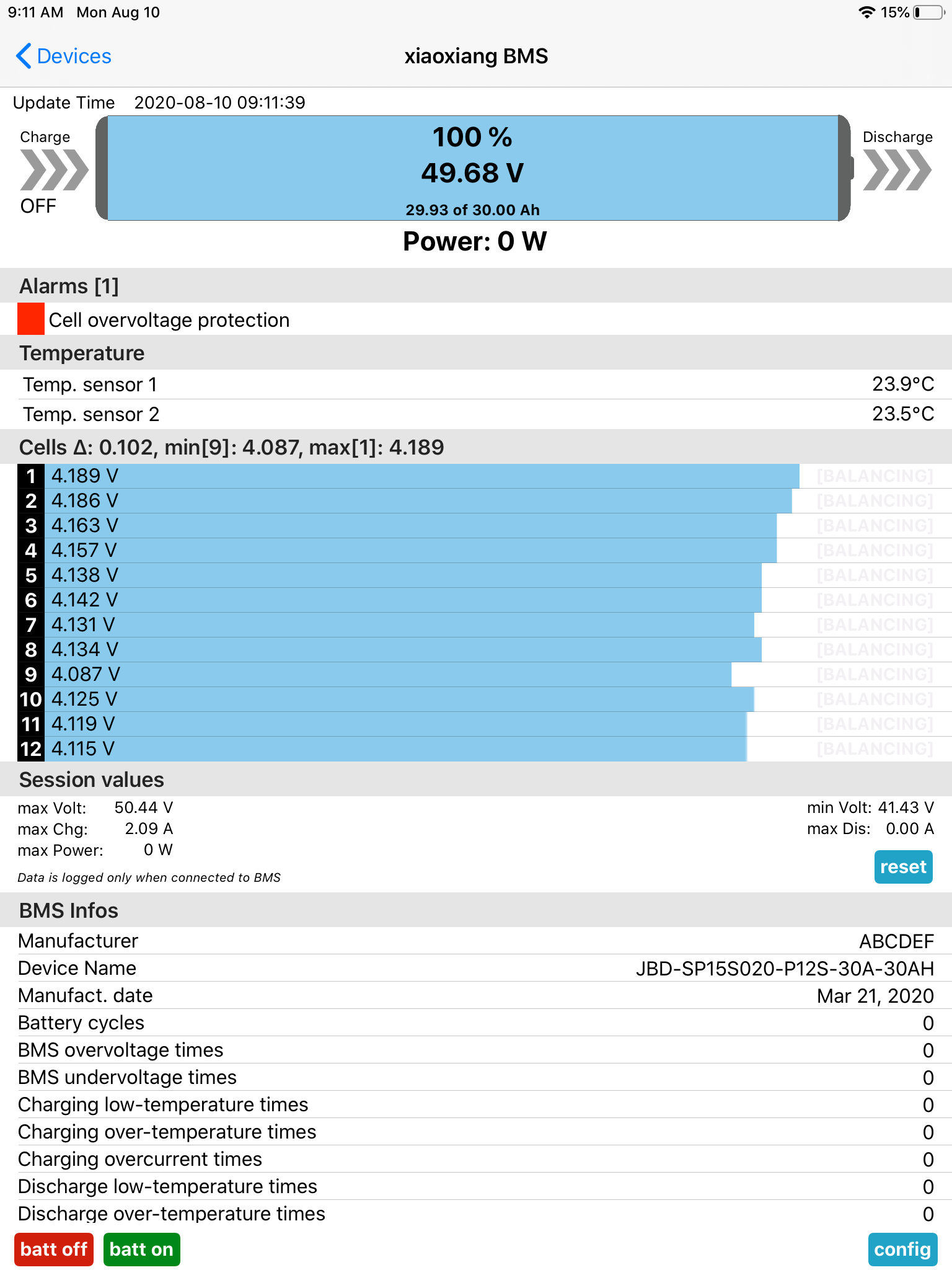

So are the differences in the p groups enough for me to be worried?
This is the 12s4p 40t I have in the Haero
Yeah you deffienlty need to get that sorted out. If you leave it to actively balance it will eventually even them out, might take a week or so. The balance current on these is super low
speaking of this, is there a way to tell if a charger will naturally balance or not? I’ve heard all chargers will balance if you leave them charging after they’re full for long enough. What is the feature of chargers that enables this?
Its the liion charge protocol. All this means is charger will go into very low current mode. Lime .03 amps which allows the bms time to do its work @Scepterr can maybe weigh in on this. But the smart bms has a feature where it will balance without a charger being plugged in

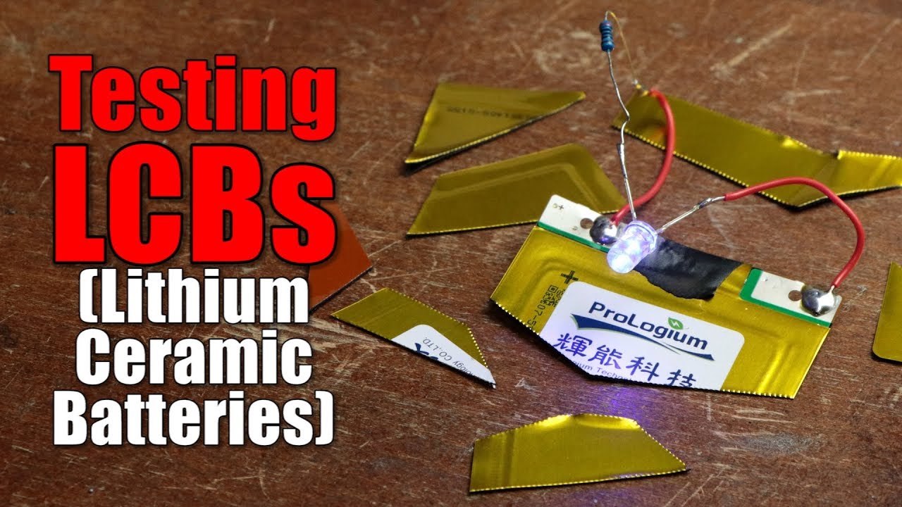

youtube algorithm presented me a video with “new” type of battery that can withstand cuts and puncture without any fire or explosion. it might be worth looking into?
this was the video:
and this is the company that makes the battery:
http://www.prologium.com/index.aspx?02F0EA87FB60FF526BD81D51338B43D5
Personally, I might never be brave enough to build my own battery, but I thought I should still share this with u guys
