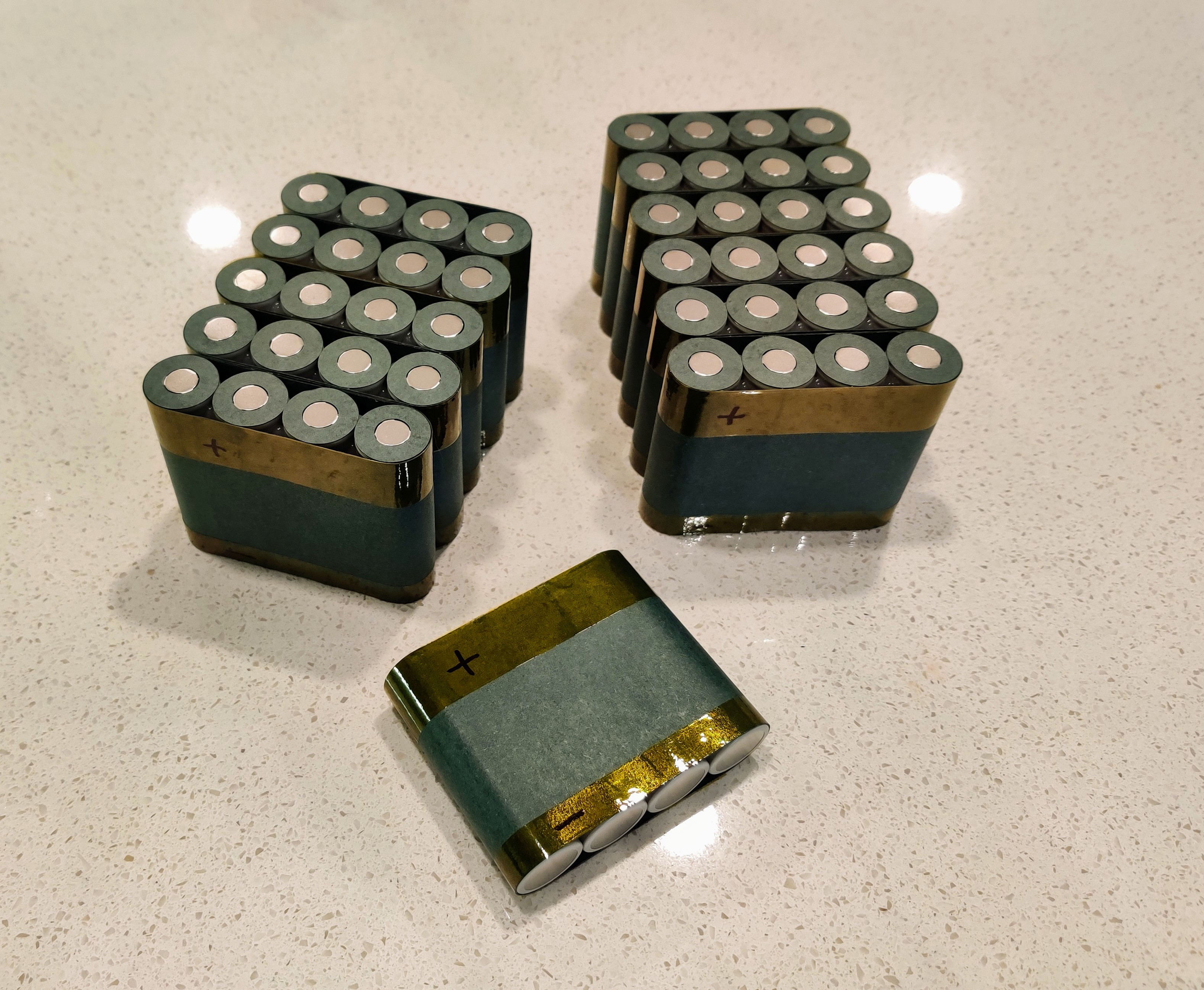

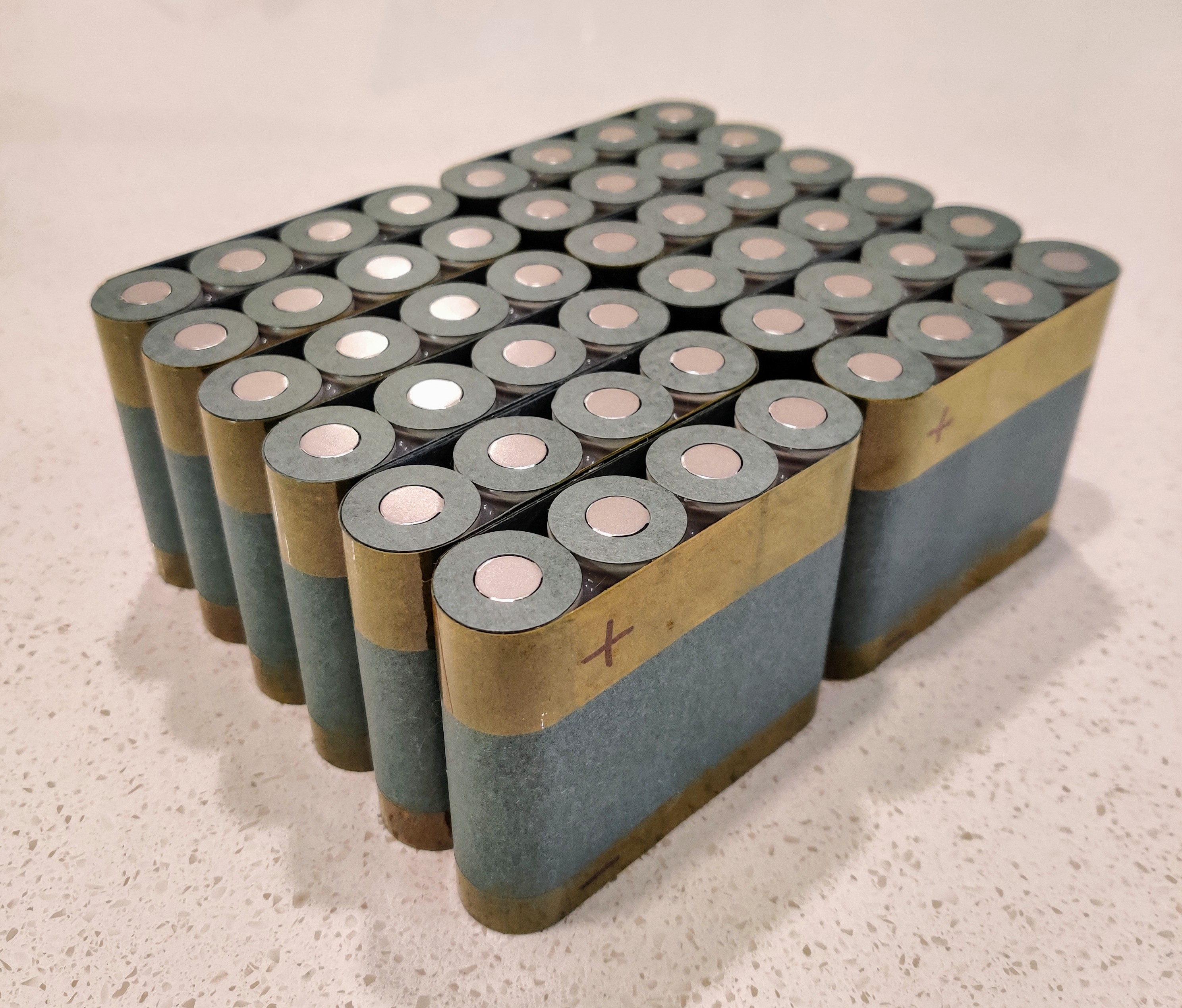

12S4P Molicel P42A ready for spot welding. This will be a flat pack in TB40 deck. However, my AliExpress nickel order is stuck somewhere. Anybody got 0.2x25 or 0.2x30 nickel to sell in the US? I can pick up in Bay Area. @Skyart @KfromtheBay @ZachTetra? Also, comments about pack construction so far are highly appreciated! Thanks!
I am running pretty low myself on that stuff, need to order again from fogstar. Their shipping is pretty fast, last time I ordered, took only 5 days
Wow, that’s faster than I would expect. Thanks for the tip!
Yeah its quick!

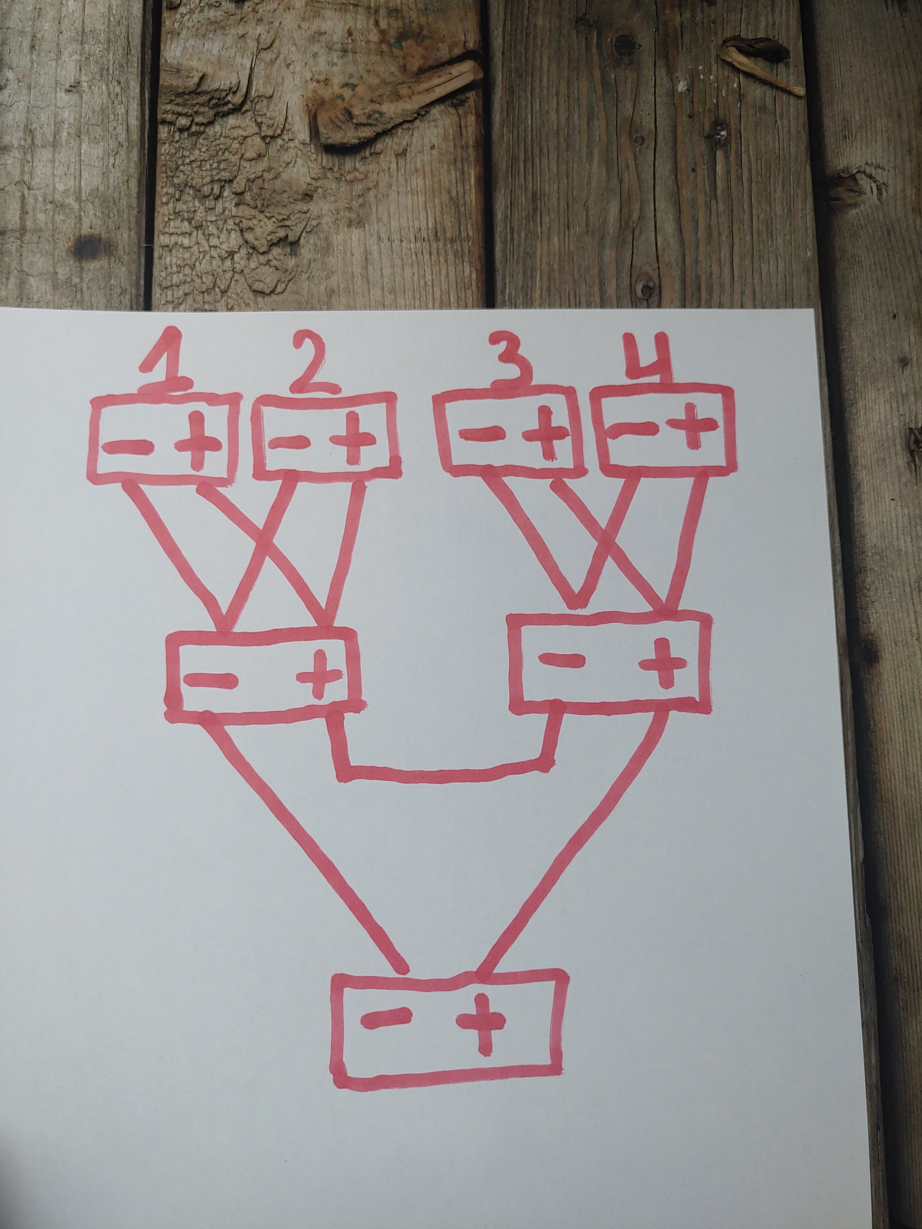

Context:
4 LiPo 6s1p 5000mah
Desired result:
12s2p 10ah
Sanity check:
Also wondering, should I use xt90s connectors anywhere in this?
