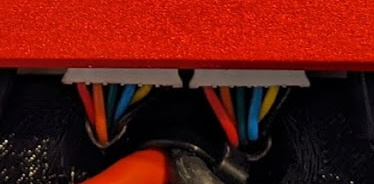

Can confirm that left schematic is correct and also matches the plug on my motors, that also worked on my unity. I think the side exit connector is just flipped.

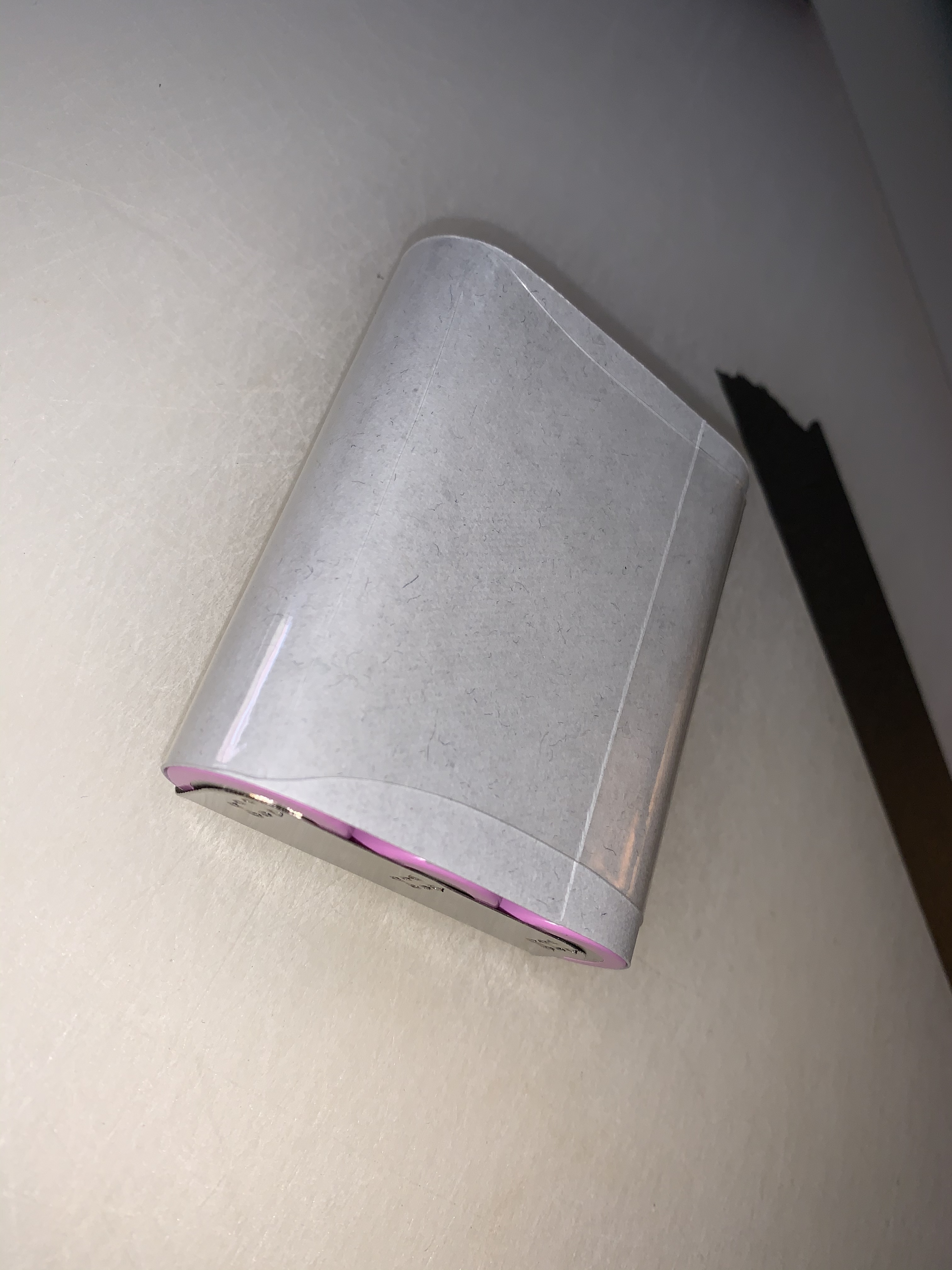

It’s backed by fishpaper. The foam is being used as spacer during assembly. Whole pack is covered by fiberboard top and bottom. And given the cramped nature of the enclosure I highly doubt anything will be moving around.

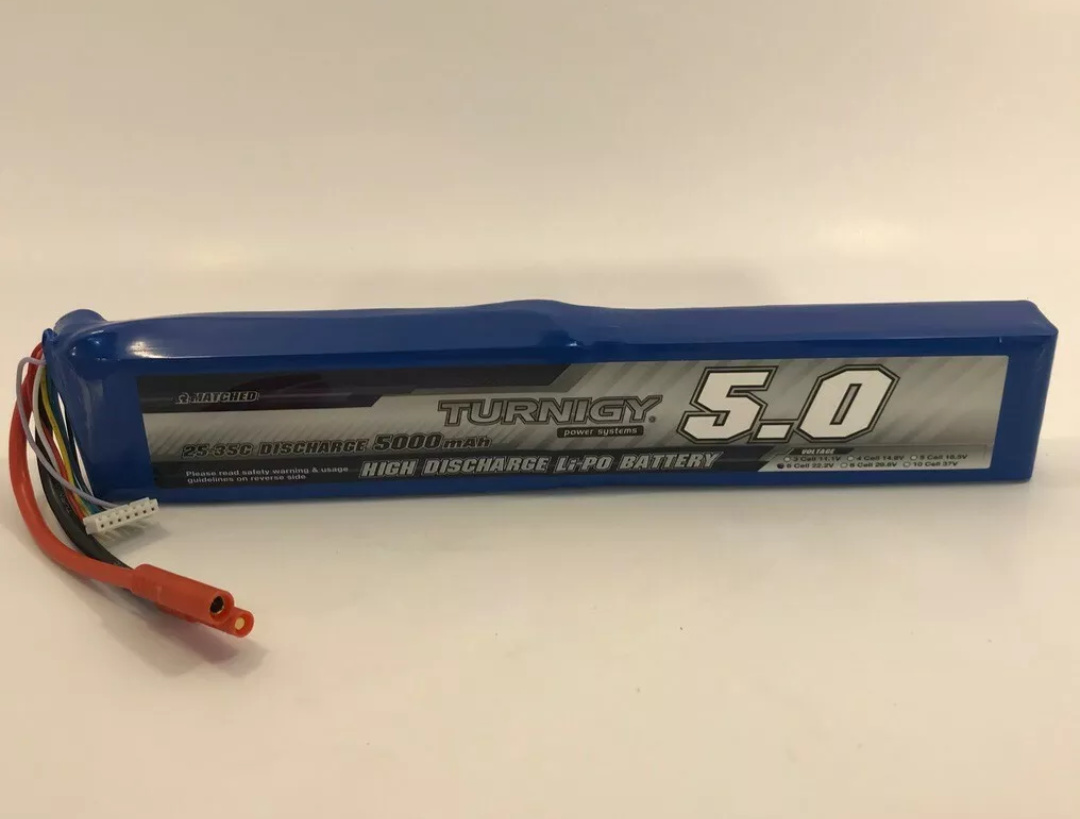

I need LiPo charger expertise.
I bought 4 of these:
They are TURNIGY LiPo 6S, 5000mAh 25C-35C with dimensions of 2" x 1" x 12"
Plan to use them as 12s2p (might break em open to change the layout from long to stacked)

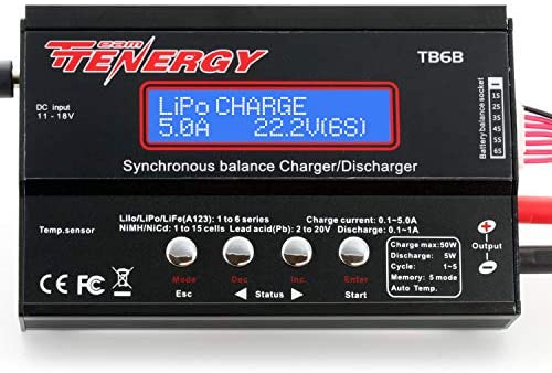

Is this charger any good for em?

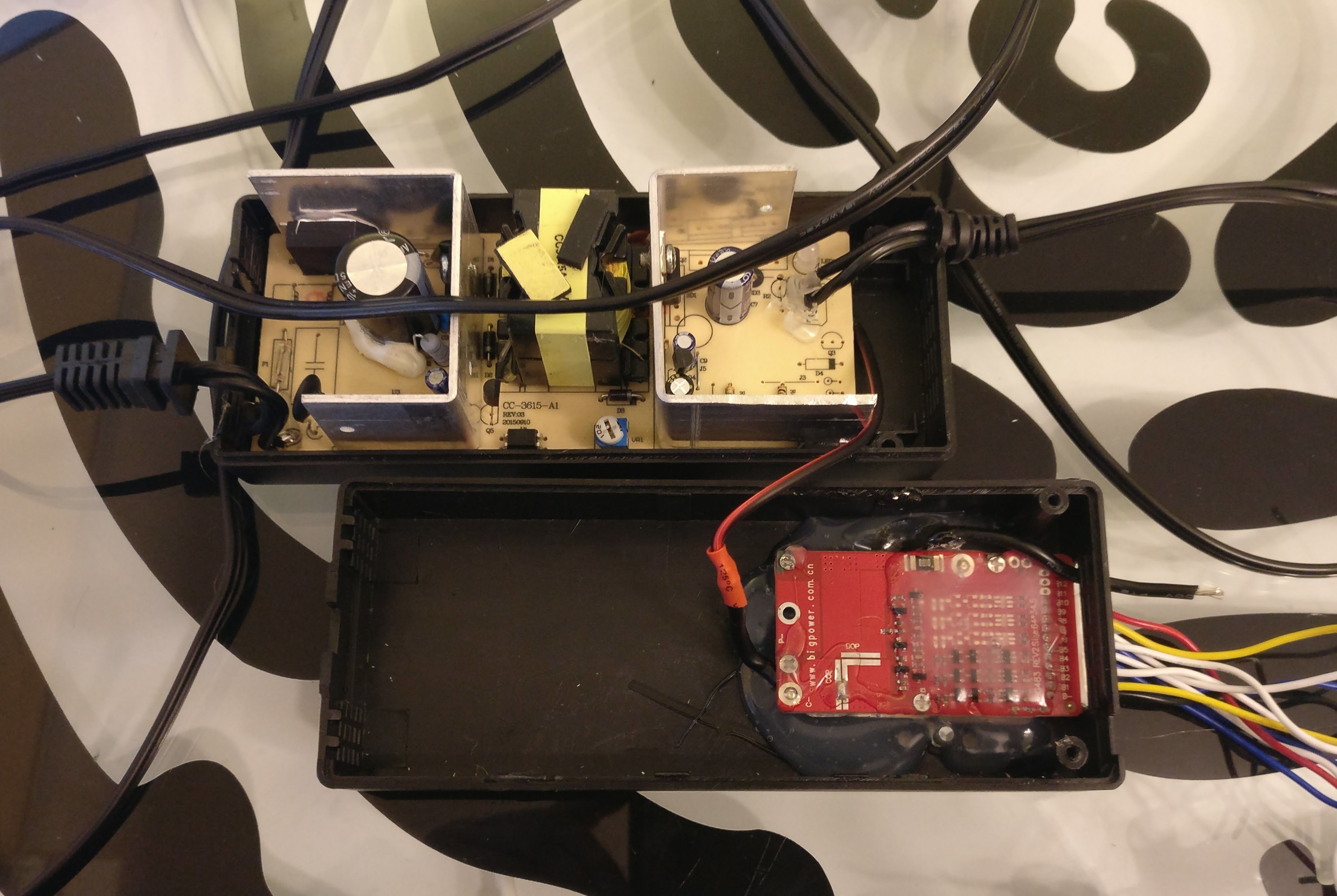

yeah they are pretty good. I’m using that 600W PC power supply now instead of a 60W brick that I just posted last night.
It’s so nice and silent :no_mouth:
It actually got me thinking if you could charge a 3S packs directly from some PC power supplies, they would charge up to 12.08V or 4.02V per cell.

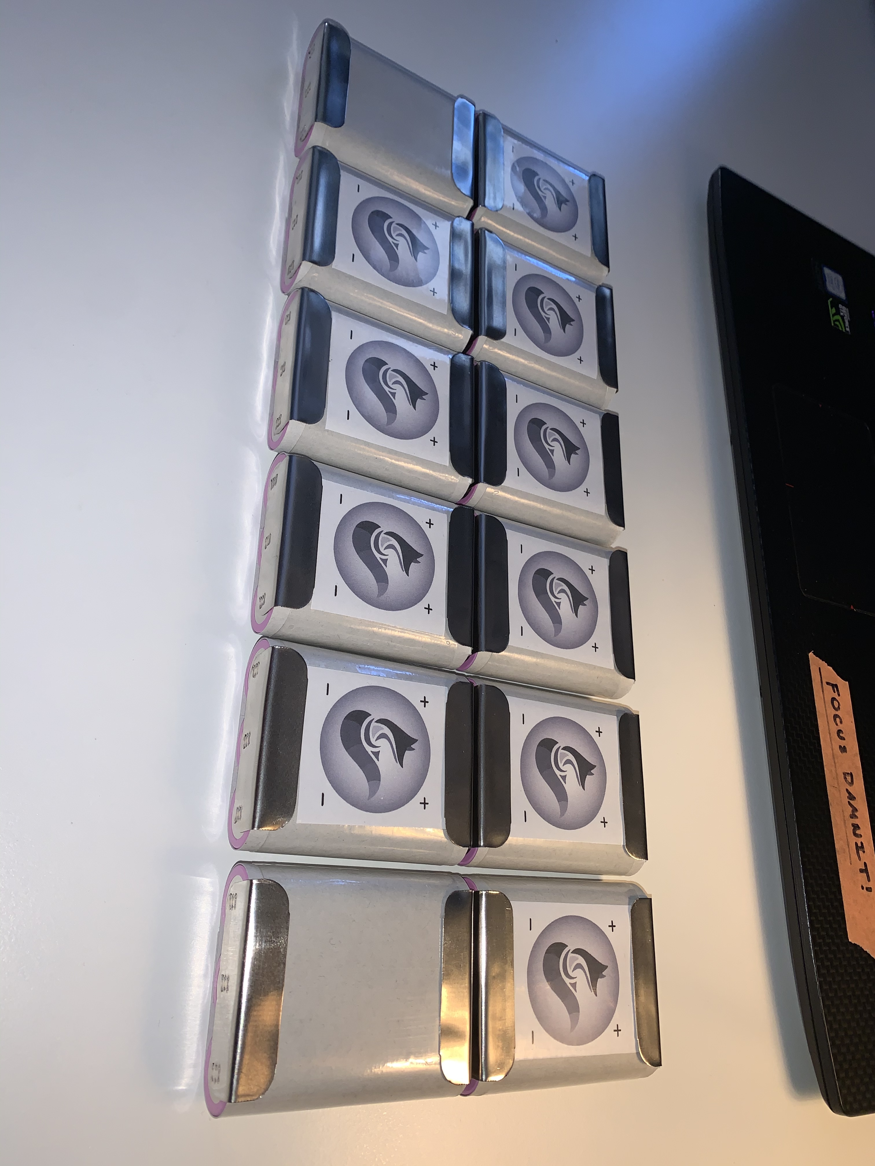

Someone show me a dozen parallel groups that are nicer than these :yum:
V1.1 (couple 1.0) linear layer 3p 30Q FoxBlocks, you saw them here first folks

That is beautiful!
hell yeah, nice work dude. Love the logo
You have no idea how much I like that everything is all shades of grays and silver…the OCD in me is like :relaxed:

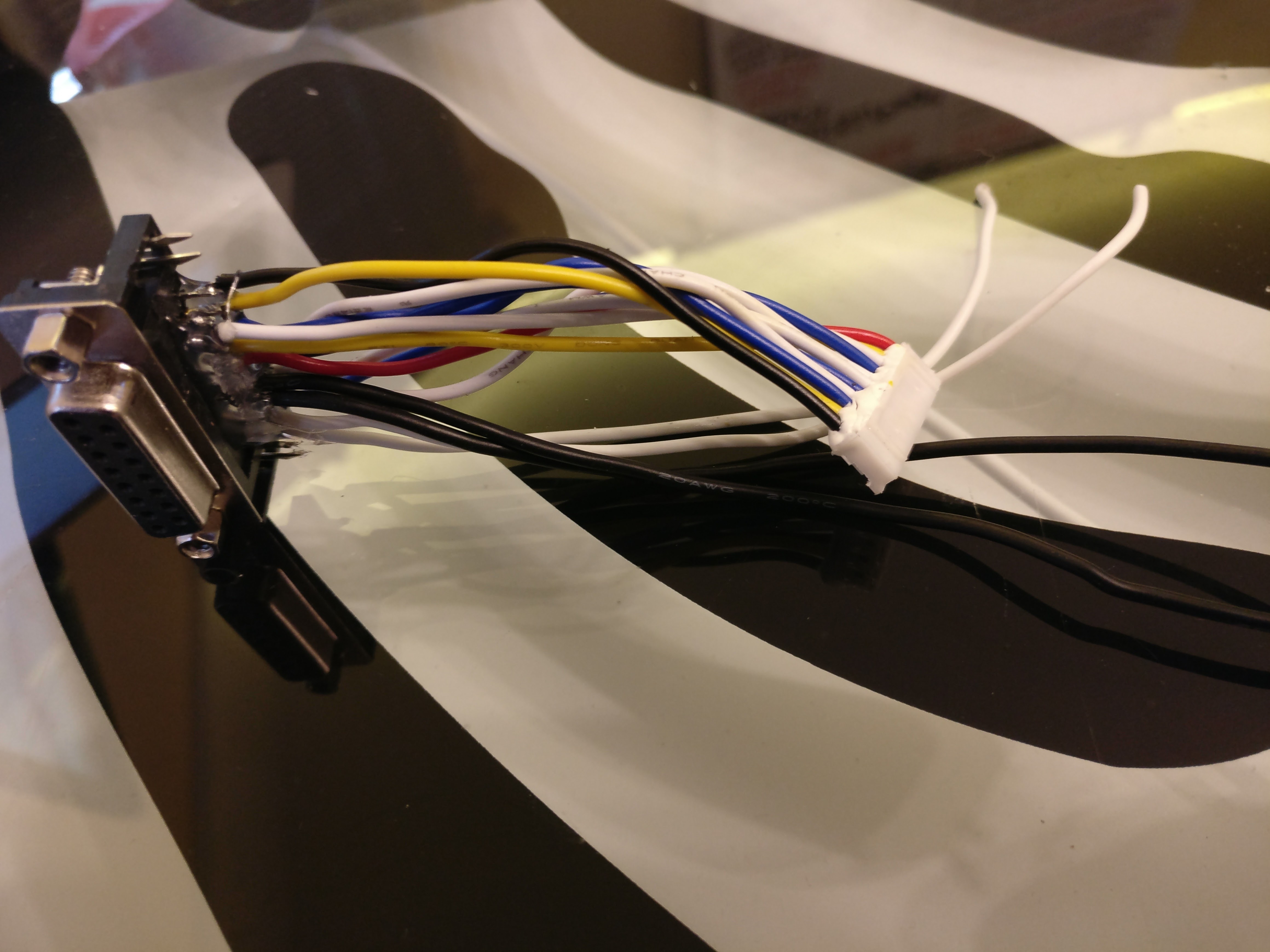

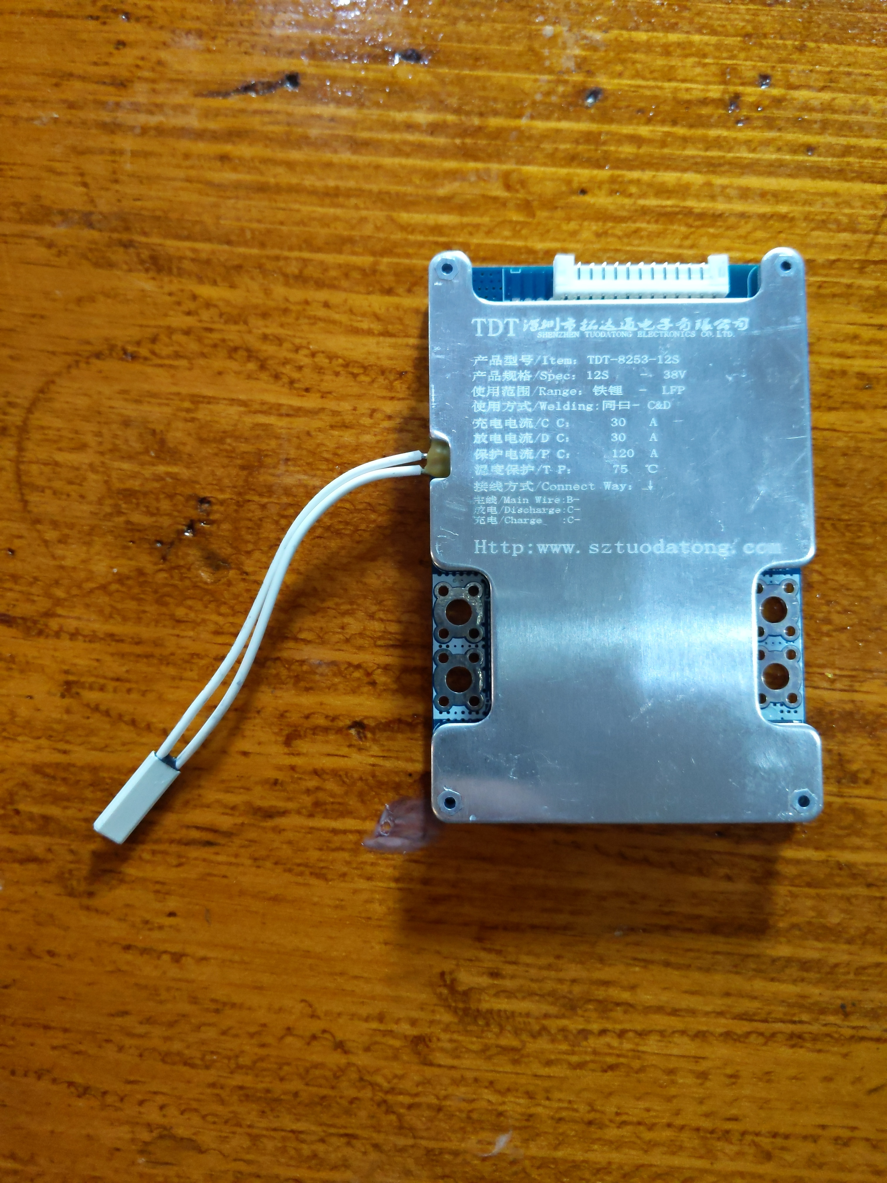

I need a sanity check on the wiring for this balance BMS that I intend to bypass. I don’t have any wiring diagram that came with it but I assume it’s standard as I see this BMS used often.
I know how to wire up the series connections, I just wanna make sure I’m bypassing it correctly.

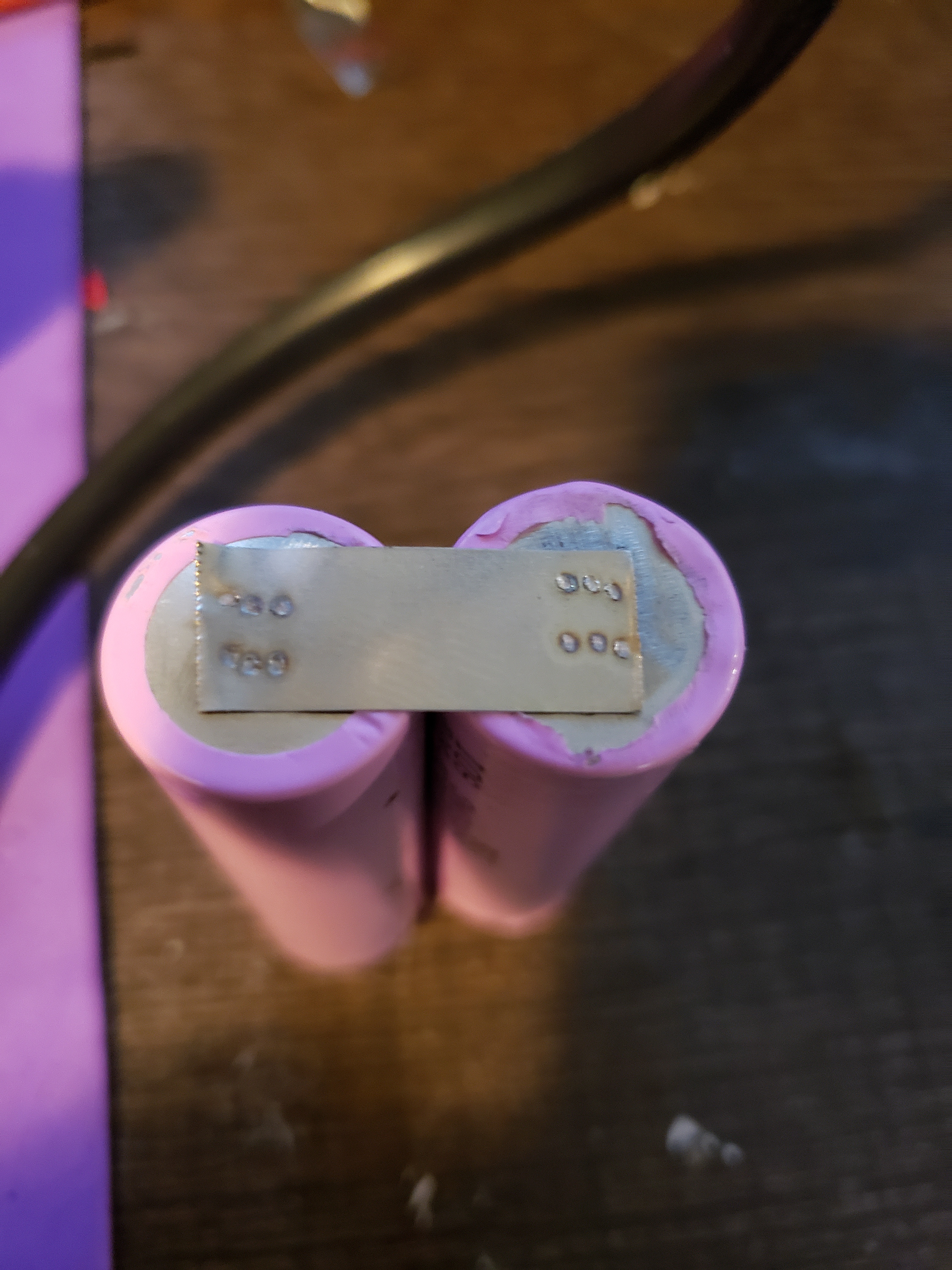

How do these look? 18ms they hold great to pliers
Corners: sharp
Shrink wrap: shredded
Welds: not bad, maybe a little cold? I think your pressure is uneven
Cool. The cells are for test only. Wraps and corners will be good on the 21700s. I’ll bump it up a little and retest
