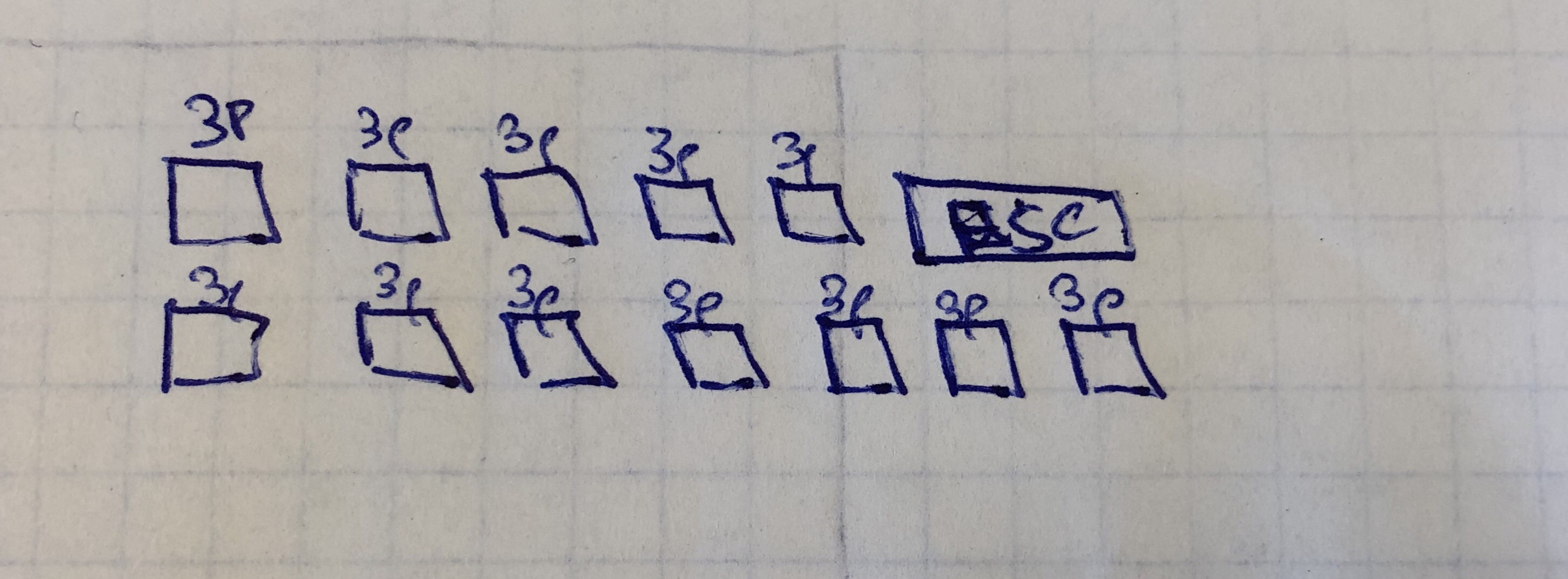

maybe you want to just draw it and post it here how you think it should be? (like, pencil and paper) :wink:
More easy for us to imagine than how you plan to wire it up.
Picture of layout
Why are they in odd groups like that? Got pictures of your batteries?
why you don“t just make 12x 3p packs? that should work as well.
I mean, how you want to balance your layout than? like above that“s going to be a bit not so easy.

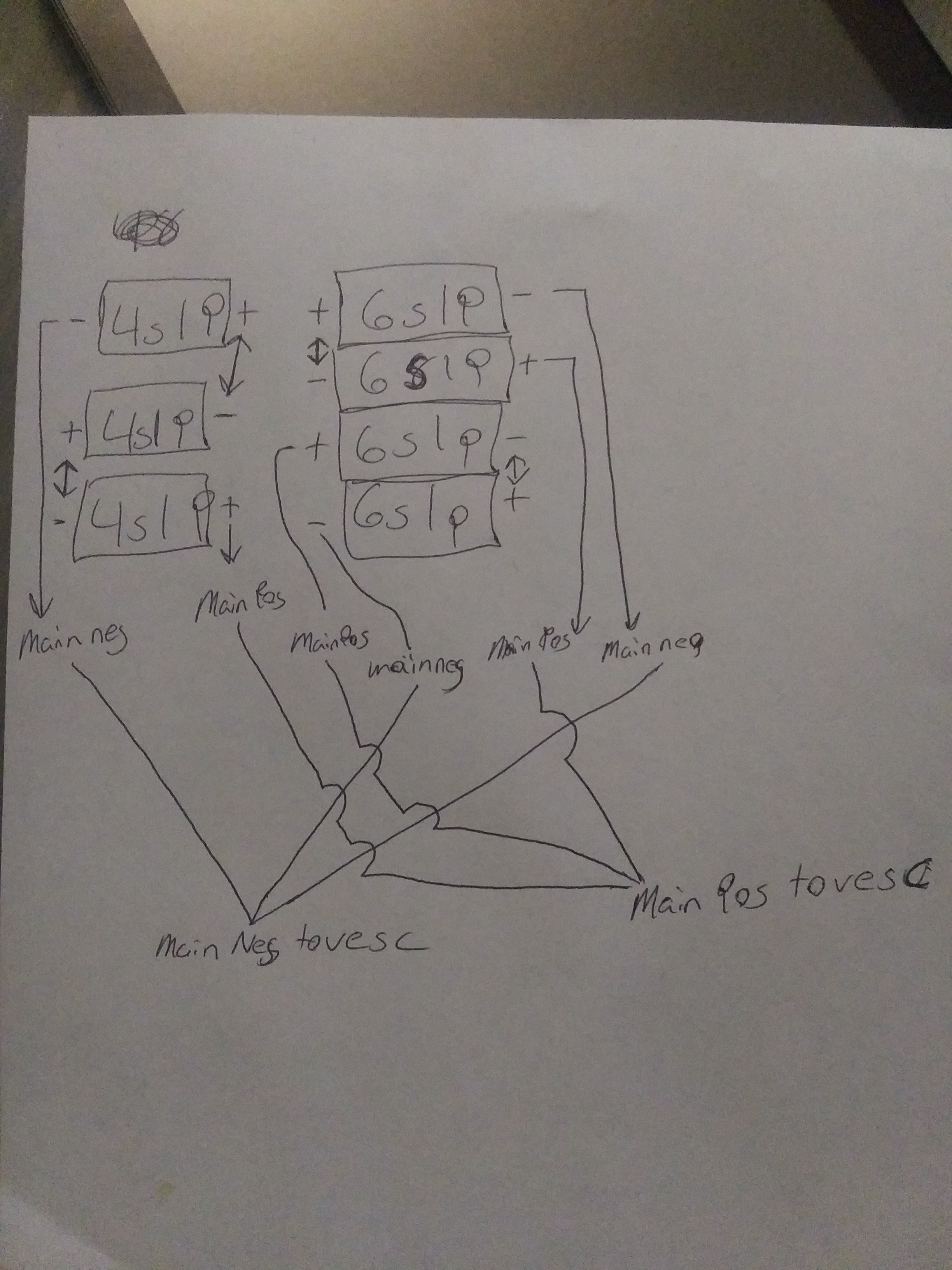

Bit to answer your question, your diagram wont produce a 12s3.
If you series all the packs, you get a 36s (151v).
aren“t compression packs parallel packs and not serial packs?
which compression packs you plan to use?

Hold on! Let me draw you something up real fast. I just realized something lol
it would be new to me that winflys modules are serial packs. that would not make sense at all as it would make balancing super difficult. i would have one more look into it on your place.
just get 12 3p packs and you good.
Here is how it will have to be wired for 12s3p. Ask question before you attempt to make sure you understand whats going on.
you can split one 3p into 2p and 1p form one side to the other. it“s more easy than to make s count packs. really, how you want to balance the s-count packs than? you would need a balance wire for each cell. you also would neet to cut the braid or what ever is the latest material into 2cell strips and islolate them form each other. that“s not gonna work well.
I“m sure if space is the issue, than all the wires he would need for this set up will not work as well. just a thought on the side.
I didnt say it would fit lol. He just wanted to know how it should be wired up lol
if you can fit it like the picute above, you can fit it also by using 3p and just split of one to 2p and 1p. just my 2ct…
