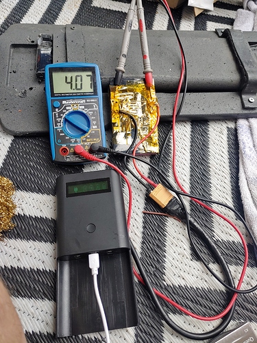

My suggestion would be simple (if possible)
Remove the group from the pack and bleed it manually to the same voltage as the others
when it’s saying over voltage do you see that cell 3 pgroup close to 4.2?
Any evidence it’s just slowly being bled over to the other cell groups but it’s bumping into 4.2 and causing the BMS to cut the pack charge?
At what voltage does the bms start balancing cells. any evidence that it’s doing so?
How did that one Pgroup get so high? were the close to begin with? does it have less capacity than the others?
no need to remove from the pack.
you can bleed and charge 2-3amps safely through the balance leads. I do this all the time
@iamasalmon and you mofo couldn’t tell me this before? :joy::man_facepalming::sob:
:cry:
Not directly. It stops charging the whole pack, and drains down the offending cell/group, then resumes charging. The BMS has no way to selectively not-charge a group, only discharge.
Only on BMS’s with active balancing. Most just take the extra charge and turn it straight into heat with a resistor. Much cheaper and simpler and smaller than trying to shuttle the extra around to other cells.
Volt measurements so I can match the cell voltages for the P group cells
thank you… In my mind power was bleeding from a high volt cell to a low volt cell… I appreciate the knowledge, and the explanation
No problem, knowledge is meant to be shared.
There are some BMS’s that do active power transfer, but they’re usually reserved for very large battery systems like powerwalls or EVs, where there’s a significant amount of energy to be saved from becoming heat, and the extra size and cost don’t have as much of an impact.
