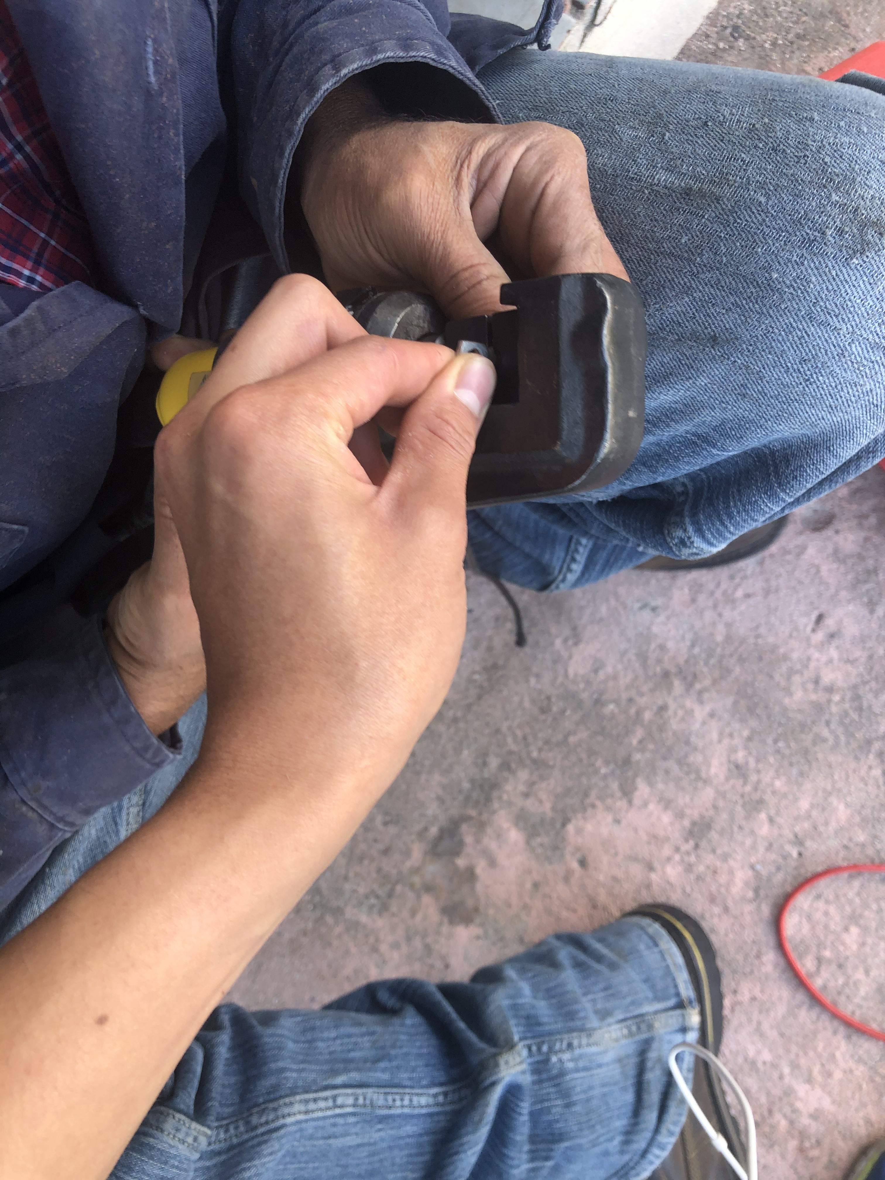

and if I don’t have that what can I do, directly weld the tabs?
you mean solder? idk if it sticks yeah but you’ll need a soldering iron with a big thermal mass
Get a screwdriver and a hammer. Shove the wire into the lug. Put the screwdriver near the end and hammer down just until the wire is held in. These turn over and do on the other side. Now once its held in, lightly hammer the rest of the lug until the wire is VERY firmly held in place. Don’t just smash the lug repeatedly, you’ll break it. Just hit enough to get it to deform
Pliars and a rubber band should be able to hold onto the crimp. Hold the soldering iron to it for a whole and ‘fill’ the hole with solder. Insert the tinned wire and wait for it to all melt together
I read a bunch of the net on crimp vs solder vs crimp and solder I came away thinking opinions really vary.
If you have a blow torch you might be able to use that to help heat it enough for the solder to flow. But would probably be easy to over heat it and mess it up.
If clamped down with enough force, crimping will be more than enough. The wires need to be squeezed into the space as tightly as possible to allow for maximum current transmission
thanks everyone i was able to get the tongs with my uncle
