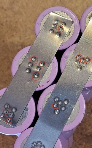

Yeah, definitely a little hot. A few of these holes look like you blew through the nickel. Did you do a pry test to see how strongly adhered the nickel is? Could be from too much power, dirty leads or not enough pressure when welding.

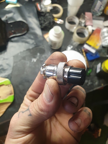

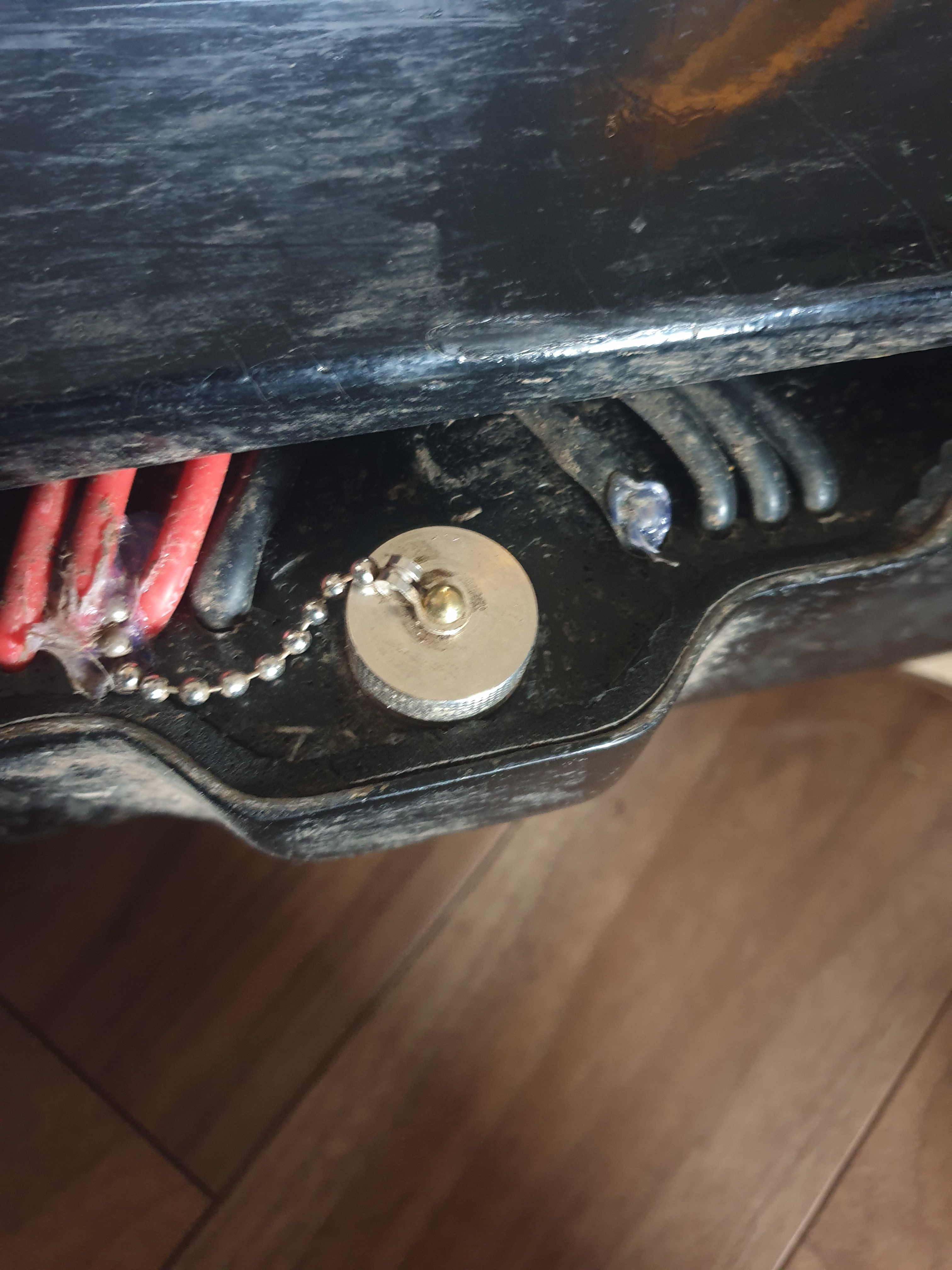

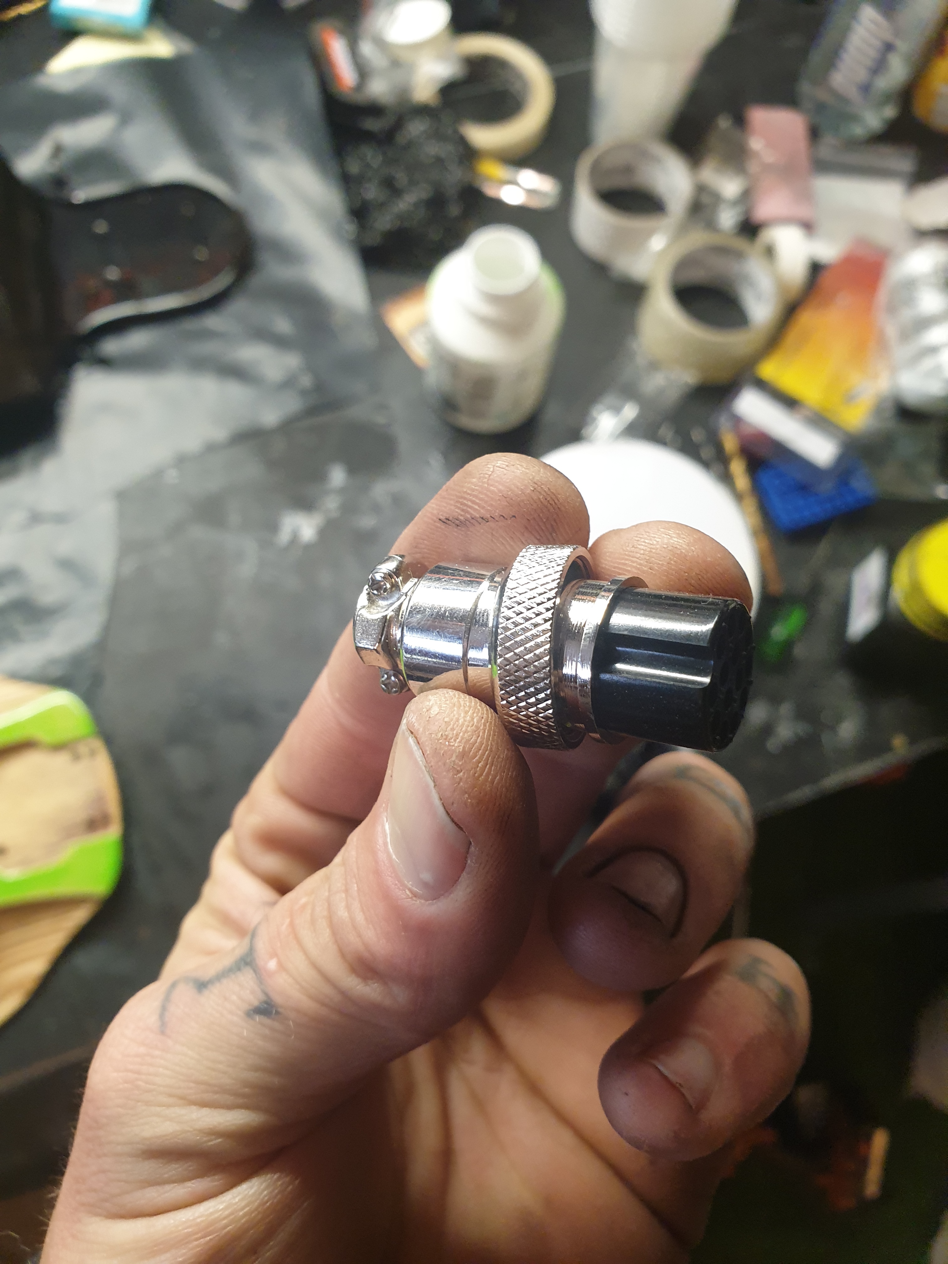

Yeah bro, i use a 14 pin gx20 connector :+1:
The only thing I don’t like about it is that the pins are boardside, not plugside. Shorting the balance port is not fun. But I added some extra protection with a silicone cap that i had for my vape, it fit perfectly :rofl:
Why not use female sockets there?
As far as i know, the gx plugs only come in this orientation with the male on the panel mount side, female on the plug
Ah ok. Shouldnt be impossible to find the right thing. Must exist :grinning:

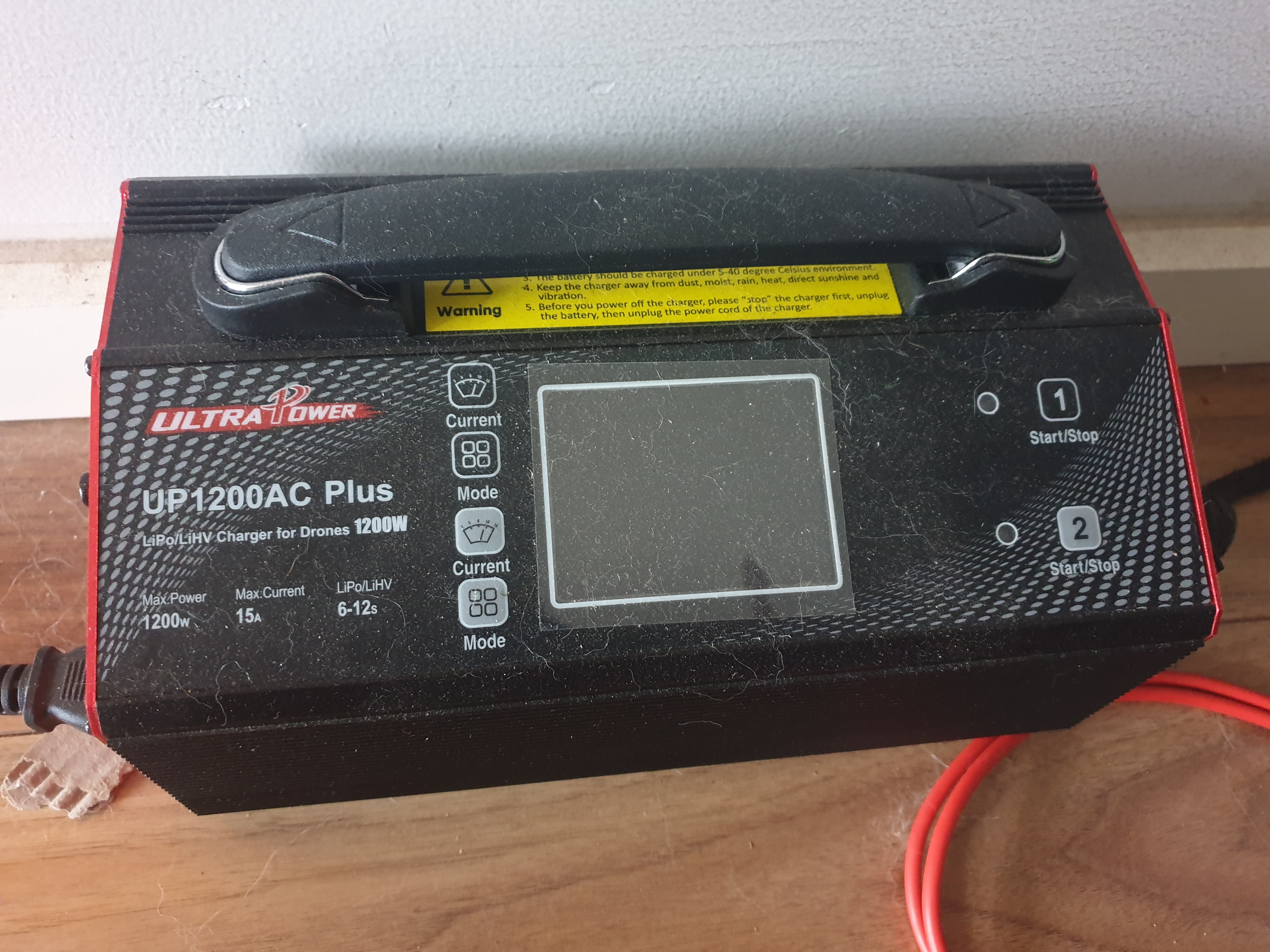

What charger did you buy
That looks like a problem you can fix with JB Weld
UP1200AC Plus. Its a beast. I got it from aliexpress
Dayum that’s big
Yeah, you don’t wanna be carting it around. But there’s nothing wrong with just using a brick charger while you are on the road, just make sure you don’t overcharge.

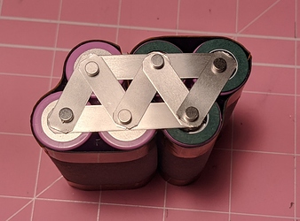

Does this look fine for my 12s3p pack? Nickel is 8mm x 0.15mm.
Looks great, make sure to spot weld one piece of nickel at a time, most welders have a hard time going through 2 pieces of nickel stacked

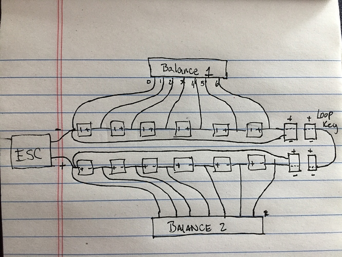

Resistance is inverse add in parallel, no? So you should be seeing 1/ (1/.0221 + 1/.0221) which gives you 0.01105 ohm and with a voltage difference of .05/.01105 = 4.5A. Therefor, anything higher than a .25V delta seems to me to be unsafe.
In this case you need to think about them as being in series. I can draw a pic when I get home in an hour.
Here is also a good link with pretty much the same equation I used: https://physics.stackexchange.com/questions/64509/different-batteries-connected-in-parallel
