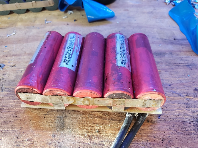

Finished this pack up past few days 10s5p of 40T. Old pack got water damaged and had a cell melt down (-.11v on that P group, no I don’t know how that happens).
Well that’s no good, anyway, have some battery beauty shots.
Double wrapped (first in blue, then in clear). 3rd wrap layer after it’s installed and soldered. Trying to make this battery a bit more waterproof than the last one, this customer likes riding on the beach and CONTINUALLY brings me his board after it’s gotten wet. The less I see of this board the better.
All wired up and manually balancing each cell.
Final shrink wrap and glue down. Charges perfectly, balanced, perfect. Very proud of how this one turned out with great welds and much improved soldering. First time working with battery PCB’s, and I gotta say it’s the way to go for flex packs. Sadly my next project is just a massive brick for a scooter so I’ll miss them.

Wooden blocks are shortened battery jigs. All nese tabs are now glued in!
@Scepterr
Isn’t this a huge design flaw? All the current flows through these small traces
Or am I missing something here? (like copper braid connecting the tabs properly)
Thin stuff over a very small lenght can still transfer a fuckton of current
And you could probably put a piece of copper on the other side
yeah but that section is wayyy thinner than the connection on the right side of the pack.
There is gonna be some losses with 60 to 80 amps continuous flowing through that…
It’ll probably be just fine but it’s not ideal
Current will flow wheres less resistance, if you put copper on there it will go through it and not through the slim pcb traces
yeah i know but there isn’t any braid on the nickel or copper reinforcing the traces. To my understanding this will be an easy and fast way for tb to build their batteries. Reinforcing traces or putting braid on the nickel would cost more time and therefor wouldn’t be done (probably)
the simplest fix for this problem would just be bending the nickel tabs the other way over each other and then solder them togehter on the pcb
