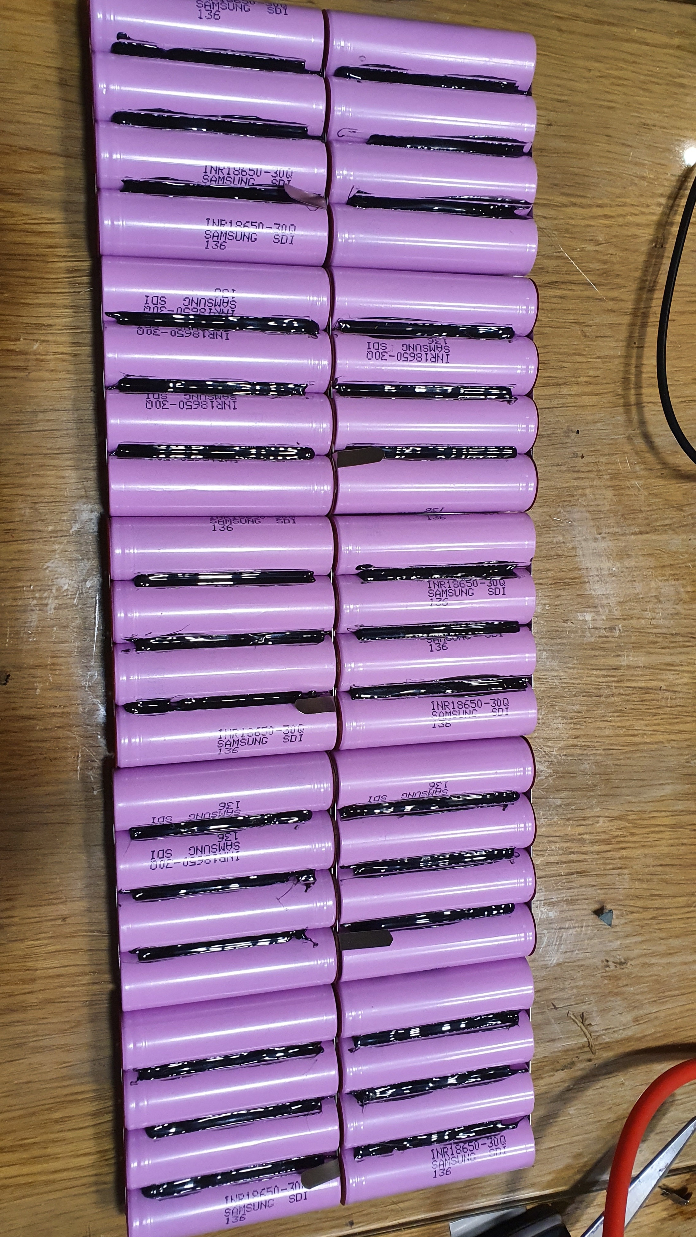

Ok… another beer for me… Just realized I glued a cell upside down in the middle of the pack and have to do some magic to fix it

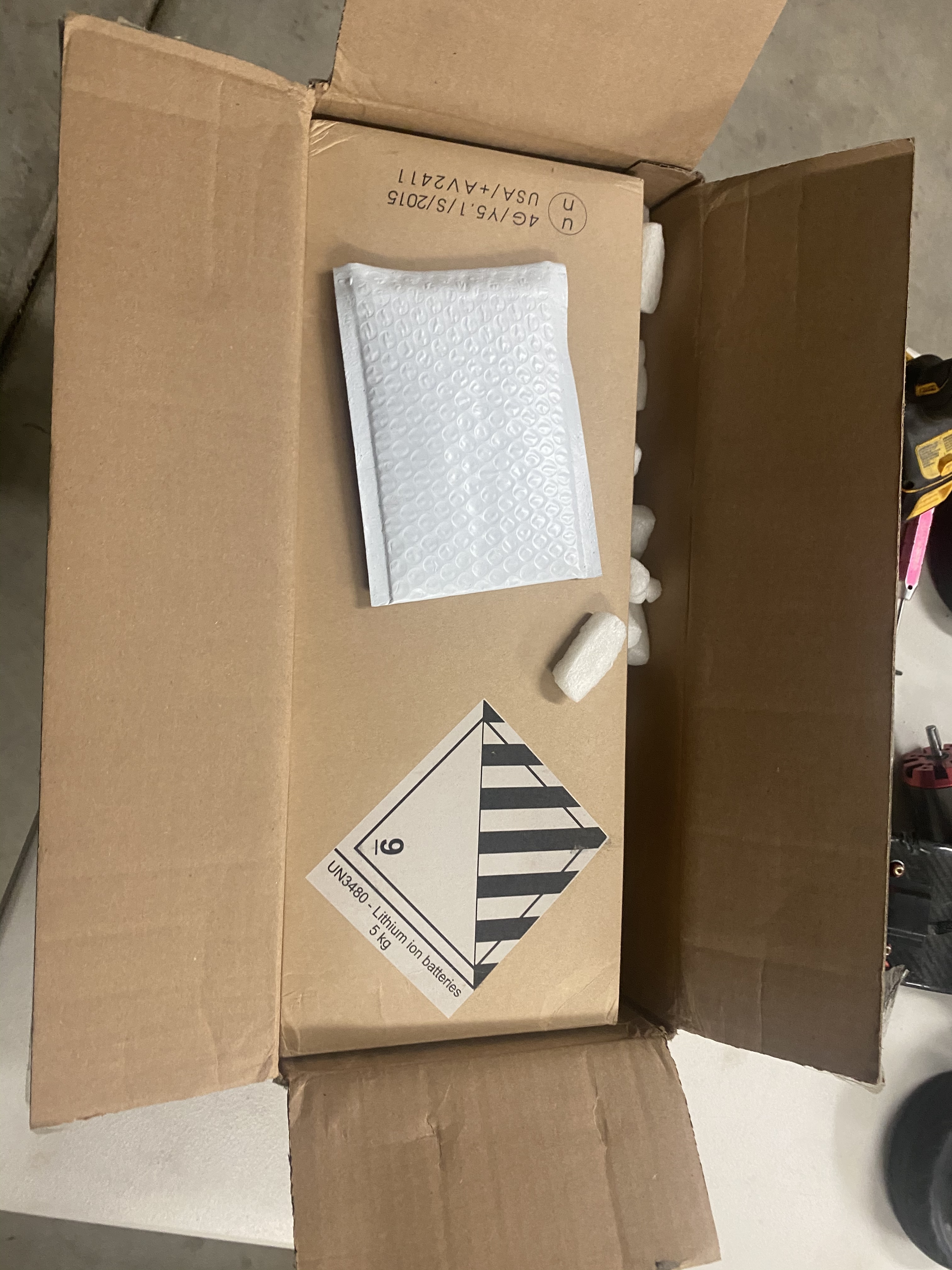

Mail callllll!
Another one.

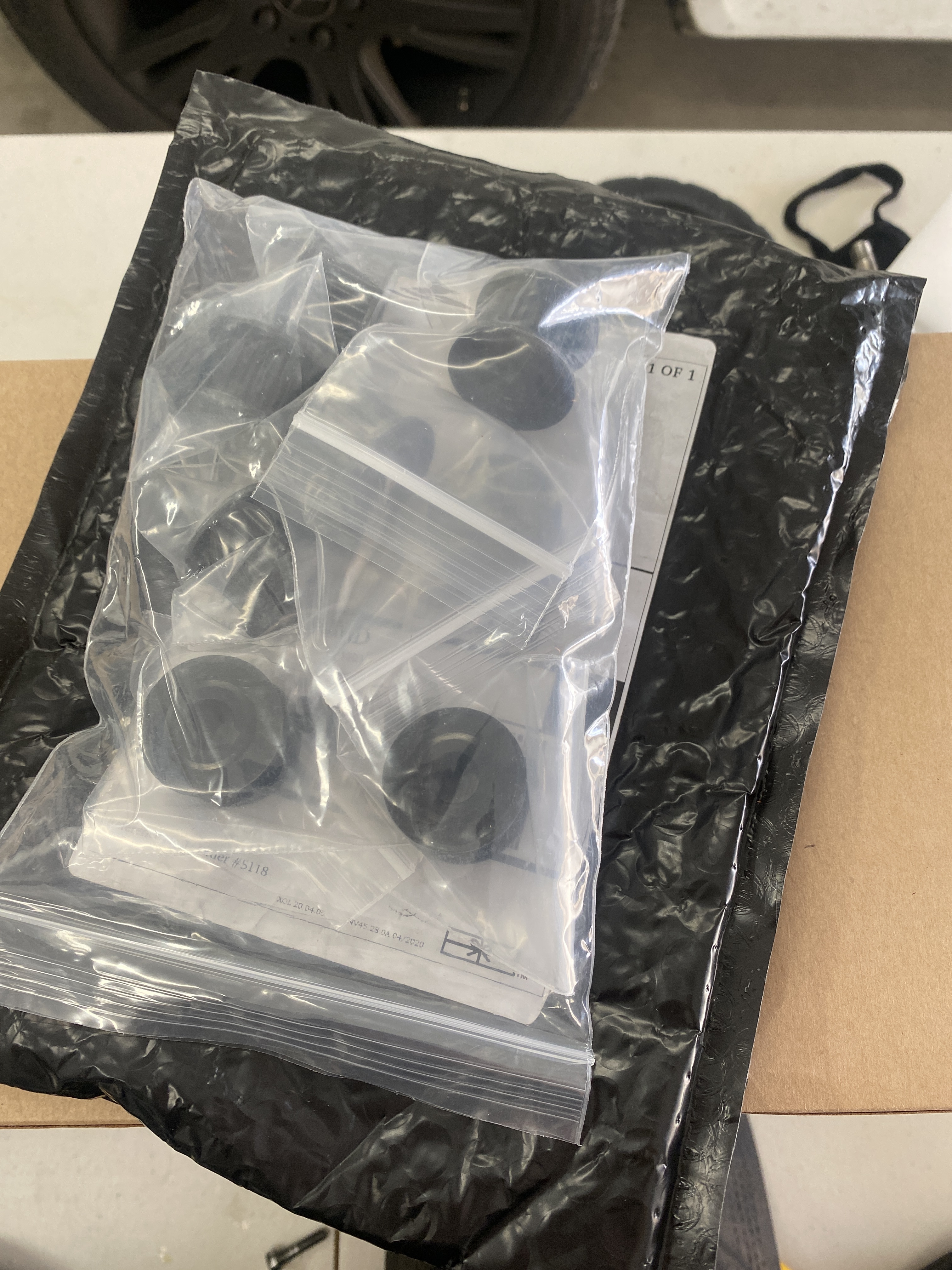

And pulleys from dumbdumb boards. That idiot, the same day I finally messaged him to say “cancel this, lacroix sent them already, I have them on hand” he shipped them out. Why?

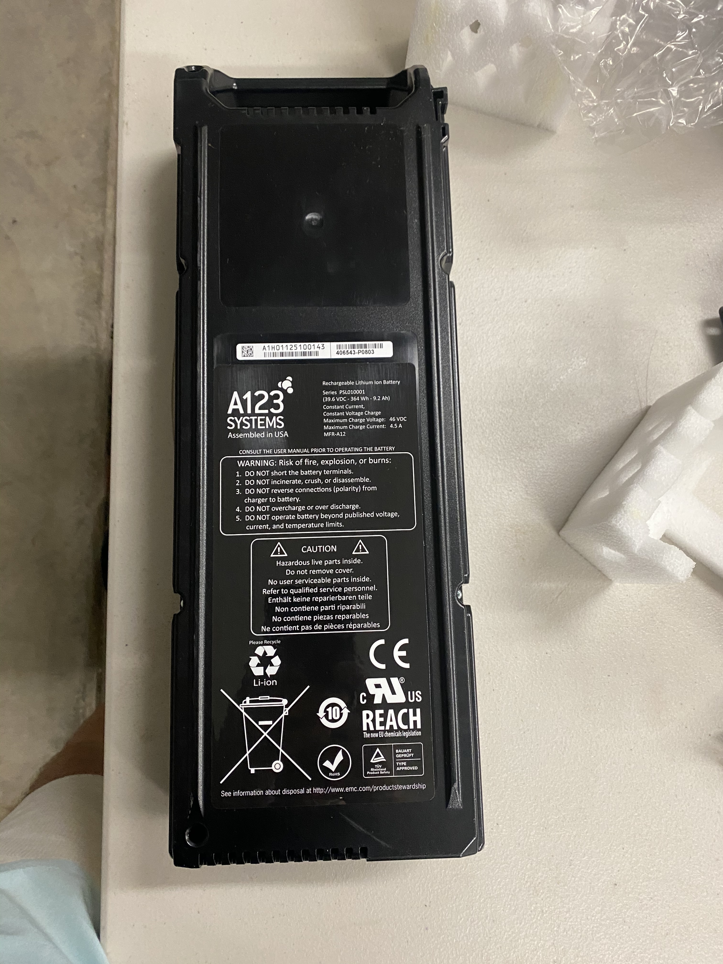

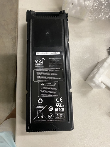

@sesat any progress on that a123 psu BMS?

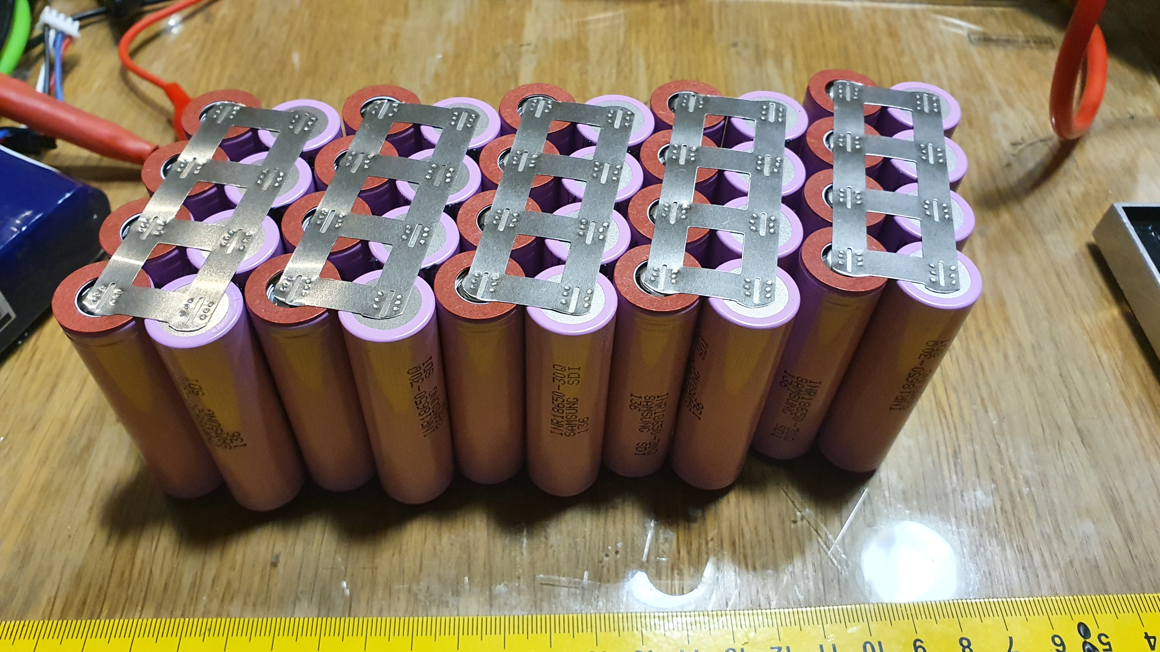

For my 12s8p, I have 66 cells that were the same voltage and 33 cells that were a little off (within ±0.2v). How should I arrange the P groups? Make 8 groups with the good cells and 4 groups with weird ones or spread them evenly among all 12 P groups? I already marked the good and suspicious cells with different color fishpaper insulators so later I can tell which are which.
have you run a discharge/capacity resistance check on the suspect cells?
do the suspect cells maintain voltage over a couple of days?

I don’t have any way to check for capacity but so far over the past 24 hours they haven’t changed at all. I’m probably gonna give them a week to check for self discharge.
Definitely evenly distribute the off cells

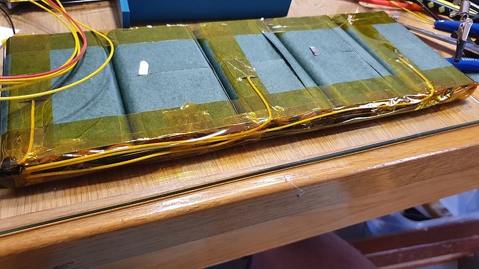

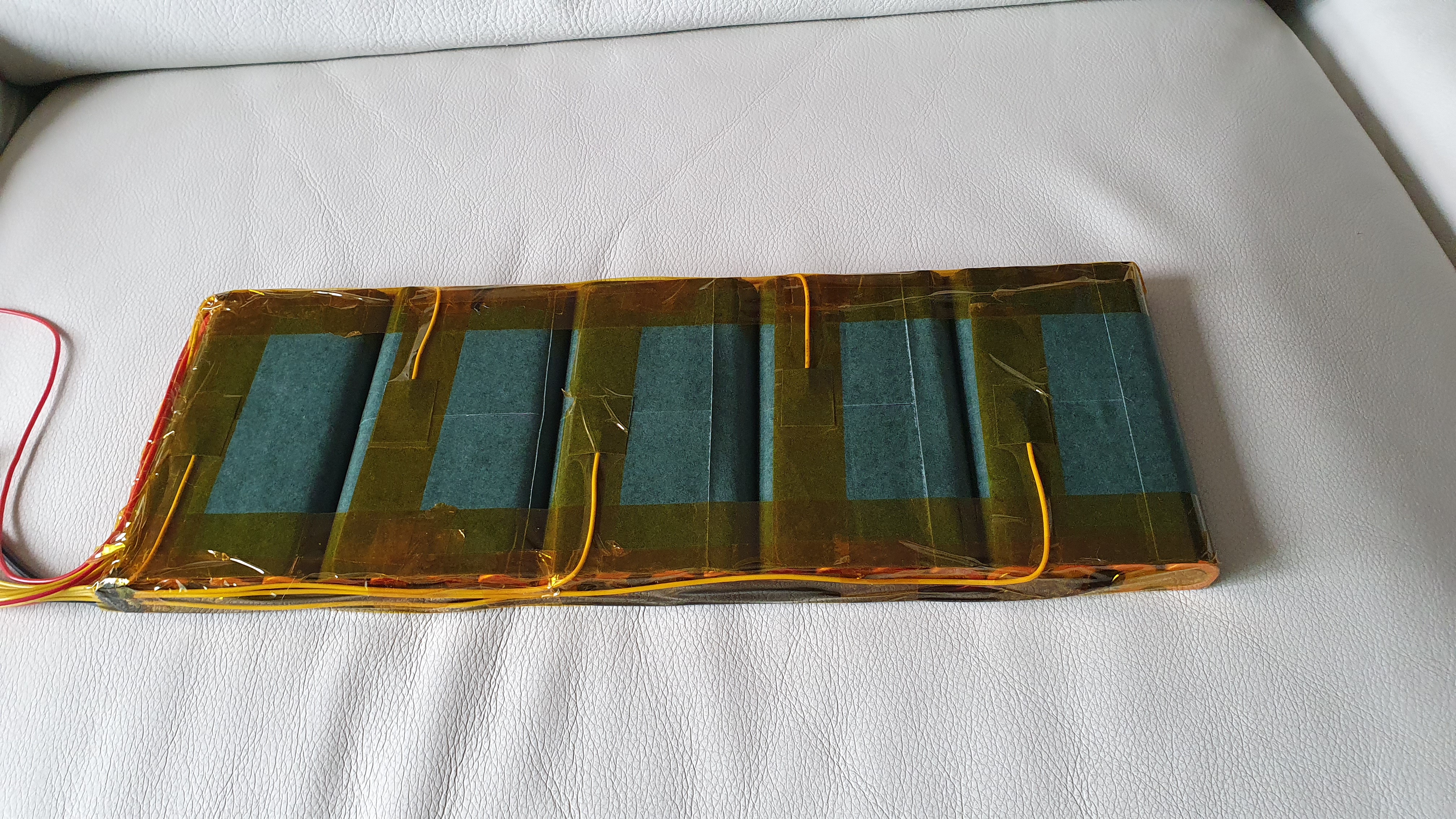

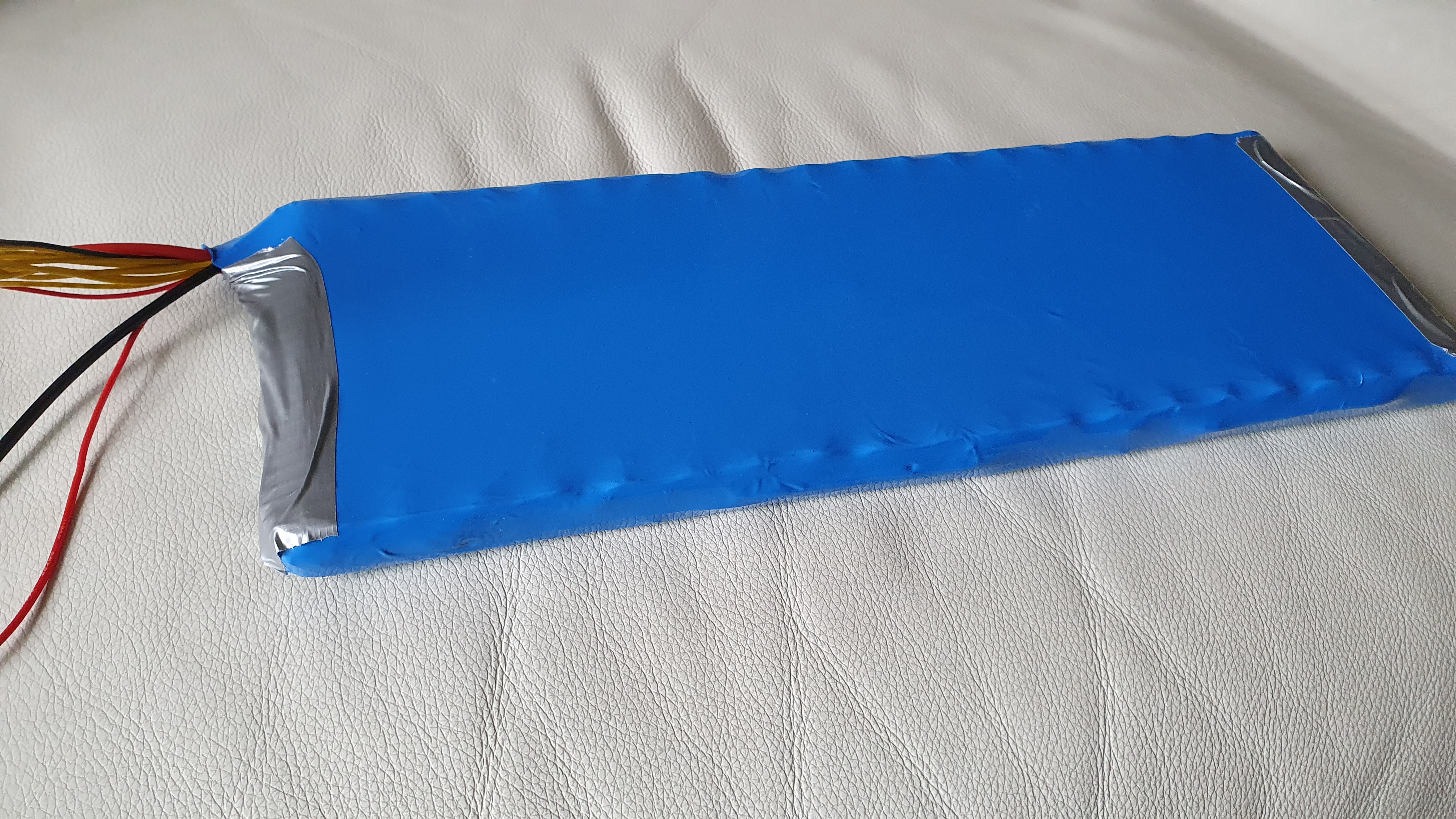

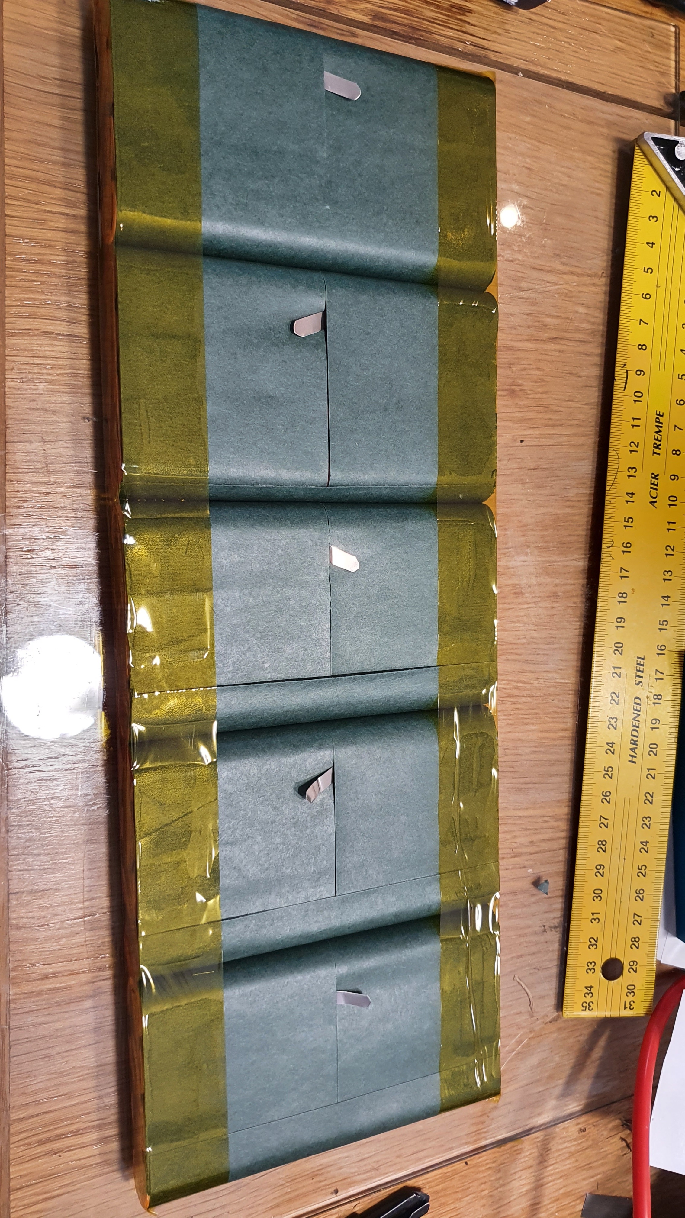

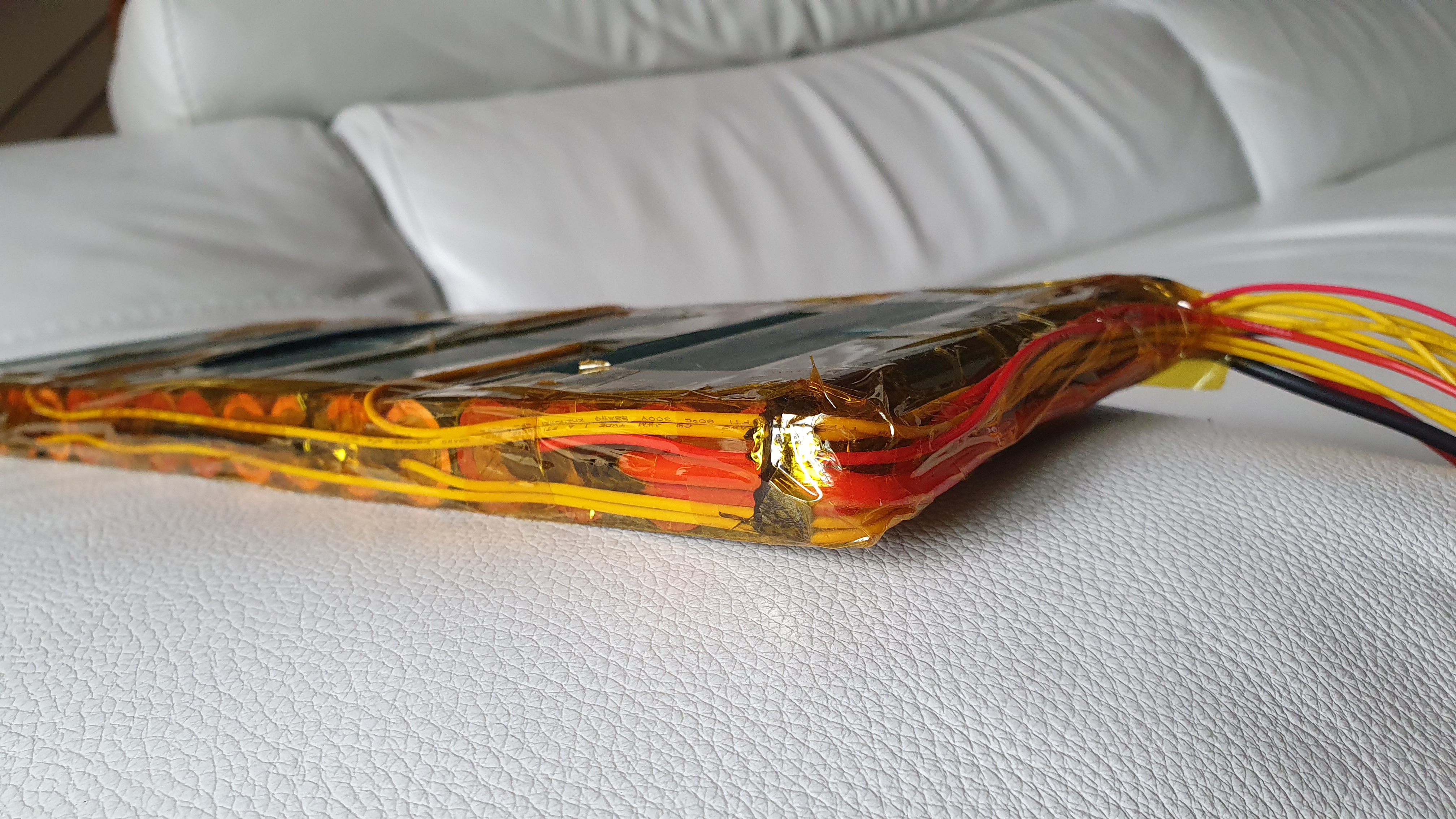

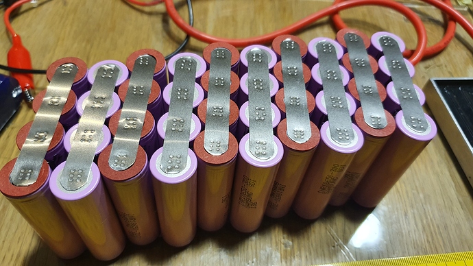

Evolve 30Q mod, LHB style:
Every piece of nickel or solder next to balance wires isolated with hot glue + kapton, my favourite combo :yum:
Kapton tape
no i suck i haven’t figured out how to get it to talk to me over uart or usb yet
:exploding_head: you have the packs wrapped in insulation but you run balance wires across bare terminals?
There is kapton between balance wires on sides and cells. I know kapton is not meant for insulation, but there won’t be any hard forces on sides of battery.
